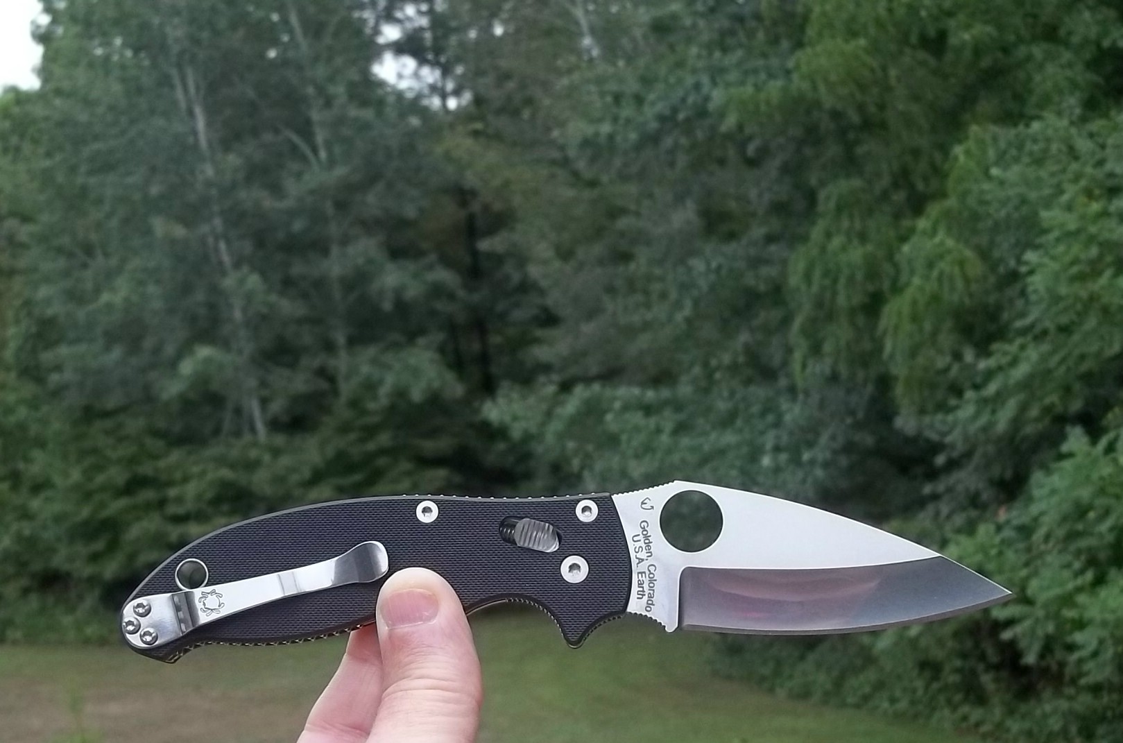

here's a pic of the Manix 2 I was suprised with Mitch,
1st impressions...I feel like Philco when he posted about his Native...
totally smitten with it. I think it will be a great addition to my EDC rotation
