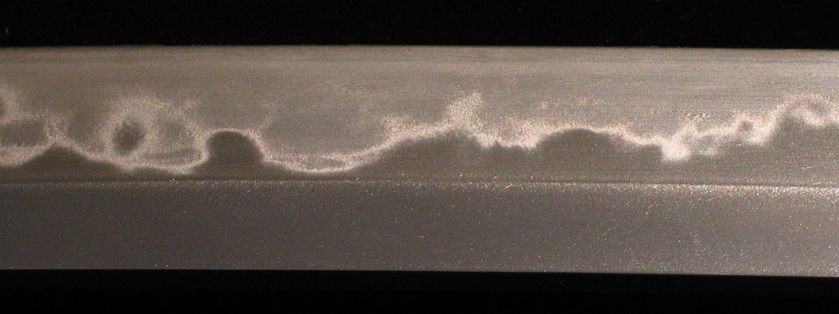

Bill always has some great resorces to reference to. I have some old Nicholson files that are 1095. Some older auto spring steels are quite good, 5160, I think, newer autos may be different. 52100 (usually bearing races) is another good one. All are just excellent high carbon steels. Charlie Davis, at ANZA knives I hear is quite good I hear but I have not seen his work. I'm going to have to look him up to look at his knives.
I will anneal the files before I do any work with them. Heat them to non-magnetic, then quickly put them in a container full of vermiculite (from most any nursery) and let it slowly cool overnight. WEAR a respirator for this! (NOT A DUST MASK!) Some vermiculite has been found near asbestos deposits and there is some vermiculite on the market that is cotaminated with asbestos. I got this info from another site and regard it as being VERY important!
The point is that you must know what steel you are working with for a proper heat treatment and if you are ordering a knife to made. I believe most of the steels above can be made with a distinctive hamon line that comes from differentially quenching. Clay may also be used. I like a hamon, they are only available on some high carbon steels made by custom knifemakers. It can be done on Damascus (pattern weld) and is done by some, but in most cases I think it detracts from the pattern in the steel.
I took a picture off the internet that had an easy to see hamon, some are quite faint but enhance the blade anyway.
Learning about the steels a knifemaker uses will help you decide which maker to use for your perfect hunting knife. One that will last the rest of your life and can be handed down for generations.
Differential heat treating is when the blade has soaked in the kiln or furnace in a non-magnetic state (each metal has a different recipe or temperature and amount of soak time) and then taken out and usually oil quencehed on what will be the cutting edge (blade about 1/2 way in the oil) (water can be used for some metals). At the point where the steel is around 1/2 the soak temperature the entire blade is put into the quenchant. The result after tempering is that the spine of the blade is around 48-50 Rc and the cutting edge could be 58-60 Rc or whatever the knifemaker was shootng for determined by tempering temperature. This is how a knifemaker can pass one of his Journeyman Knifesmith (JS) tests. This is the test where they bend a blade to 90 degrees without having it break.

- Hamon line from differentially heat treating. This looks like clay was used to create a hamon, not even, like it was in fluid only
- Hamon.jpg (91.89 KiB) Viewed 2349 times

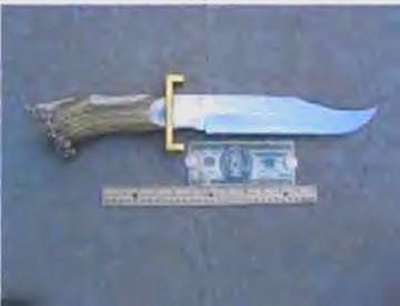

Hey....Hukk....
....what type of steel are files usually made of? This past winter, I threw a couple of old, worn out files into my wood burning stove in my shop and they stayed there all winter. When I cleaned the stove out this spring, I recovered them. They're now soft enough to be worked easily with another file or a bench grinder or belt sander. I've began to shape them, but the rehardening and tempering process is going to be a totally new experience for me that I'm kinda' looking forward to.....and will be my very first. I gave one of the blades a slight curve by putting it in the mitre gauge slot on my table saw and giving it a few whacks with a three pound hammer. Just enough to give it what I'd guess you'd call a semi-skinner shape. I always did love an adventure!
Dewman

Here are two of Charlie's pieces, one from a file, and one from a truck spring.
Hukk, here is a special page Charlie has up on the web...
http://www.msnusers.com/anzaknives/shoebox.msnw?Page=1
Here is his website...
http://www.anzaknives.com/
Thanks for sharing your experiences, and I hope dewman doesn't mind a small hijack...
Bill

Usually 1095, especially if they were Nicholson. If they were Chinese made, I wouldn't know what they were.dewman wrote:....what type of steel are files usually made of? This past winter, I threw a couple of old, worn out files into my wood burning stove in my shop and they stayed there all winter. When I cleaned the stove out this spring, I recovered them. They're now soft enough to be worked easily with another file or a bench grinder or belt sander. I've began to shape them, but the rehardening and tempering process is going to be a totally new experience for me that I'm kinda' looking forward to.....and will be my very first. I gave one of the blades a slight curve by putting it in the mitre gauge slot on my table saw and giving it a few whacks with a three pound hammer. Just enough to give it what I'd guess you'd call a semi-skinner shape. I always did love an adventure!
Dewman
There are companies that do heat trearting, tempering and cryotempering for fairly decent prices. 1095 is a good steel to use an anti scaling compound available at Brownells as well as many others. Scale is tough on files, belts, you name it. As quenched, 1095 can be as high as 66 Rc, very brittle and tempering needs to be done to bring it down to 58 or 59 Rc. I think somewhere around 550 F will get 59 Rc, 600 would be about 58 Rc, but you need to get a recipe for that steel and use the correct temperatures and times. Some triple temper this steel and cryo temper before the last heat temper. Cryo will add .5 to 1 Rc and make the blade tougher. If that is the case, I would temper for 58 Rc. Good Luck!
0-1 is great to train on heat treating, if it gets screwed up you can redo it. You can't do that with 1095. With 1095, you'd probably have to anneal them and start over. 0-1, you can just redo the heat treat.
Old files have been used to make some really great knives.
That blade looks good. In the wood stove you actually annealed them. They heated up, and cooled slowly in wood ash, which is also used to anneal metal (cover heated steel into a container of wood ash). The slow cooling is the key and in a wood stove that retains heat, I imagine they cooled off right fine!
