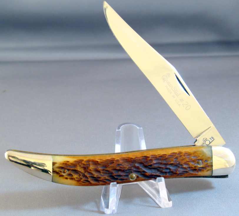

I recently pikced up a Rogers bone Queen toothpick with a Q76 tang stamp on it from a fellow AAPK member. Thanks Paladin! ::tu::
We both didnt know the steel used in the blade at the time, I know current runs are typically D2, but in 1976 I've read they've used stainless steel. I'm posting a picture, in hope someone might be able to tell me via the tang stamp or view wha they were using. It doesnt have the heft to D2 to me, so I was thinking 440 or 420 steel? ::shrug::
Here's the knife (picture robbed from Paladin):
Queen toothpick.jpg (34.8 KiB) Viewed 3937 times
Thanks as always for any insight ya'll might have.

Queen did not use D2 at all prior to 2002 wen the D2 lines were introduced. I believe that every Queen knife in D2 has a special tang stamp that includes "PH-D2" indicating D2 steel heat treated by Peters Heat Treat. If it does not have those letters then its not D2.
In the years up to and including 1976 as far as I know Queen's standard blade steel was 440C. I have in my archives a 1976 factory letter to that affect.
Starting in about 1979 or a bit later they switched to 440A and then later maybe late 90's to 420.
As far as I know starting in 2002 to the present day if it does not have the D2 stamp and its not one of the F&W series in ATS-34 than it is 420.

My gosh, that was amazing. Thank you so much for the info. I'm excited to see it being 440 most likely, as I have had good luck sharpening it. Not sure I can turn this inot a user though. Too pretty. It'd be my first safe queen! :shock:
