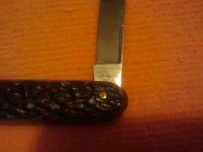

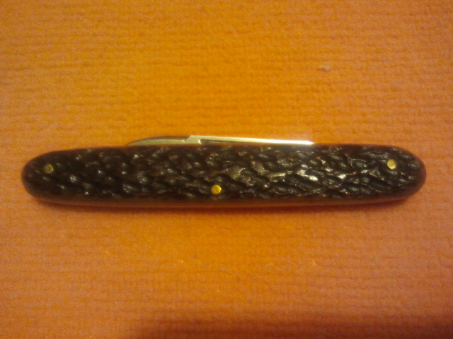

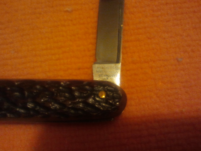

of course, everyone is familiar with JA Henkels and I'm 99.9% positive this henkels has no correlation to that name ...and I'm thinking that hammesfahr has been associated with quality razors in the past............hoping someone might have some info concerning this knife. Is it common?? Older or newer company??? Sorry about the poor quality of photo's...the tang has Henkels & Hammesfahr... GERMANY. Thanks for any feedback!

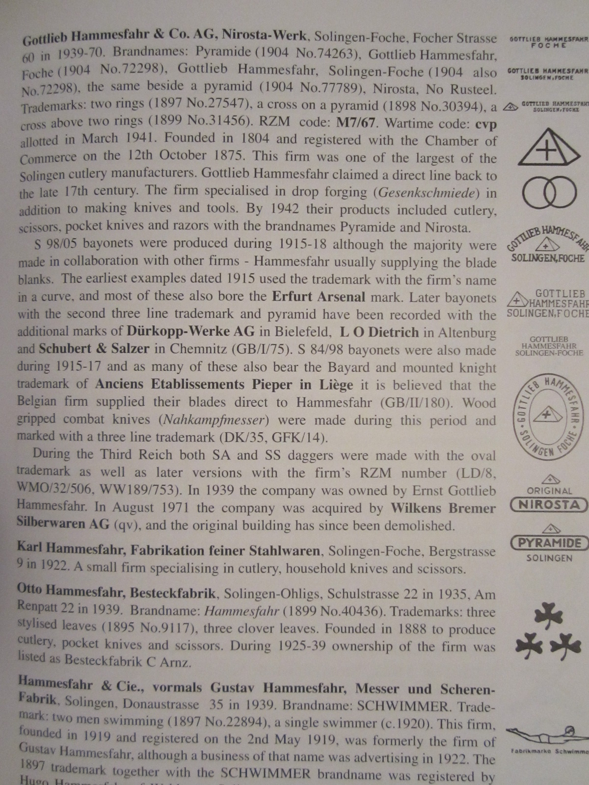

From Anthony Carters Book" The Sword and Knife makers of Germany"
Henckels & Hammesfahr....Solingen-Hohscheid, Founded in 1933, Registered 1939-1986
Specialized in cutlery, scissors, tweezers and manicure sets.

Here's a little reading for ya fellas...........
