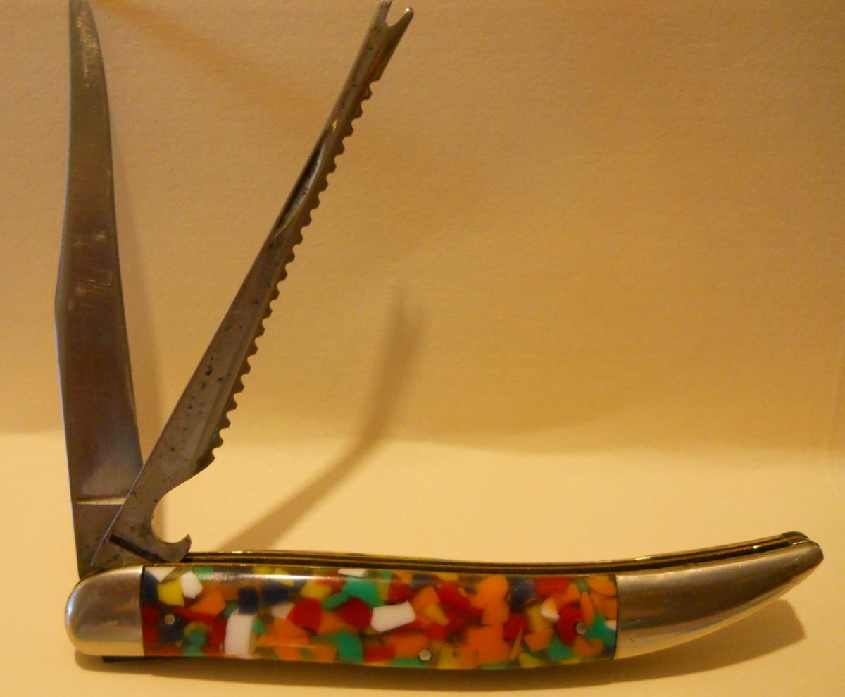

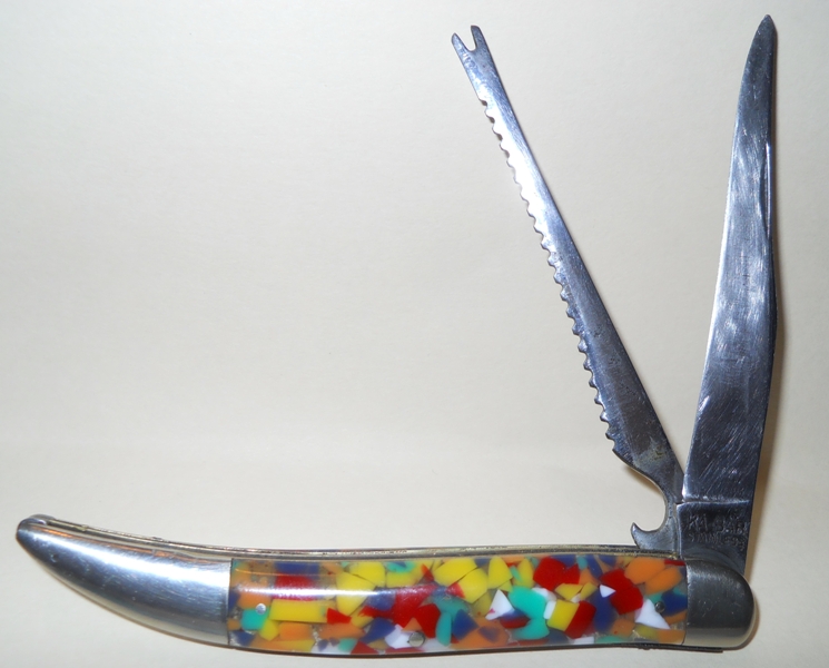

I really enjoy coming here and looking at the work of others, so I guess it's only fair I post some of my own. My work isn't up to the standards of the experts on here, but I'm learning. Here is an old Ka-Bar fish knife I got on Ebay for a few dollars w/o any scales at all on it. One thing about repairing knives is that your experience gets expensive. If you crack a set of bone or stag scales $20 - $30 is down the drain. The scales on this knife are from a pen blank. They are $1.95 each and if you're careful you can get 2 sets from one. This pattern is called confettit. The other thing I'll post is the Trim nail file boards. These come in different grits and they are about 2 for $1 at Wal- Mart. The scales on this knife were a square block when I started and I sized them on the belt sander then all of the finish profiling was done with these boards. They are great and contour to your forefinger making it easy to shape things.

Nice work !

I agree, using common materials for scales is good to practice on when your starting out. It's no fun ruining a nice (expensive) bone scale. I'm thinking the fish will go for those purtty scales too!

That confetti is cool!

You did a fine job on that old fish knife. The pen blanks was a clever idea. I love it when folks innovate.

Nice work Bob and great creativity using a pen blank!
