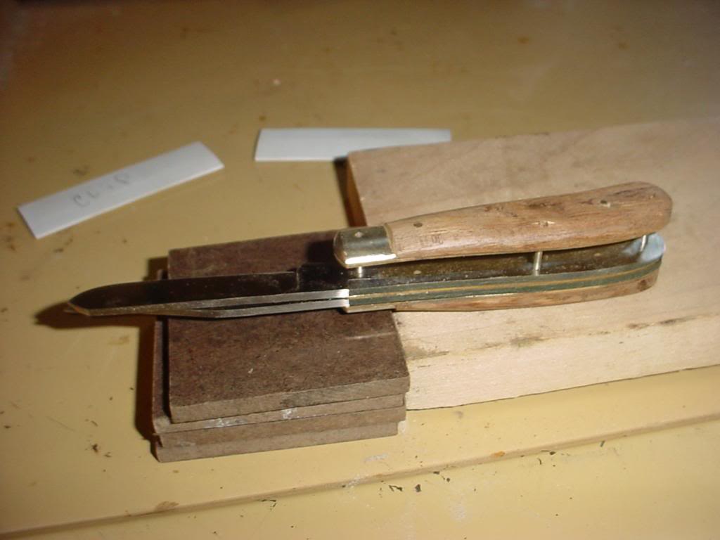

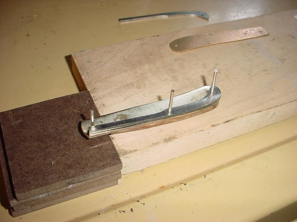

You could use a flat piece of wood as a jigg something like the pictures shown below.
Place the scales / liners on the board and drill holes through the liner holes half way through the wood.
Place the right size diameter pins through the holes and make sure they are tight in the holes.
You could use this to get a new back spring and blade adjusted to your liking.
I've used this method before and it works well.
You can open and close the knife before you put it together for proper operation.
Hope this helps~
JW
