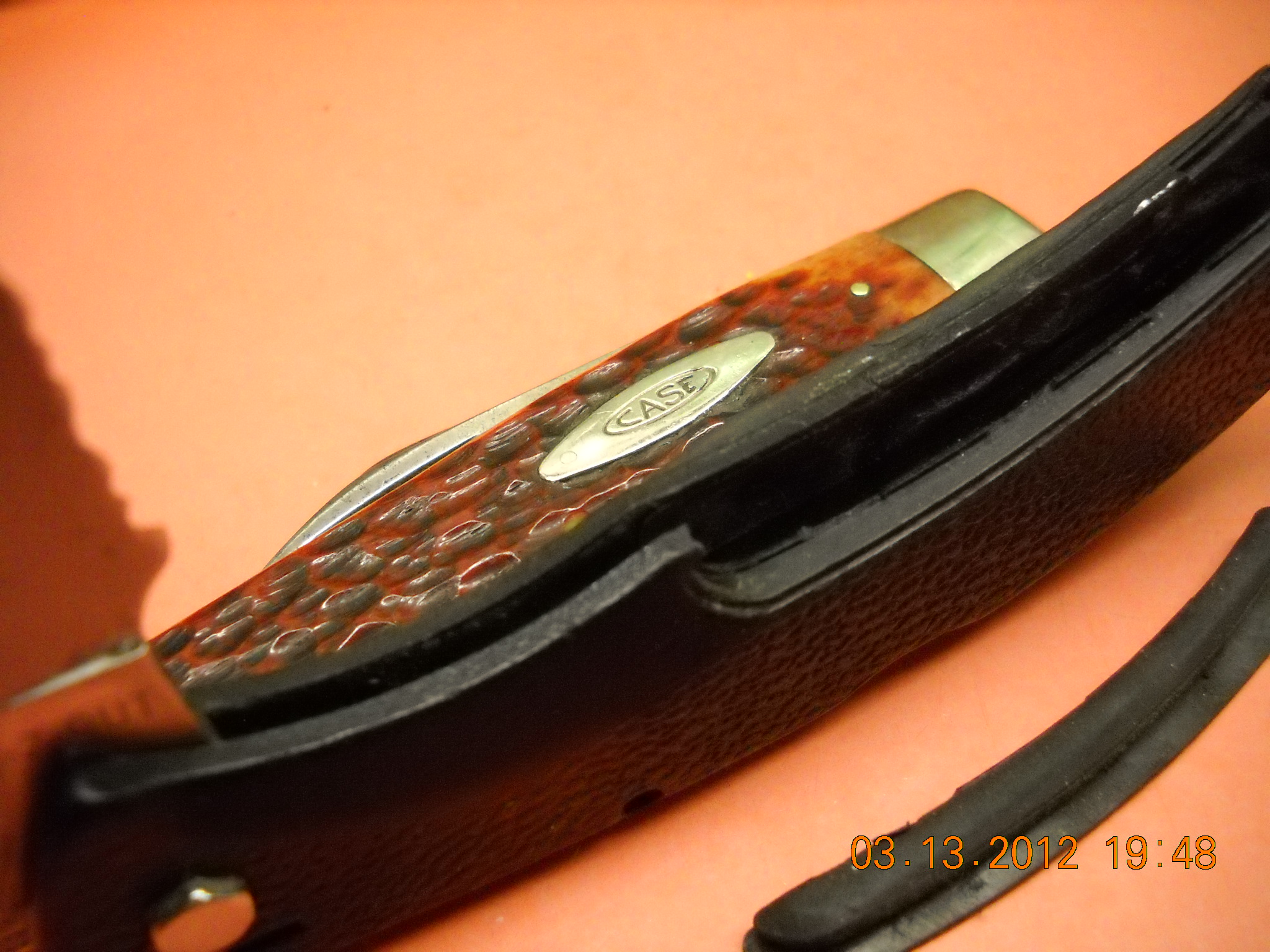

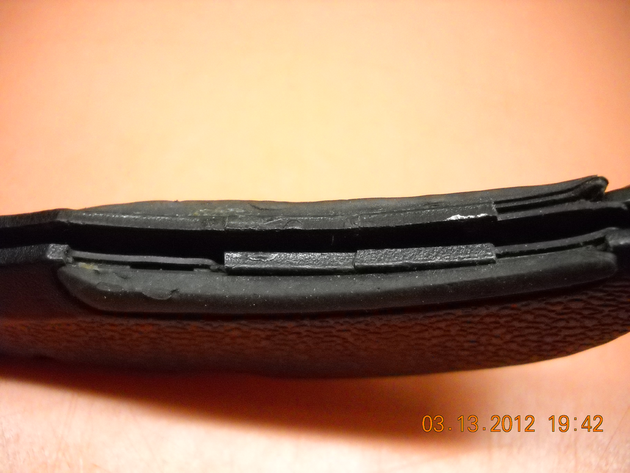

can you post a picture of the broken area that you are talking about ?
treefarmer
Posts: 15159
Re: Zytel handle/frame repair
Post by treefarmer »
Big Barn, Here's a couple of pictures of the broken areas. I'm going to try to build up the areas on each side where the rubber inserts have broken loose and discard the rubber pieces. As knife7knut suggested, there is enough material to drill a series of small holes to allow the JBWeld to make a tight bond to the zytel. May work and it may not. Treefarmer

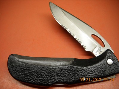

Here's a picture of my attempt to repair my Gerber EZ OUT's handles. Found that JB Weld will not adhere to rubber, so I put a piece of an old innertube on each inside surface of the zytel frame and closed the blade. This created a form for the JB Weld to bond with the zytel and keep it in the original position of the broken/cracked rubber inserts and keep it off the blade. Did one side at a time, after it cured I removed the rubber strips and then shaped it to match the contour of the handle. So far so good, at least it will be comfortable in the hand when I decide to use it. Treefarmer
