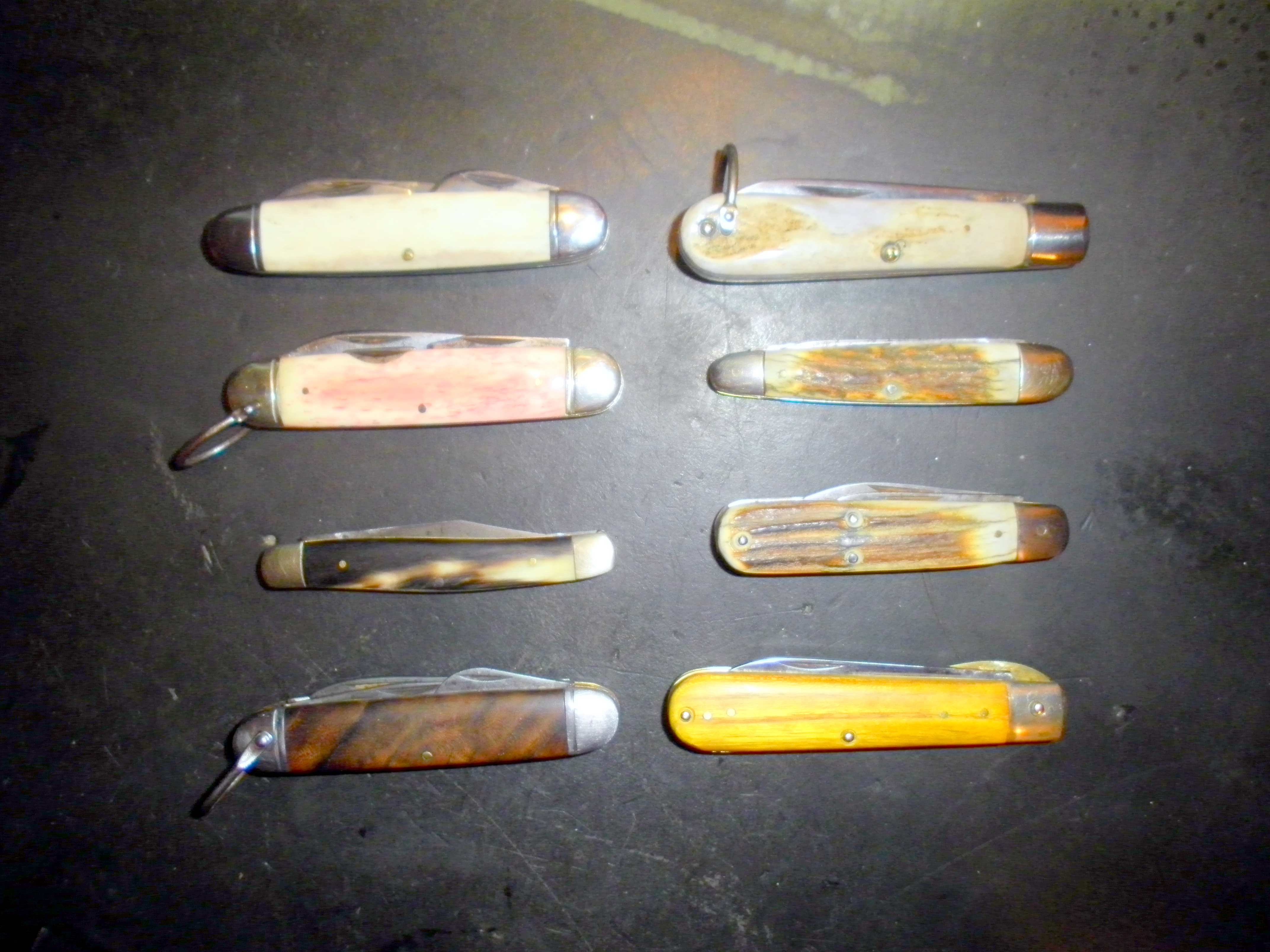

I imagine everyone goes through this but since I have re-handled two knives, I see almost everything as potential handle material. There's my yellow plastic waste basket - not too soft, not too brittle. As I was walking on a Florida trail this morning, I found a deer that had come apart some time ago. I collected some of the bones to see if they could be a candidate for scale material. The shoreline of a small lake yielded three turtle shells, they are about 8" x 15". I've added some pictures and it looks like I might have better luck on smaller knives with the materials I have collected. I would be interested in finding out what some of you have found to use as handle material. We can all buy fosilized mammouth parts (and they make beautiful handles) but I get more pleasure from scrounging around and using what I can find. Lets hear about what some of you have come up with (pictures of finished projects would be a bonus). Thanks, Al

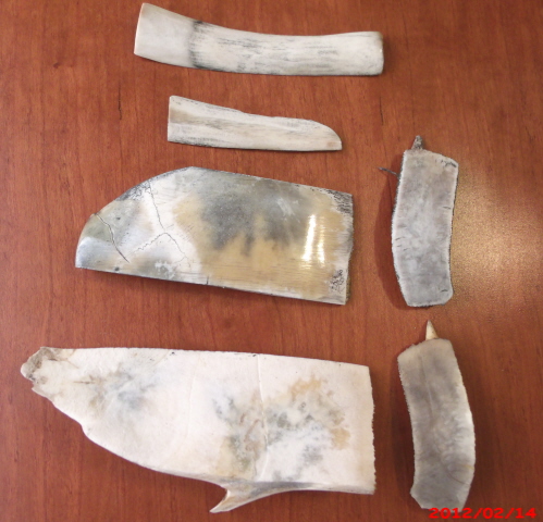

Here's a few i've used, top left 2 are from front shin bones of local cattle, 3rd one down is horn from local cattle but different herd. Bottom left is burl from an old walnut tree out back. Top right is from a whitetail shed I found in the woods, middle 2 are from an Elk ranch a couple of counties over. And the bottom right is Missouri Yellawood from down by the creek.

Deer bone, yes it will work I've used a lot of it, the hip bones make the best handles for me, they offer the widest slabs.

Here's a TL-29 in Hickory bark

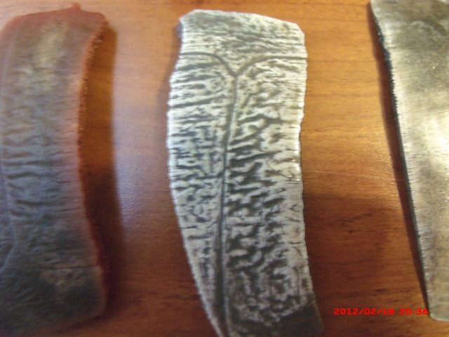

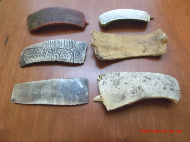

This is an update for those who may be interested in making poctet knife handles out of turtle shell. The top half of the turtle shell comes apart in sections like I have pictured. The problem is that the sections are small and curved (arched). By the time they are sanded flat, they are too small to use.
I have tried boiling the sections then clamping them flat. I had the most success by putting a section between two pieces of wood then clamping it down hard in a vice. I left it there overnight. The smallest sections are 7/8" x 2 5/8" and the largest are 1 1/2" x 3 3/8".
The first picture shows (6) sections (from left to right)
a. boiled, clamped, sanded and buffed
b. boiled, clamped and buffed
c. boiled only (in pickled beet juice)
d. sanded and buffed only
e. untreated inside of section
f. untreated outside of section
The last picture shows a side view so you can see the effects of boiling and clamping.
The bottom half of the turtle shell has somewhat larger and thicker sections that look more like bone. Al
