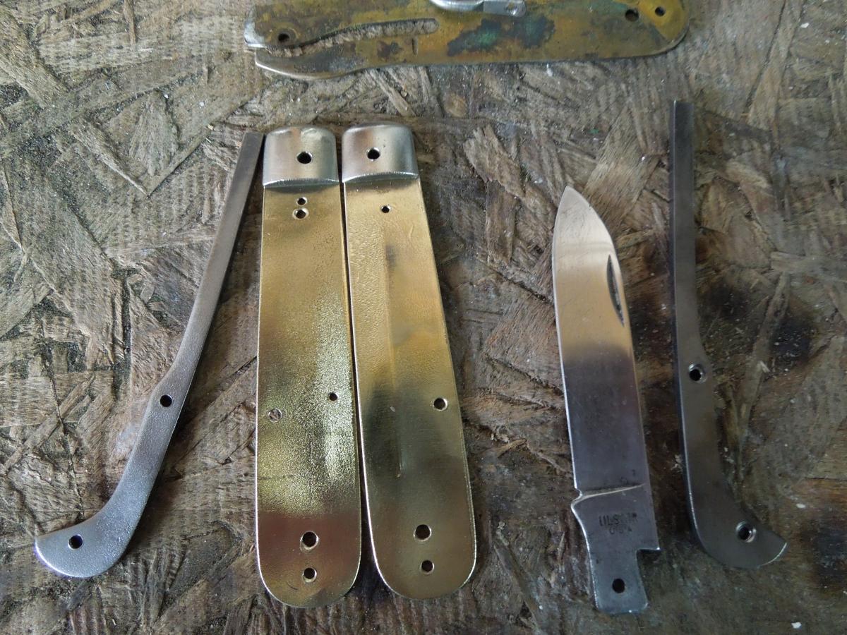

Busted down this Ulster TL-29 the other morning and gonna try rehandling it don't have a clue what I'll use on it yet guess it'll be something kinda cheap for the first try but figured I'd get a couple pic's of it as I go with the new camera.
This thing looked like it had been in a fire when I started handles melted and charged-think I'll try and do a little file work on the spring and see how I'll do seein how I'll have a backup if I screw it up.

Ya' got a real nice blank canvas and it will look better than you think it will.

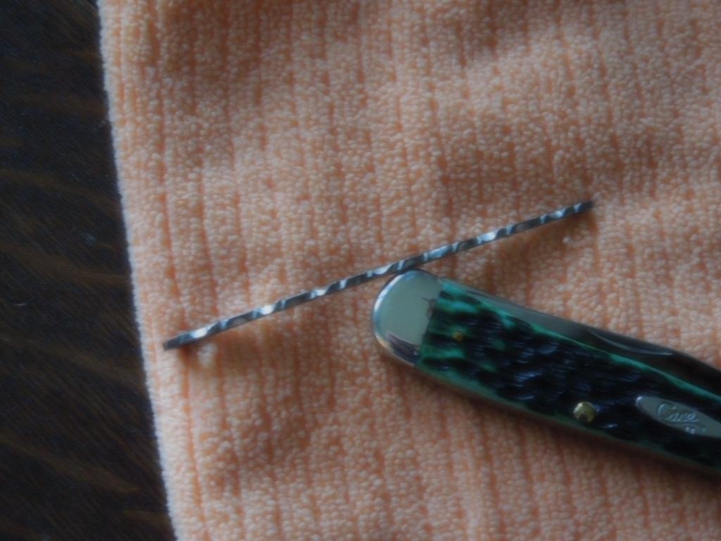

I seen those TL's you did Glen they looked great--Here's a crappy pic of that Camilus spring--I'm gonna get some new files and give it another try-my biggest problem was the vice I had it clamped in and poor lighting next try I'll clamp it in my big vice and have some fresh files and better light on that end of my bench

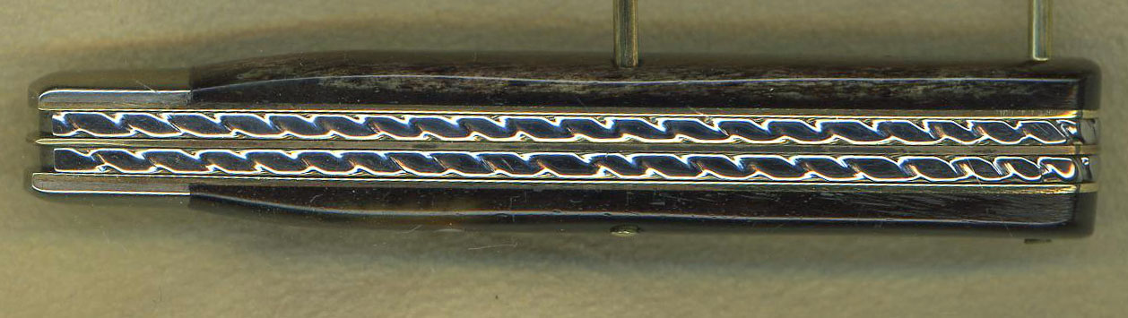

I buy Grobet files, (Swiss made). I would rather use the cheaper and readily available US made Nichols files, but they are too soft. I am lucky to be able to file 3 individual backsprings with a $5-$6 Nichols file. I have a $16 Grobet that has flied 25+ backsprings and is still good and sharp.
I figure that figures out cost wise to be about $2 per backspring with Nichols files and about $0.65 to use the Grobet files. Besides being cheaper they cut cleaner and more accurately with fewer slips, which means a lot less work to shine up the filework when I am finished.
A good hand vise like this one, clamped in a bench vise makes it much easier to do the filework without hitting the vise with the file:
http://www.usaknifemaker.com/index.php? ... ts_id=2208
Good lighting is a MUST for me as well as magnifying glasses.
All these things make it much easier, faster and the quality of my work is much better.
Here is a work-in-progress of rope filework. Notice there are not a lot of scratches in the file cuts.
I don't get that with cheaper files. Of course the the backsprings are buffed after filing, but buffing won't remove scratches left by a file.

Oh man I knew that spring looked bad yours looks real nice Dale--Tell you what I don't think I've ever bought a new file just grab a box of garage sale junk and bring home--I'll get this back together and keep it simple for now I still gotta get handle material ordered.
