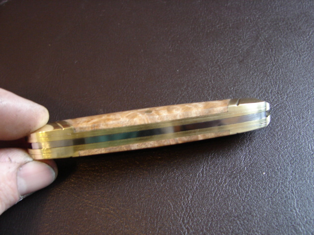

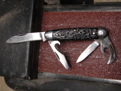

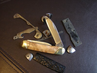

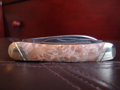

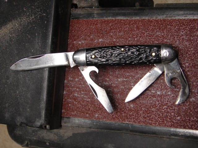

I've been staring at this old hulk for days wondering what I could do with it. I had no nickel to replace the bolsters with, but I found a big fuse at work that had a giant brass washer on it... ::hmm:: ....... ::idea::
I'm not sure exactly what the parent knife is called and I sure don't know what you'd call the end result. It was a lot of work to make if function properly, and I don't think I like working brass or wood, but I learned a lot from this one.
This stuff could get habit forming! :D

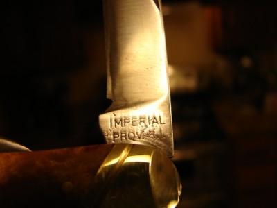

Anybody know exactly what it started as? All I know for sure is it was an Imperial. Date???
Thanks for looking, Shannon
Soldered spacer for thinner blade

Judging solely from the nail pull, I would say it's a '36 - '52 stamp with the abbreviated "Prov." R.I. stamp. (no U.S.A.)
The blade configuration would make it an engineers knife.
I'm sure Miller Bro` will be along soon to correct me. ::paranoid::
Again, NICE knife! ::nod::

You nailed the stamp Joe. I'll just have to take your word for it on the rest. Glad yall like it.
BTW, the scales are Cherry burl.

Hey, You forgot a couple pieces!
jk, Great job! ::tu::

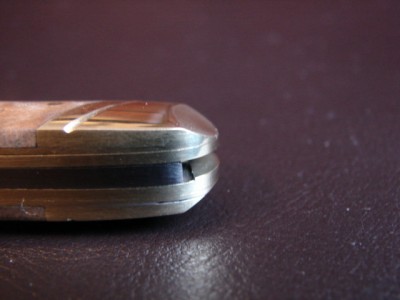

holey moses, thats nice ::mdm:: how did you pinch the bolsters? dang thing looks like it just walked out of GEC. Very swell work you did there ::tu::

Well done. Love the bolster treatment. ::tu:: ::tu::

Muskrat man, I don't even know for sure what "pinched" is :oops: I cut the lines in with a handsaw file. The flat spots on the ends are from carefully sticking it to a belt sander. You fellers will have to look over me because I really don't know poop from apple butter when it comes to knives.

the lines are often referred to as "threading" (no idea why) and the dimples at the ends are referred to as "pinched" it looks super ::ds::

Slanted, threaded AND pinched bolsters!? Buddy, you know more about knives then you're giving yourself credit for! That is awesome work! What a future you have as a knife mechanic, don't stop. ::tu::
