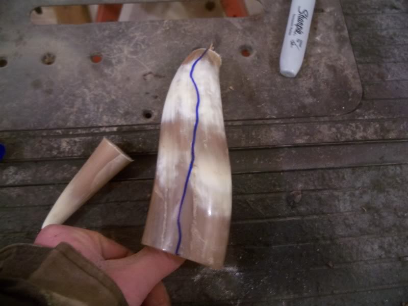

We start off with an ordinary cow horn

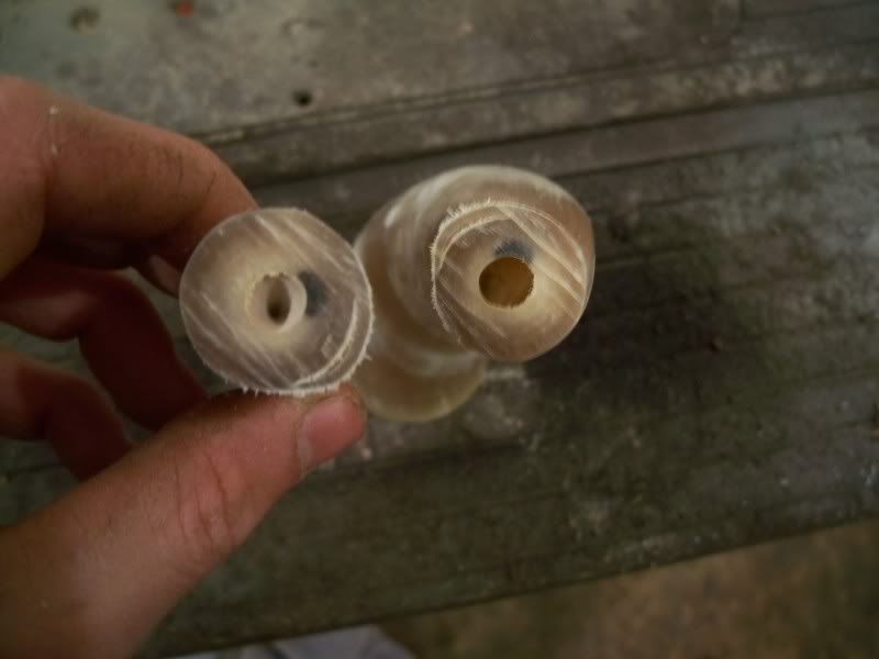

Mark it where it the tip starts getting solid
and cut it off

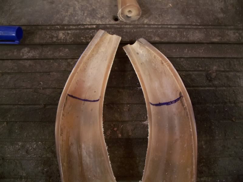

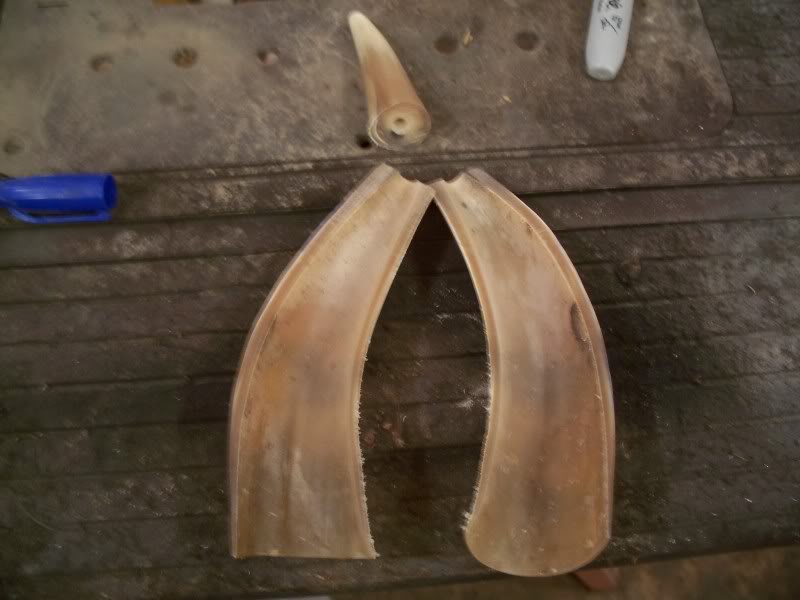

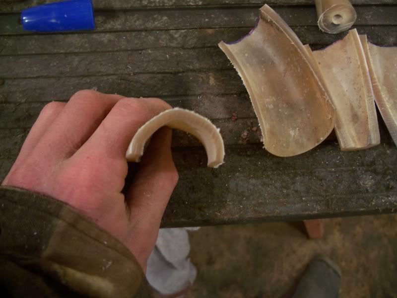

Now I make a rough mark and slice the horn in two. Always keep the cut parallel to the curve of the horn so if the horn is twisted you need to follow the curve of the horn, don't just make a straight cut or you'll lose material
Here it is sliced right down the middle

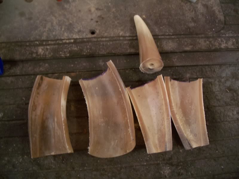

At about the halfway point is where the thickness begins to noticeably change, I'll get one thick set and one thinner set out of this relatively small horn plus I'll have the tip for another project.
Here is everything
decent thickness once you get in off the very edge

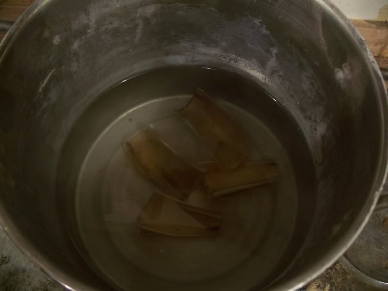

Chuck them all in boiling water, it doesn't stink too bad so you can do it inside if the wife will be gone for the day. I don't have that problem so I just boil them right in the kitchen. You could do it outside or in an outbuilding on a propane stove, turkey burner, ect. The hotplates I tried don't get hot enough to actually boil the water, the horn simmered for 5 hrs and was still too hard to clamp.
On a good rolling boil for around an hour for the thinner pieces, 1.5-2 hr for the thicker pieces ( 3/16" thick) to get them soft enough to clamp flat.

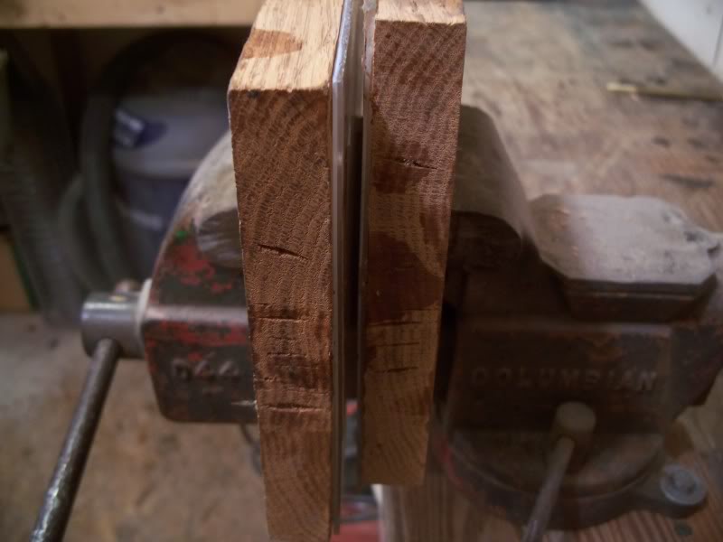

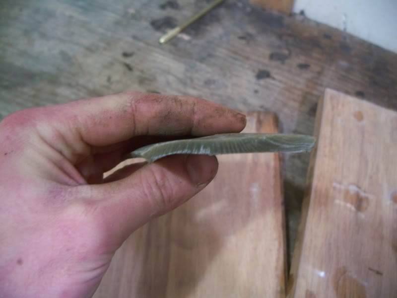

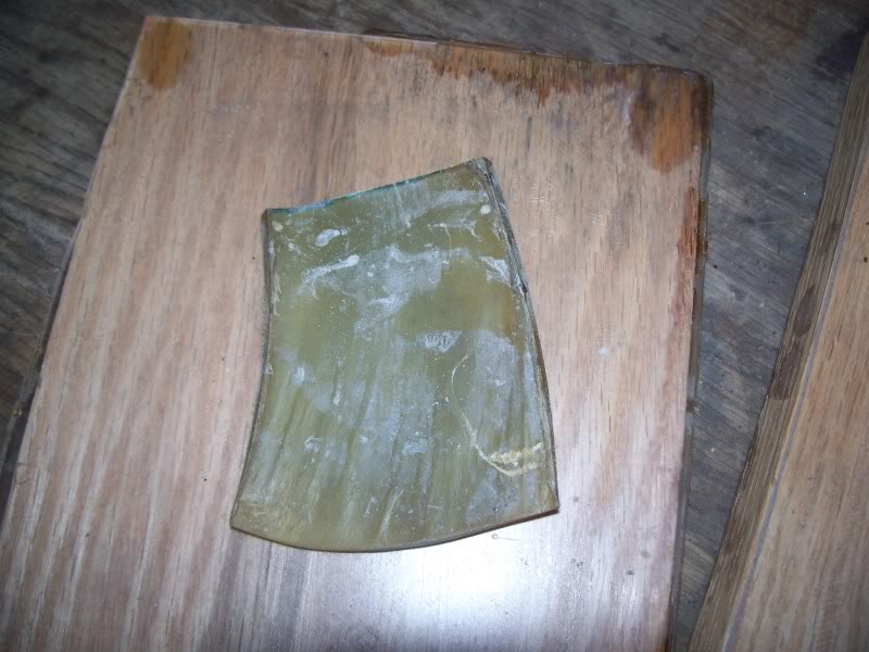

You can clamp them many ways but the best way I found by far was to use two flat pieces of wood (or metal, micarta ect as long as they're flat) and sandwich the horn between them and clamp them in a vice. This gives you the leverage and power you need to make the pieces good and flat.
You should leave them clamped for a few hours to ensure they are fully dry and cool so they do not return to their previous curved state after removing them from the clamps.Nevertheless they will still need surface sanding to make them flat enough to install on a pocket knife.

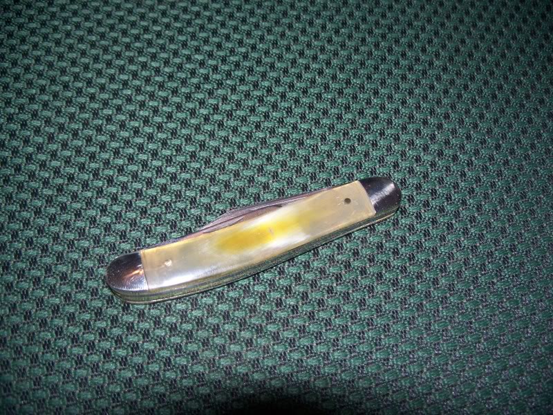

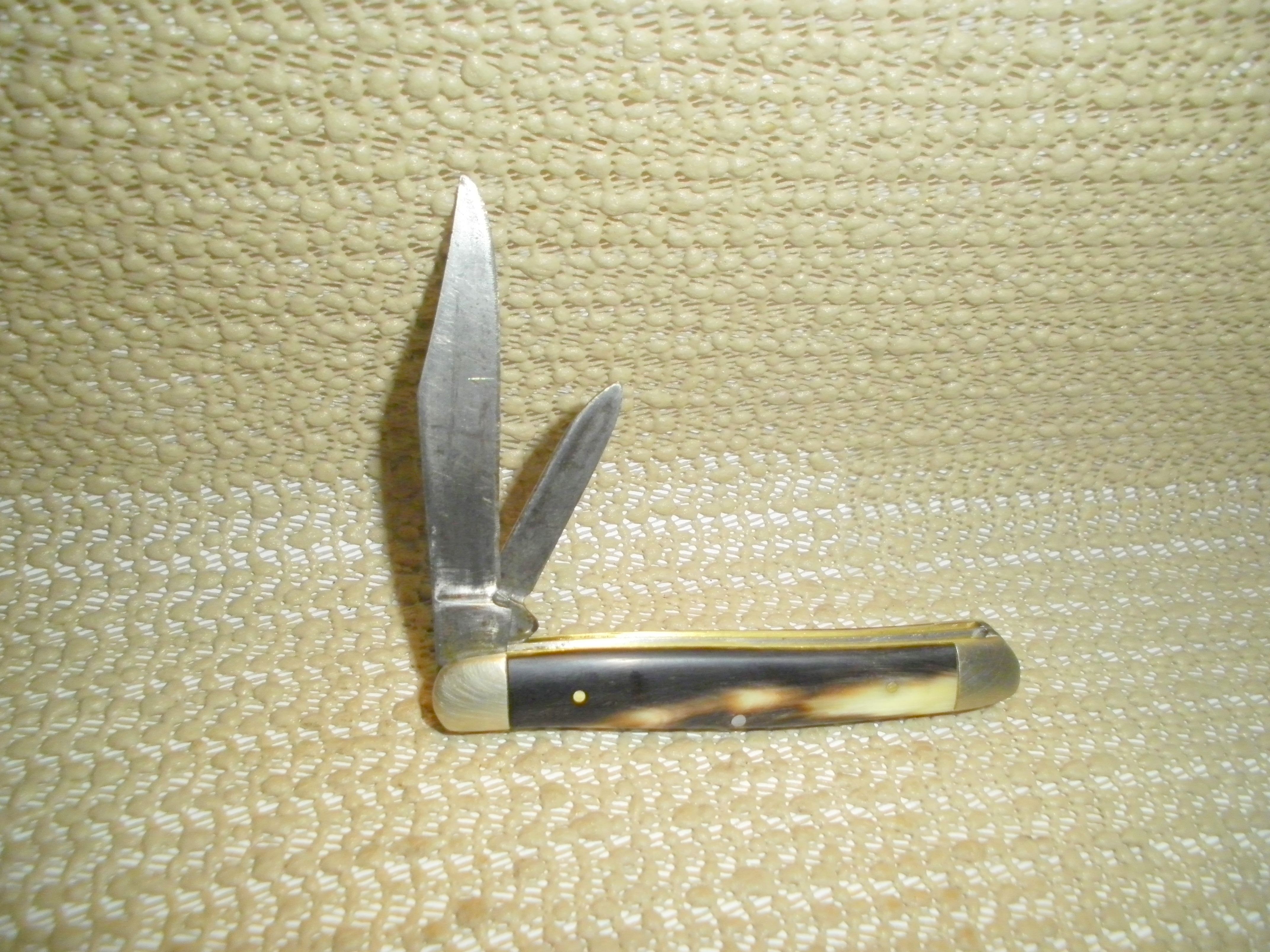

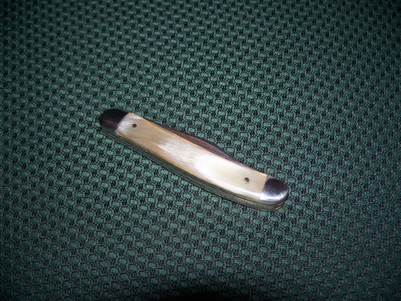

Just noticed my "day or two" was up so I cobbled together this Boker whittler real quick with the horn, once it gets thin it is translucent so it would be a good idea to give the backside a shot of white spray paint before gluing it up. That way you can't see to the liner once it's polished. Darker horn would not have this problem.

Here's an old Kutmaster I did after reading the tutorial. It was a big help! Thanks again, Kaleb!
I kinda messed up, the colorful slab was supposed to end up on front! ::dang::
