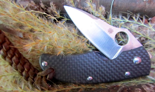

i think ZDP is worth the extra effort in sharpening . my favorite ecd walker / spyderco lightweight and always sharp

Beautiful knife, Paul!paulsvintage wrote:i think ZDP is worth the extra effort in sharpening . my favorite ecd walker / spyderco lightweight and always sharp
I have a number of VG-10 Spydercos, and it is one of my favorite steels for general purpose / EDC carry. Takes a nice edge, holds it well, and has good corrosion resistance.
I do own a Caly 3 in ZDP-189 (actually, it is a laminate steel, with ZDP-189 sandwiched between two layers of 420J), and it is a razor. As stated here, it holds its edge ridiculously long, but is work to sharpen ... I do touch ups on my Sharpmaker weekly to keep it "close", and plan to send it to Spyderco for a sharpening on its birthday. Regarding corrosion, only thing I've read is that it can discolor to a bronze-ish tone if exposed to certain food acids, etc. I've seen pictures of it, and it isn't even the depth of a traditonal patina, more like a slight discoloration. Mine hasn't done that yet, and I've been carrying it off and on for about 5 months now.
I would recommend it highly, unless you are averse to the bit of discoloration. You really can't go wrong here, as VG-10 will also serve well, just a bit less edge retention and a bit more corrosion resistance ...

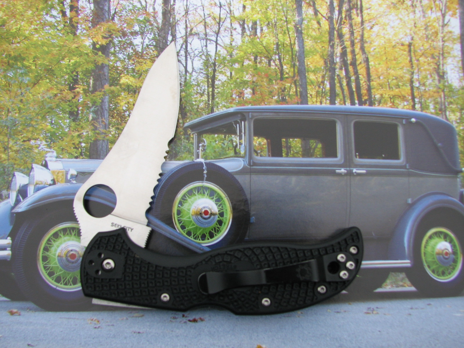

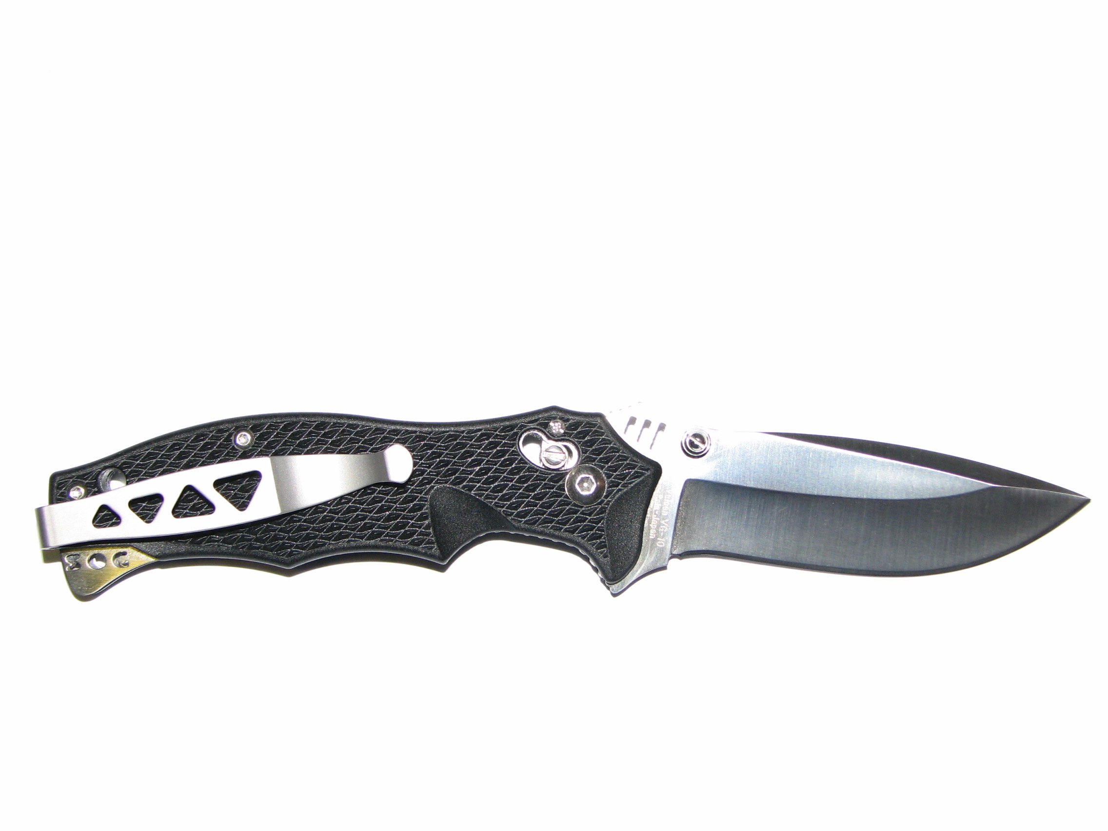

I have a Spyderco Stretch with partially serrated blade in VG-10 and a plain edged SOG Mini-Vulcan with VG-10. I can attest to the fact that it takes diamonds or patience to put an edge on that steel, but once accomplished it retains that edge quite well. These two are my top picks for a tactical type carry knife although I do have a few others to choose from.
Guess I need to take that zdp189 for a spin too.
