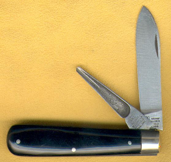

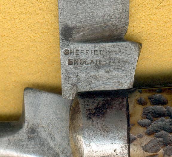

I don't know much about Sheffield knives, s-k. This one may not be that old, but if you or anyone can help me date it, I'd appreciate it. Is it post war??

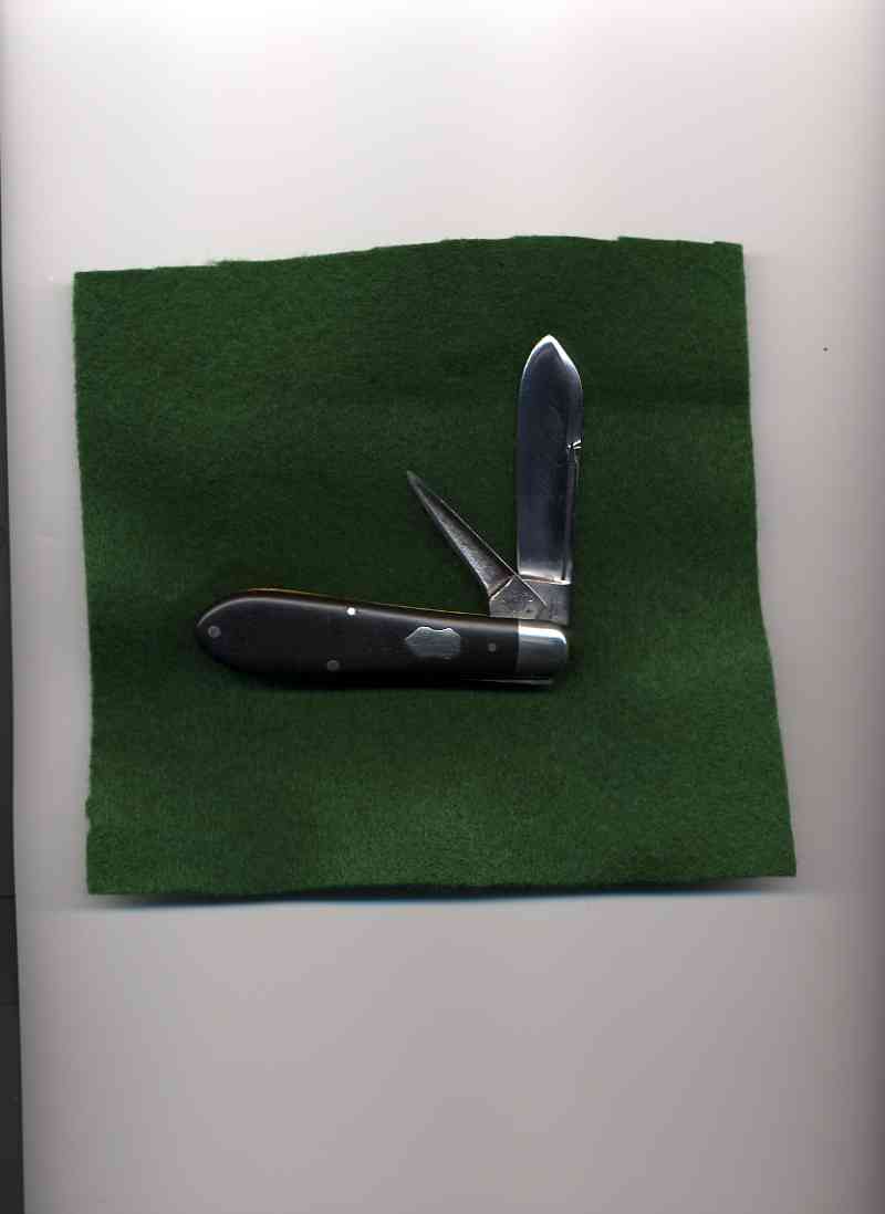

Same question here folks; please help me with anything you know. And that's it for my Sheffield HJs!

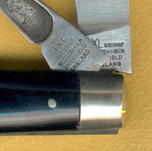

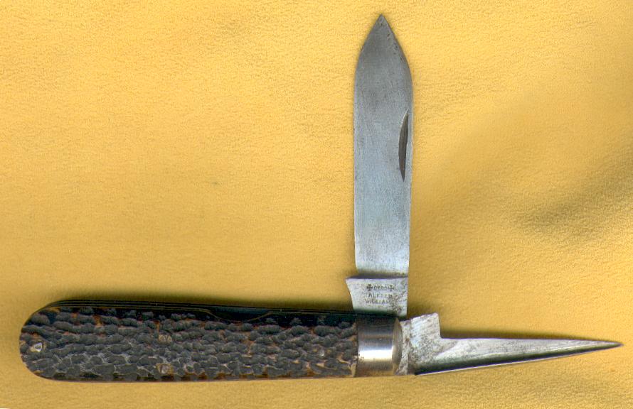

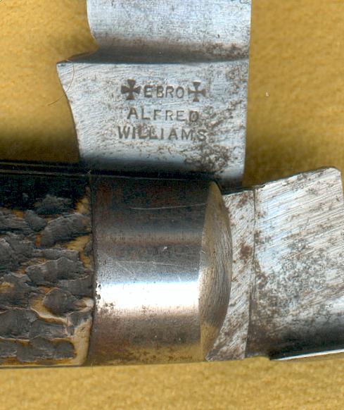

Thanks for showing those great Sheffield Harness Jacks Upnorth. The Wostenholm is hard to date without access to catalogues etc. That stamp was 1891-1971. However, in the 1930s Wostenholm started using 'oil the joints' on the back of the tangs. If not present, then likely pre WWII. Goins lists Alfred Williams ebro 1891-1920. That's the best I can do at the moment. Great knives. ::nod:: s-k

I love the jigging style on that Brit HJ, I would like to see more of that style... ::tu::

Thanks for the info, s-k! The Wostenholm has "oil the joints", so must be after 1930. I'm surprised the Alfred Williams is that old- it is virtually unused!
Sunburst, that jigging wraps almost around the handle to the liner! It must have been jigged and dyed after a fairly close fit. A lot more hand work than today's knives for sure.

upnorth wrote: I'm surprised the Alfred Williams is that old- it is virtually unused!
it is a beauty upnorth. I love the bone on that one. It is possible that the name was bought and used by another company. That seems to happen quite alot. I will try to find some more information. :) s-k
