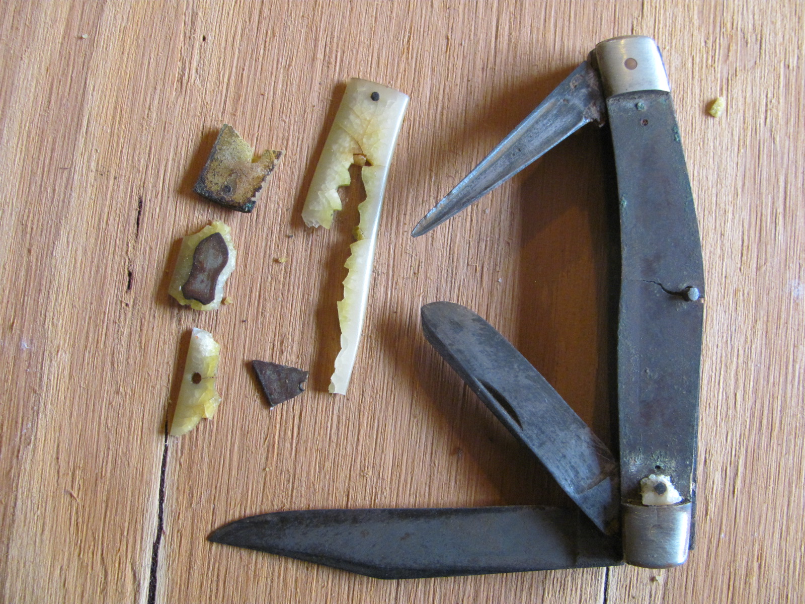

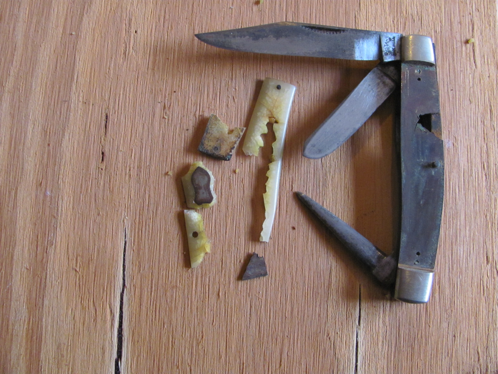

Is this old wreck of a Cattleman's knife worth putting hours of work in it. It is a glaring case of what out gassing will do to the frame as well as the handles. it is a Westaco (?) made in USA sometime in the 50's. I carried it as a kid and lost it in some moves our family made. After my Papa passed in 2004, I found this in an old metal coffee can with the lid jammed and rusted shut. Several other old junkers were also in the can. The smell of the out gassing almost knocked me down when I finally got the lid off the can. I barely recognized this old friend. It has been my junk box for 6 or 7 years and since being a looker on AAPK, it has entered my mind to restore this clunker . . Thoughts? ?

Not an expert, but I would say that that knife is pretty well shot. Maybe Dale or someone else has a suggestion for a patch job to the frame, but it looks pretty bad

Re: MAJOR RESTORE?
Blades look servicable and the bolsters don't look too thin.
It looks like a project that could have a very nice outcome.

I am probably "above average" in the field of metal working but knife repair is still really new to me hence the questions. And it does have some, not a lot, but some sentimental value. The blades and back springs seem to be pretty much intact as are the bolsters*. The frames and liner are just thin brass and with transfer punches and careful milling (by hand) reproduction could be accomplished. These old blades are in pretty good shape - - lots better than the frame.
There are some "knife building kits" from some vendors online and maybe those parts could be modified for this repair.
* Are the bolsters soldered on or just held by the pins?

Re: MAJOR RESTORE?
I have repaired knives in worse shape than that.
You have a couple options as I see them:
1- Fine a knife with the same frame that has a good frame and bad blades & put these blades in the good frame.
2- Get some sheet brass & rebuild the liners and some 3/32” sheet nickel silver for the new bolsters.
A donor frame is likely the easiest, IMO.

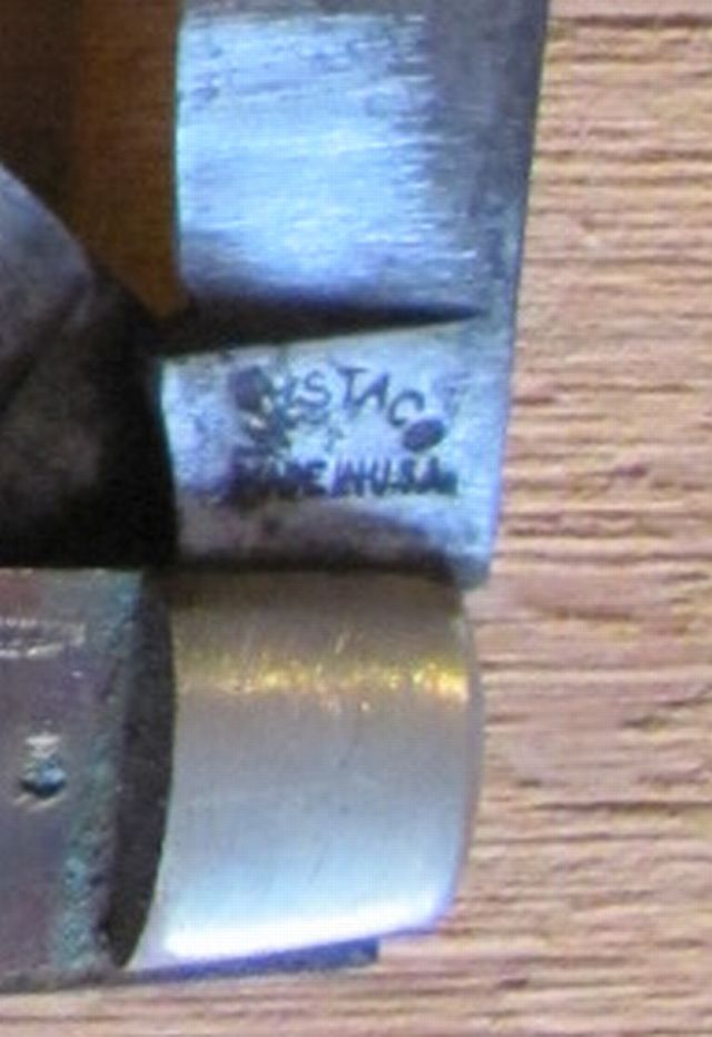

Do you have a clue about the maker? It looks like "WESTACO" but the first two letters are hard to make out.

I seem to remember seeing Westaco on some sheath knives made by Western Cutlery.
