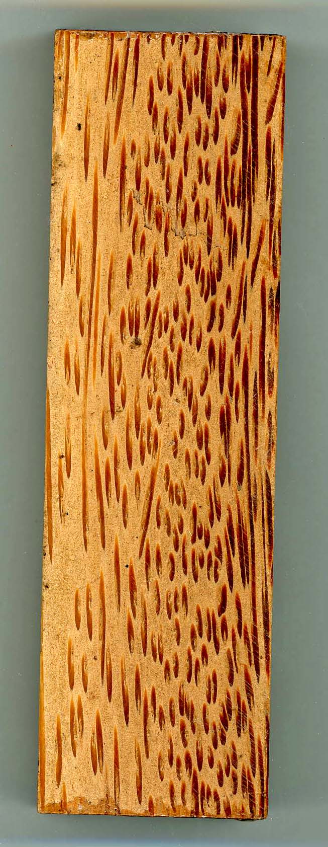

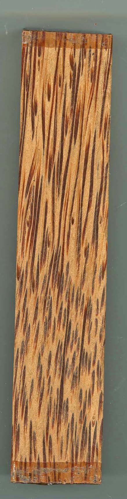

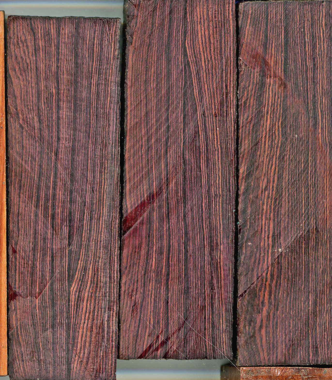

Here are a couple pics of a piece of Red Palm I got at Gilmer Wood. They a lot of knife blocks there. they are usually 1" X 1.5" X 5". They usually sell from $3 to $7 depending on what it is. I bought the few remaining blocks of Mexican King wood that they had left. Mexican King Wood is no longer on the world market, so is very hard to get. I think I paid quite a bit more for the King Wood.
They have a whole section of shelving about 6' X 10' that is bins of knife blocks & all different kinds of wood. I find some nice stuff there. They don't list the knife blocks on their web site either, (at least I haven't found them). You kind of have to go in and dig through the bins & find what you want.
Here are a couple scans of a piece of Red Palm & some King Wood that I got there. The end grain of the Red Palm is much more striking than the sides are.

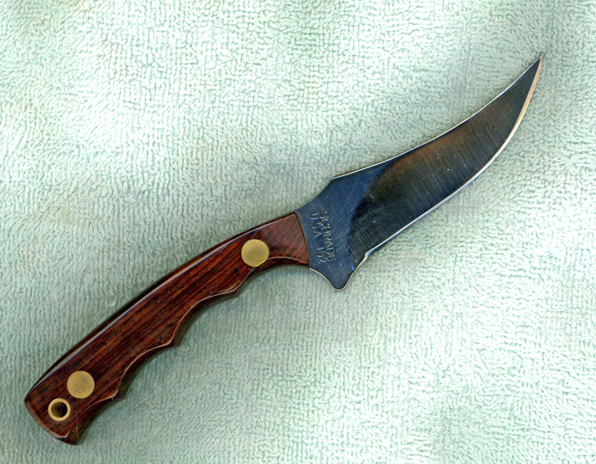

Here is what King Wood looks like on a 152OT modified with finger grooves. It does loose some of the purple coloration.
PM inbound.

That's a real good lookin' knife Dale.
Bill
Bill

Thanks for the complement Bill.
I made that one last year, when I bought a bunch of 152OT blanks. I got to experimenting with putting finger groove in the handles. I think it really improves my grip in the knife & looks cool to!

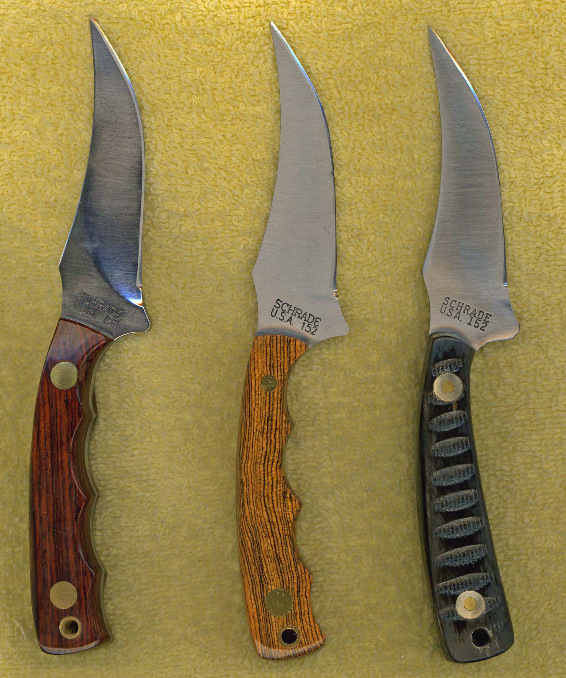

Here are a couple more for your viewing pleasure. Sorry, it is not a great scan. The handles are L to R: King Wood, Presentation Grade Bokote, and Water Buffalo horn jigged to look like Impala.
