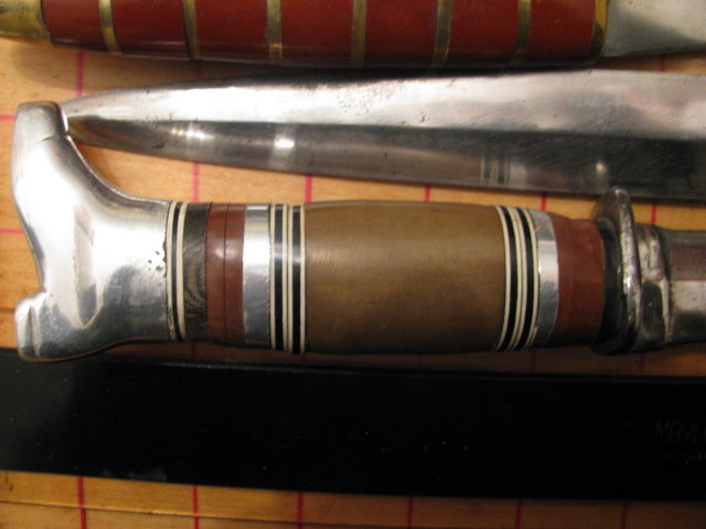

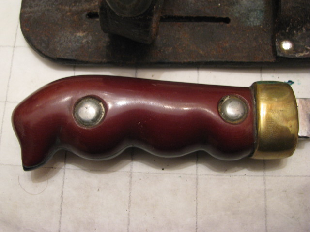

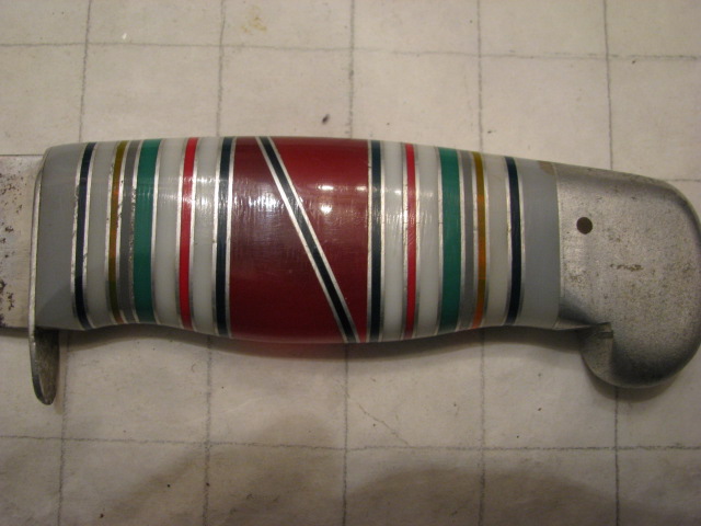

knife7knut
Posts: 10697
Location: Tecumseh,Michigan
Re: WW2 Theater made knife handles
Post by knife7knut »

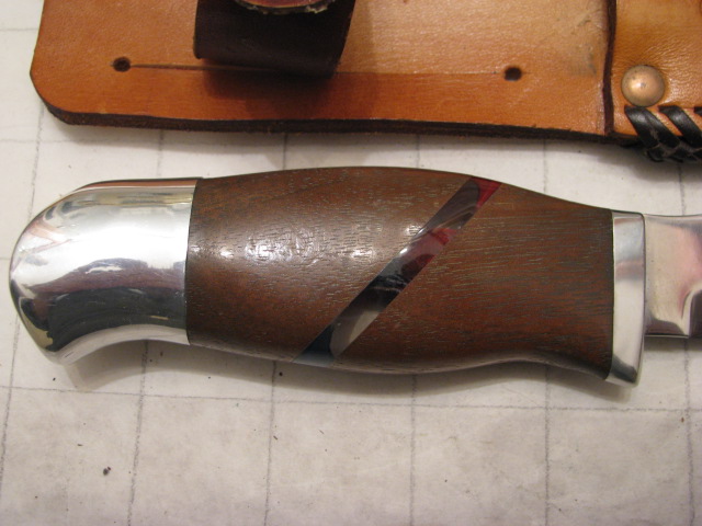

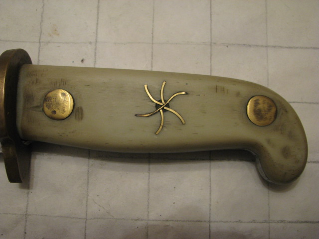

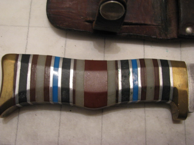

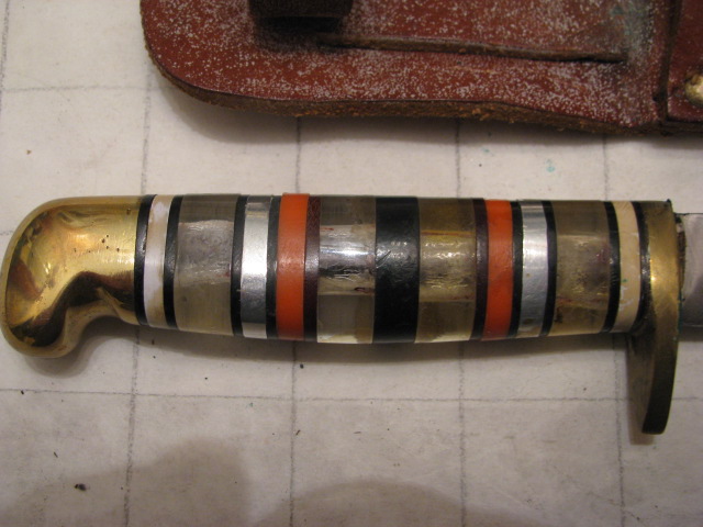

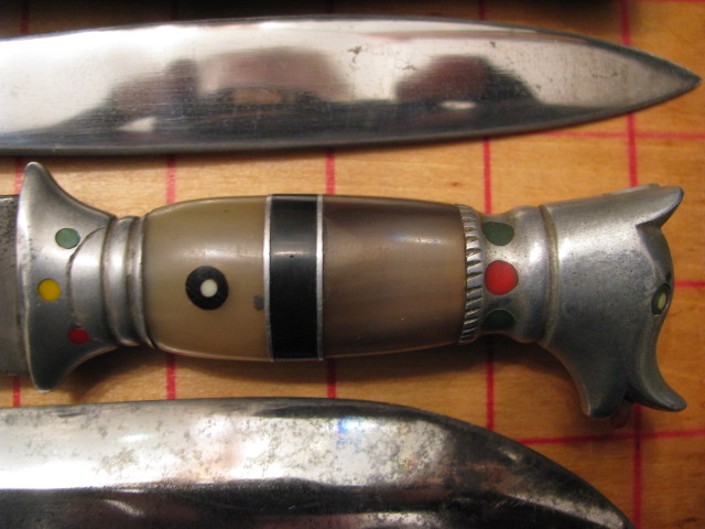

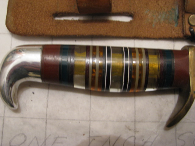

Here's a few I've collected over the years.Some are obviously post WWII but others? You decide.
Knives 002.jpg (43.07 KiB) Viewed 4951 times
