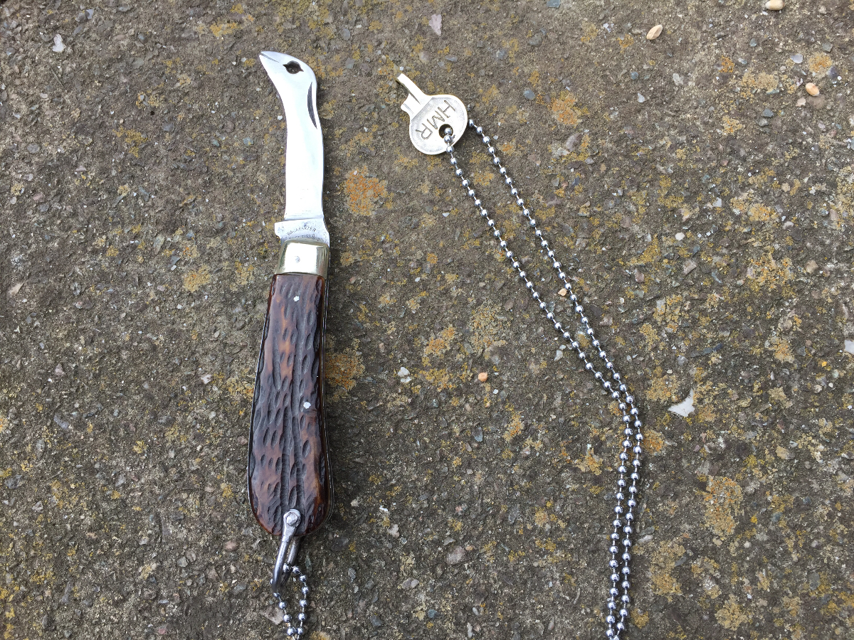

Hi Folks, here are my thoughts from England. I spent today in my Blacksmith forge restoring rusty old bone handled pen knife for my daughter's birthday. Yes it was stiff! I tried all the suggestions here and it was only a
little easier. I also tried pumice powder and oil and many open-closing attempts, some success. I then tried filing the blade haunch by inserting a thin wiffler file into the housing. Better but I realised the spring was strong and so would not really change without retempering, a long job and worth it. Anyway a stiff spring makes the open knife safer. So, being divergent I thought of drilling a hole to aid pulling the blade. I was reshaping the blade anyway - to make it a pruning knife and so the hole was ideal as an eye! Now I have a Swan, or Duck head blade and have added a bent key to make pulling it open easier! I fancy making more of these now...

Leafman welcome to the forum! That is an interesting solution to the problem of a nail breaker pull, and a very good looking knife. Do you have a before photo of the knife?

Leafman
Posts: 2
Joined: Fri Apr 07, 2017 2:14 pm
Re: Loosening Stiff Spring
Post by Leafman »
No I don't have a before photo - I kicked myself halfway through about that. I normally do but this time ---- oops.
