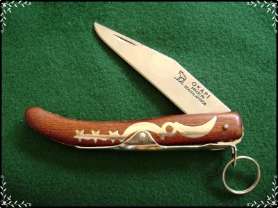

Dave, get yourself an Okapi ratchet lock. I'd be willing to bet it won't fold up on you unless you want it to and maybe not even then.
