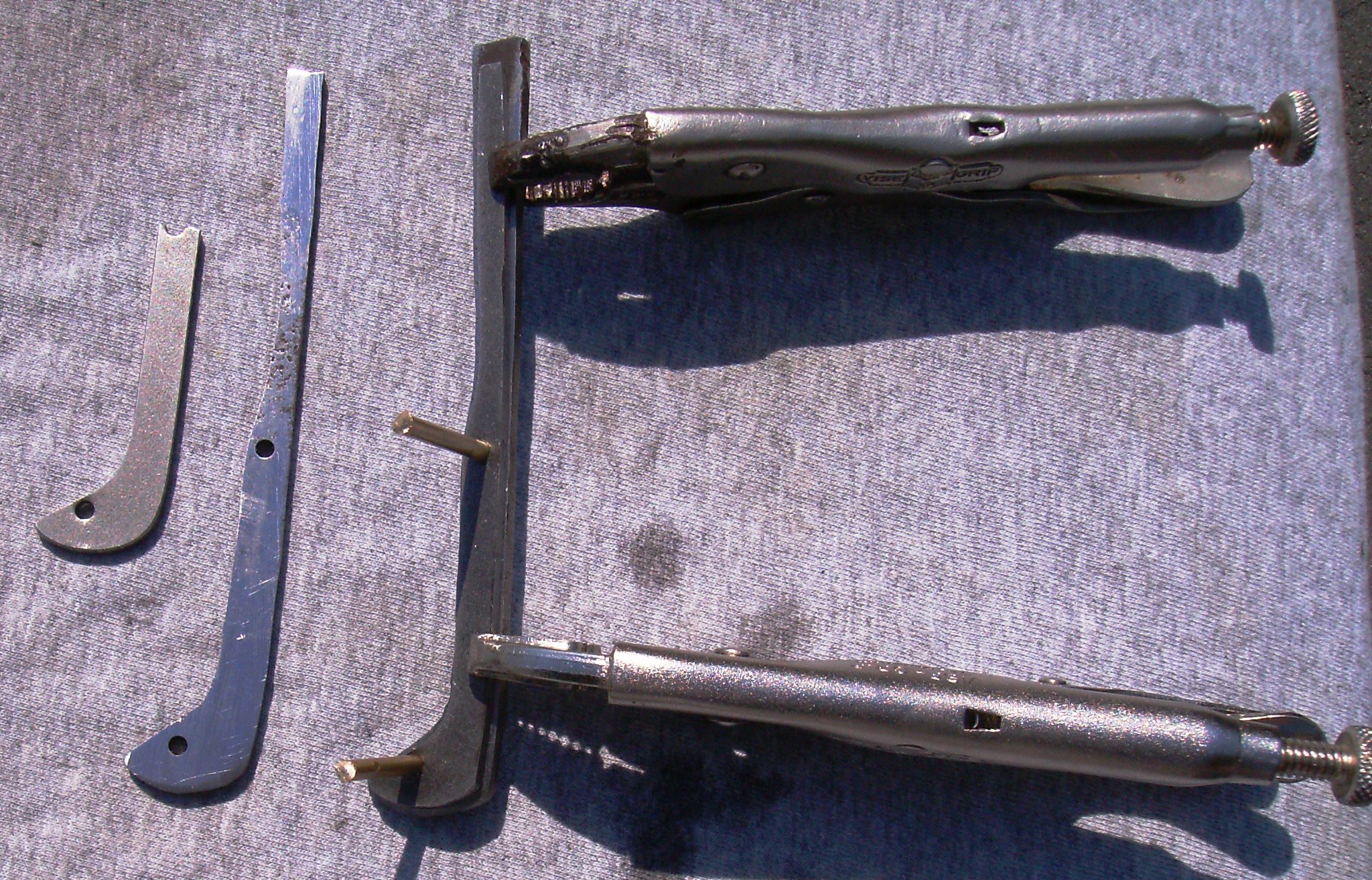

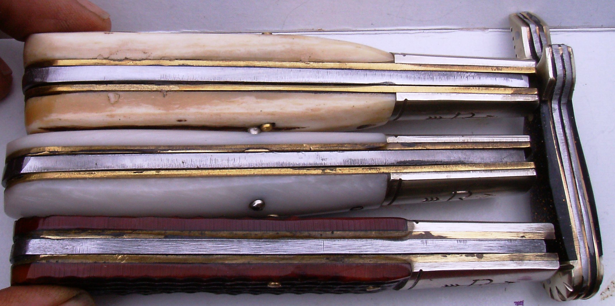

I'll update this. I bought 3 knives that were just alike. Only 1 of them had a good backspring. It was 3/4 x 5½. I didn't have any springs that long to try and make others from. I don't want to buy and stockpile parts I will never use again. I did a little digging on the Internet and found what type of steel to use on these. Actually steel from a lawn mower blade is a type of spring steel and I thought suitable for my purposes. I was really happy when I went to the salvage yard and found one just the thickness I needed for 50¢.

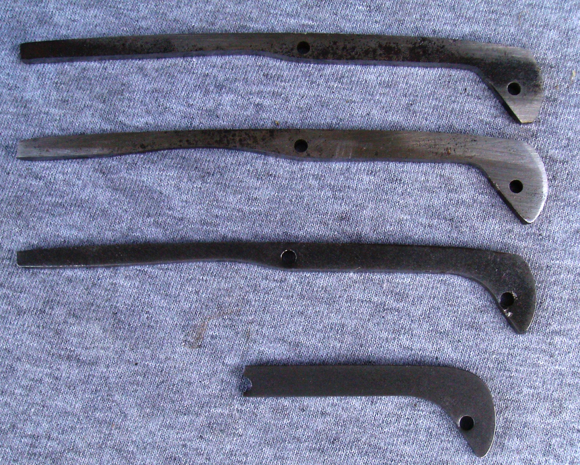

The first pic shows the 2 blanks I cut from this
Then clamped together with locking pliers and used the good spring to get the hole locations.
Clamped back together and ground to near finish size. I want to dry fit these before I say they're done. I will finish them on the belt sander.

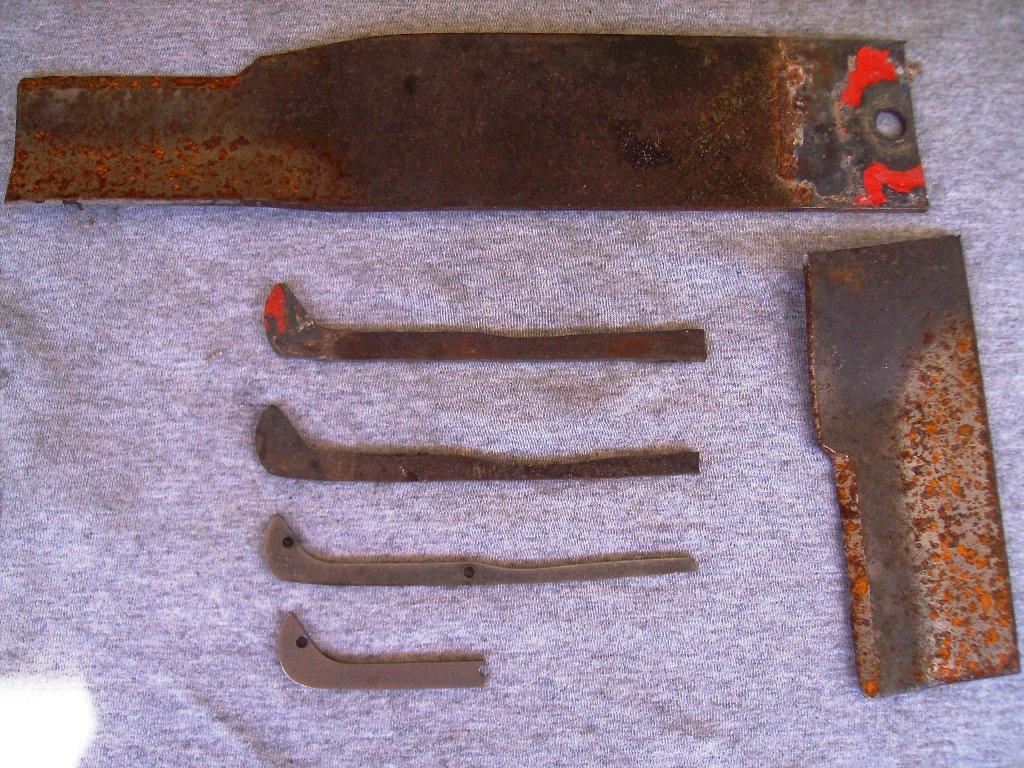

Don't know if I changed the temper of the steel with the drilling and grinding or not but decided to try and harden them a bit. Here is the procedure outlined in Ben Kelley's knife repair book. Heat until cherry red with gas torch - emerge in oil - rub with emery cloth - then place steel on a 1/4 inch steel plate that has been heated on a hot plate - When the steel changes to a dark blue color remove it and wipe it with oil.
I don't have a gas torch so here is what I did. I removed one burner from my gas grill and placed the springs on the open flame. I let them go for about an hour and they still weren't cherry red, but they were very hot (well done?) I then emerged them in oil and rubbed with steel wool. While they were heating I did have a thin steel plate on the other grate heating. I placed the springs on that and never did see them turn blue. Maybe I didn't get them hot enough? They did turn a dark color and appear different after the heat treat. A picture shows this and also the dry fit to the knife I'll put them in.

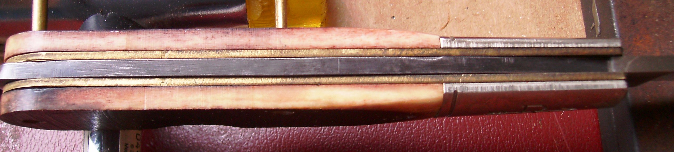

More pics. The first pic is after an hour in the grill and then just placed into the knife to see how close it was. I think this will work. They may fall apart like a $2 lawn chair, but so far - so good.

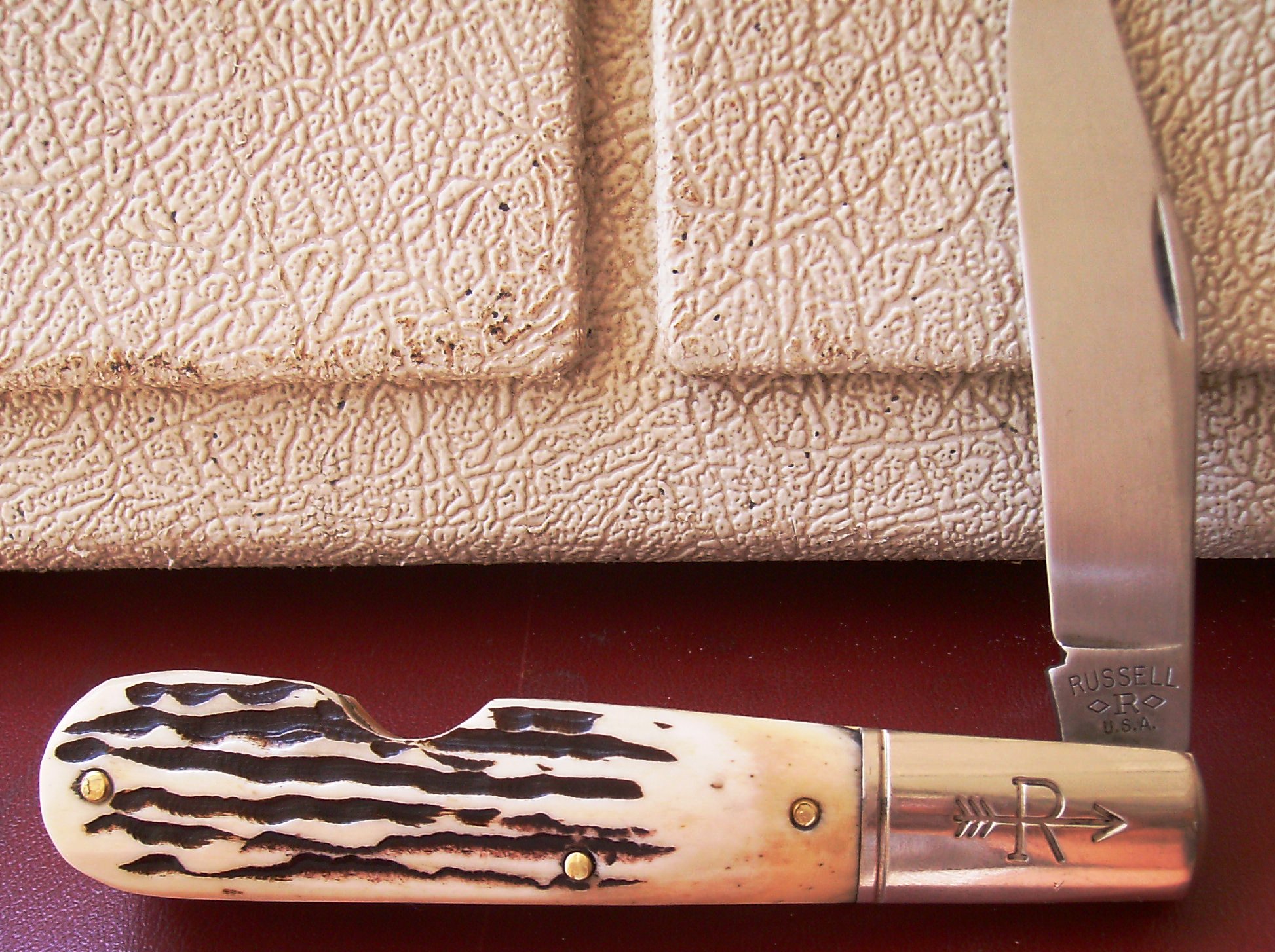

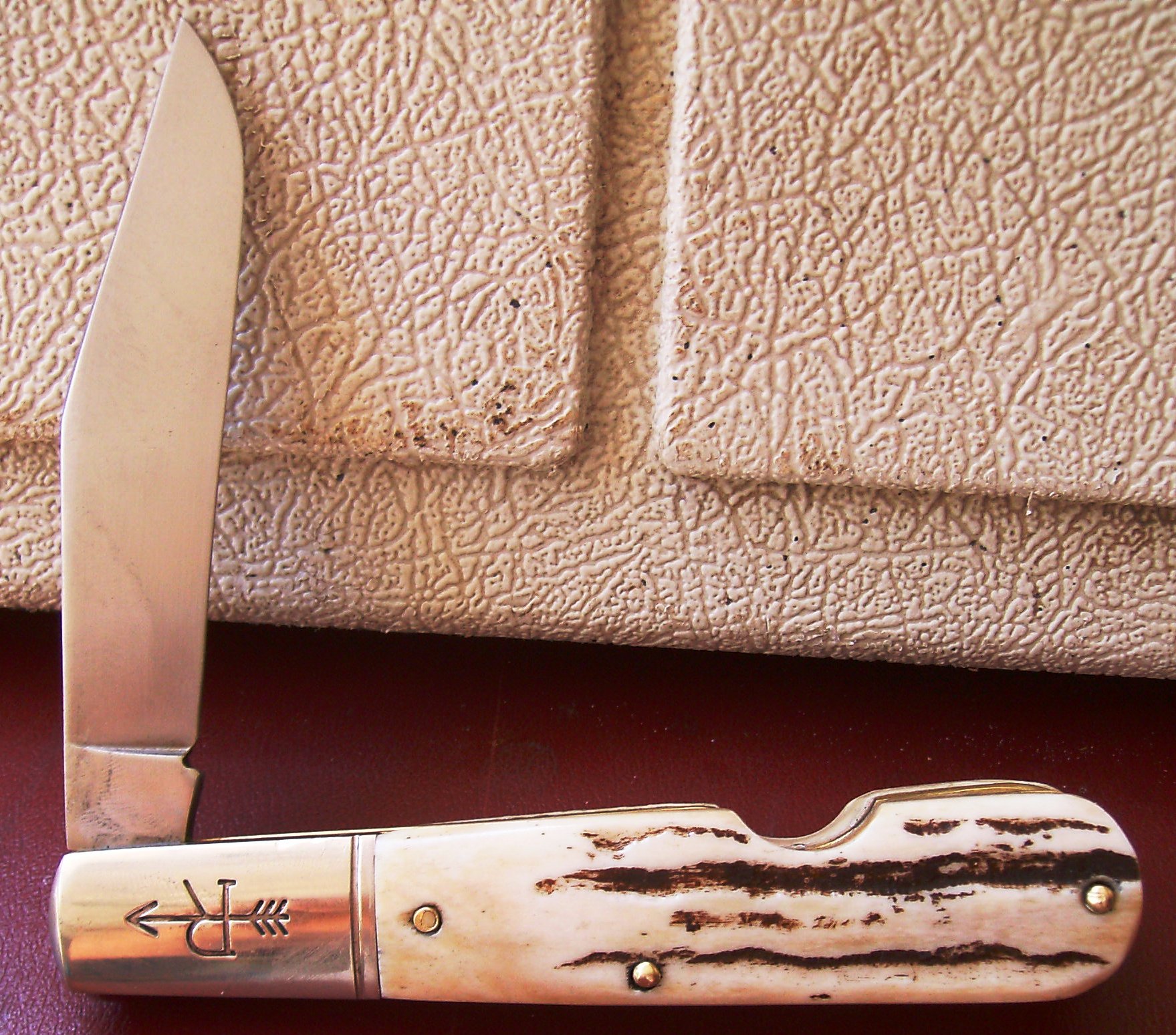

I got one of these knives buttoned up this morning. The inspiration came from this web site. There is a Russell for sale with stag handles in one of the stores. I got this stag on ebay. I have 2 more of these to do and am going to do one in sawed bone and am uncertain on the other. The knife I just finished has excellent walk & talk and half-stops. Maybe the world's first Briggs & Stratton / Russell Barlow hybrid? I'm still not too good at finishing a knife up, I fear cracking the scales trying to get them too tight. There is some slop at the butt end of this knife. I am going to practice on some junk and maybe come back to this knife later. I'll post more pics when the other 2 are finsihed.

Hey, J - Bob~
That knife is absolutely beautiful.
I wouldn't worry about the little gaps here and there.
I have an original green river easy open with ebony handles.
It has gaps that were there from day one.
Stag is a little more forgiven than bone is.
But you still need to be careful when pinning.
Excellent job~
We need to see more of your work.
J W

most quality lawnmower blades and saw blades (like those from sawmills) do not need to be retempered for a backspring as they are spring consistency from the start. As long as you keep it cool by dipping in water while grinding you won't have to bother retempering.

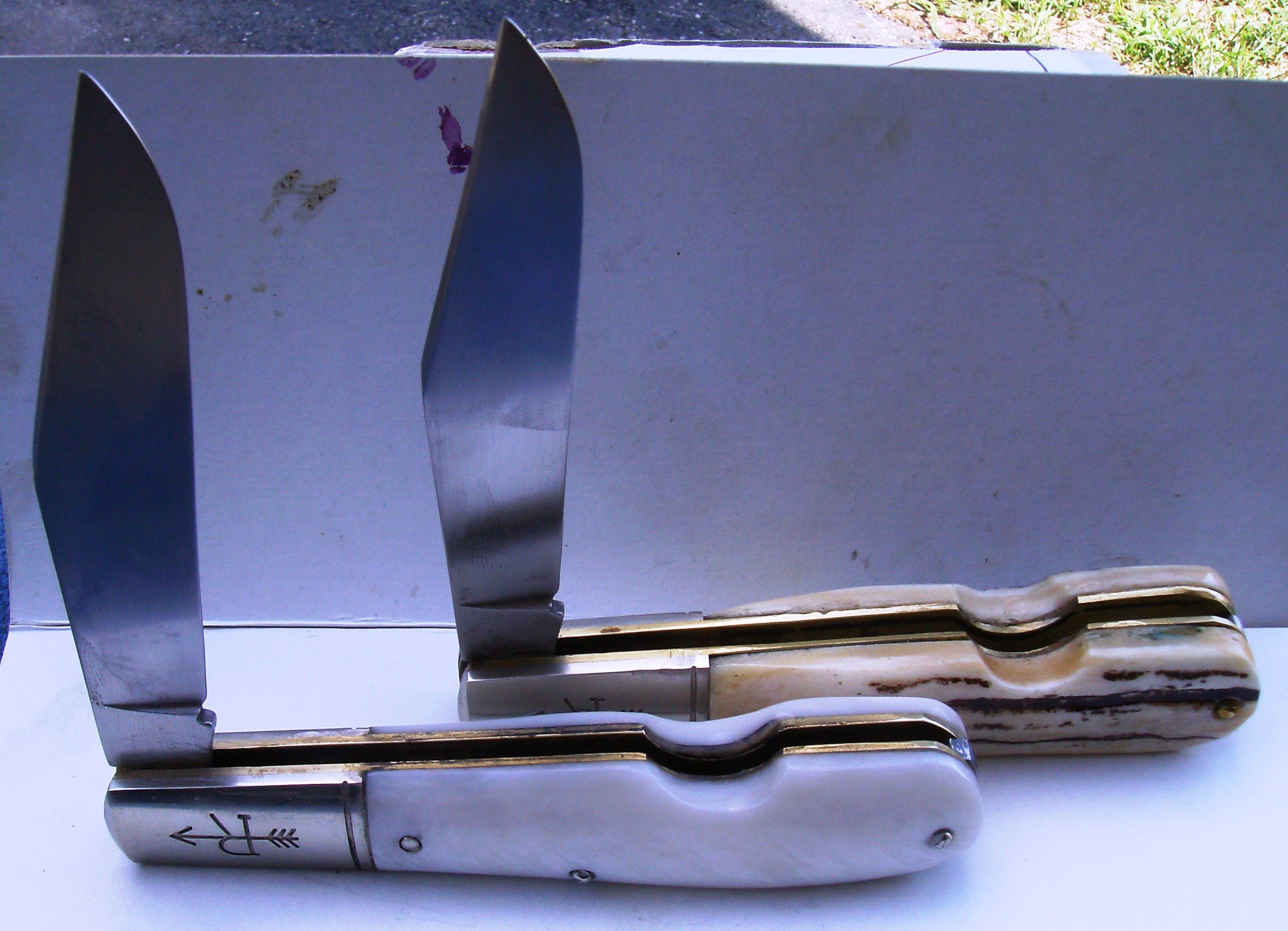

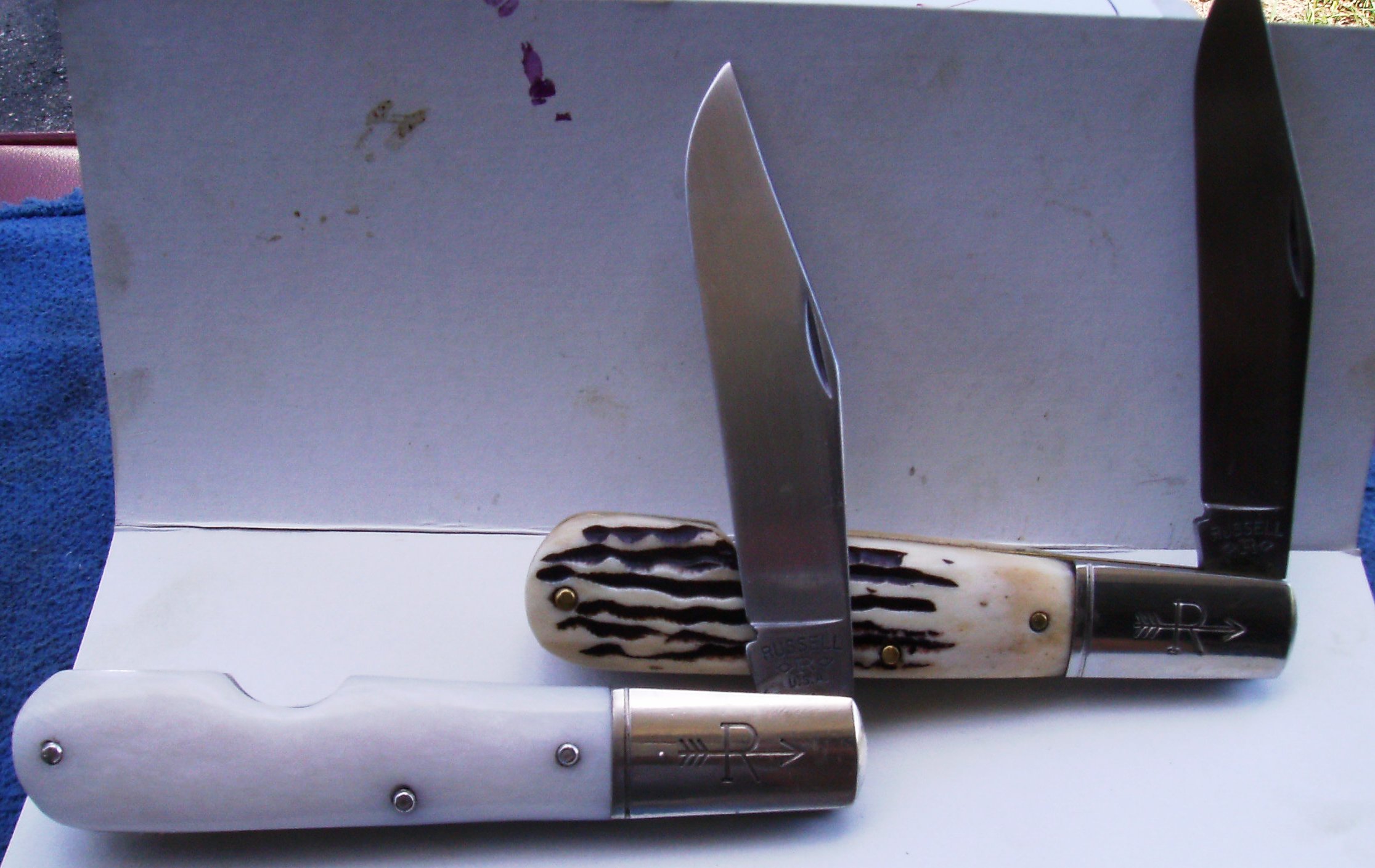

Got another of these knives done today. I also got the inspiration for this knife from this web site. I saw the pearl handled Russell that was the Board of Directors knife in an auction. This is one of the pen blanks that was 1" wide. It is their version of imitation MOP. I have one more of these knives to do and have the original back spring left to work with. The two I made seem to function just fine. I hope to do the last knife in black pick bone - if I can find it.
Men make plans and God laughs

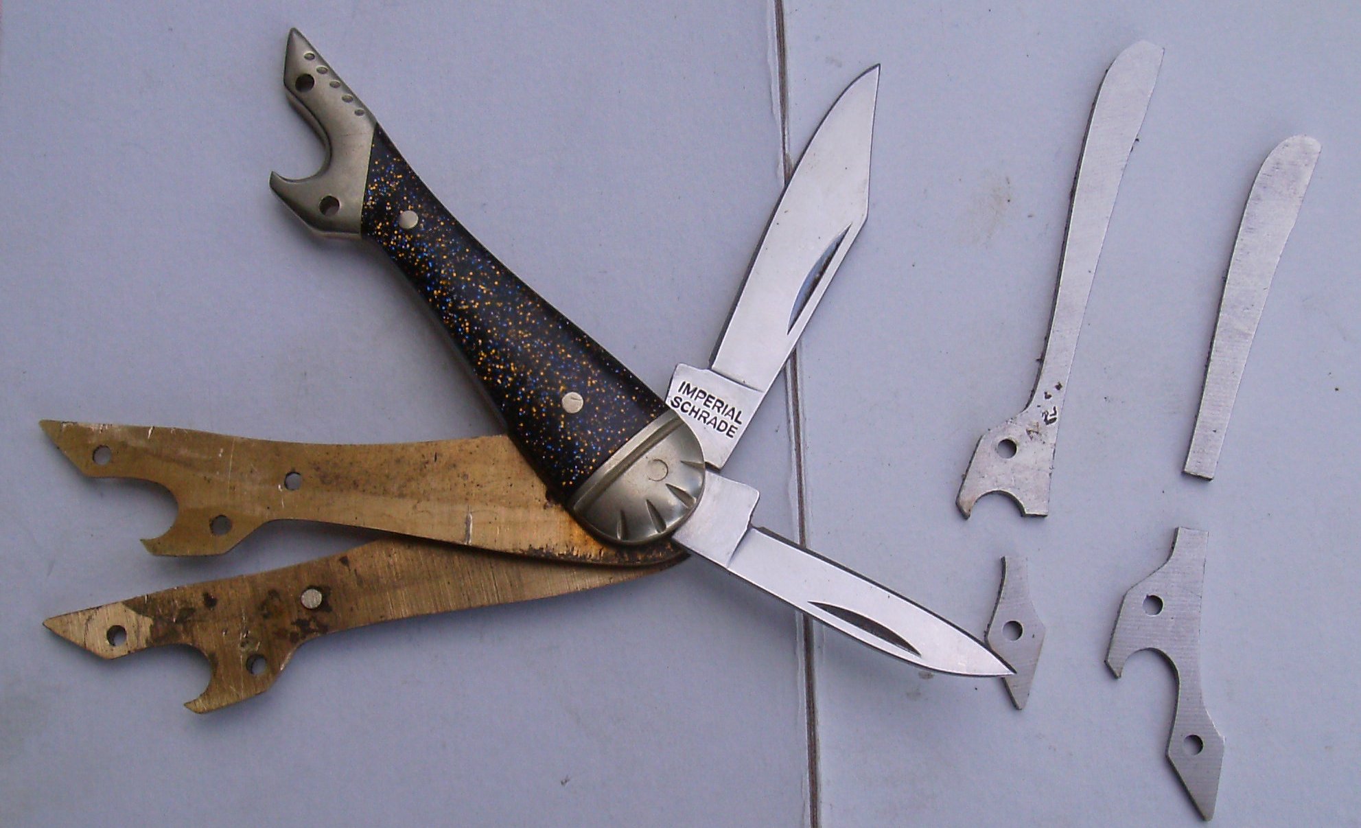

Since the subject of this thread is back springs I'll post this here. My brother collects these leg knives and has over 300 better knives. This is one of those cheapo knives that are all over ebay. This knife was never used or carried. It was only opened to clean and oil. Both back springs on it broke in no time. I took it apart and they are .070 thick and look to be pot metal. In fact they look to be the same material that those cheap fingernail files are made out of? If you send these back for reapir there is a $7.50 S&H fee. When you include your original postage the repair isn't a bargain at all. It's cheaper to buy another - and maybe they know that.

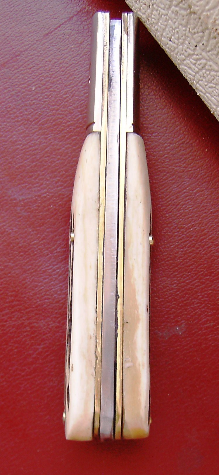

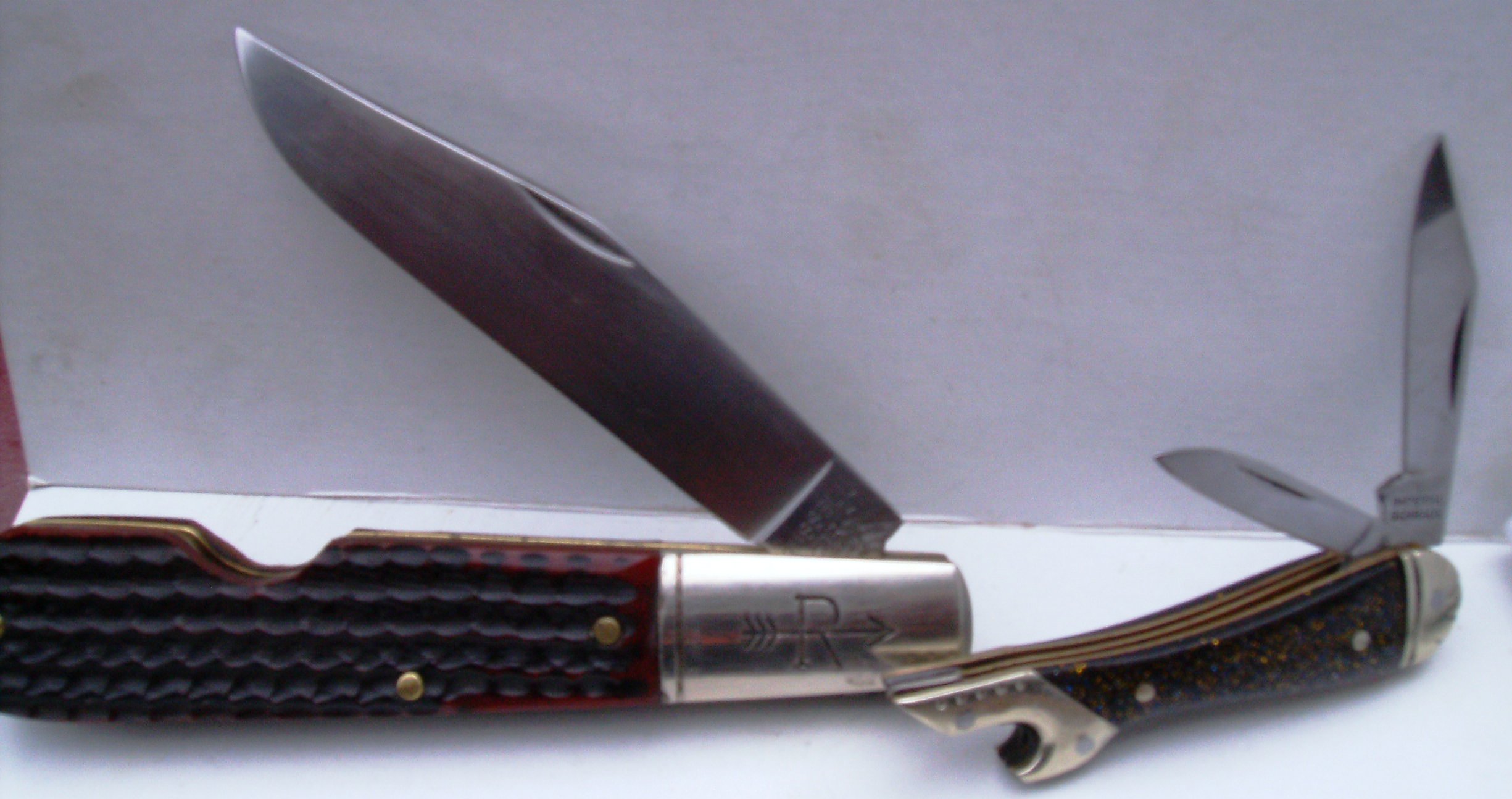

Got the last one of these 3 knives done and don't want to sound boastful, but it is my best work to date. Found the bone scales at the Lexington knife show and wish I would have bought more. They were at a good price with no S&H and that goes a long ways. I also made the back springs for the little leg knife from an old kitchen knife that was the right thickness. Even it it's an $8 knife I'll include a picture. I have also found out how to drill back springs and hard steel. If you heat it red hot with one of those gas torches that they solder with ($25 at Menards) and let it air cool you can drill right through it. I wasted a dozen drill bits before I discovered this.
