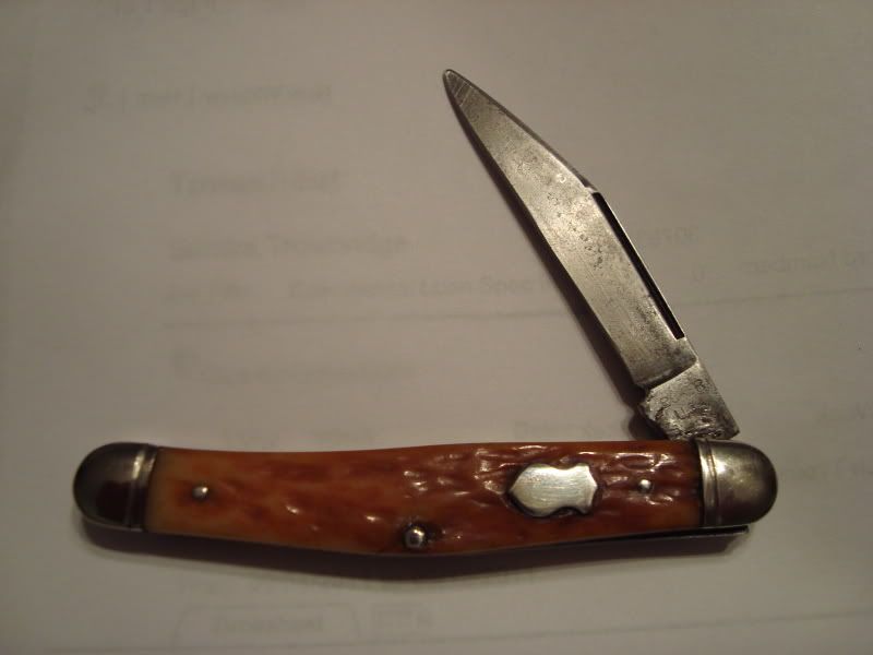

This is a Boker that I did this morning. It was originally a slim 2-blader, one of the blades was broken, and the other was pretty worn. But I liked the handles. I had another Boker stockman, that had a tipped main blade, but it was pretty full. So I grabbed the blade and the single spring, and made it into this. Sorry I didn't take any progress picks, I was "in the zone". ::tounge::

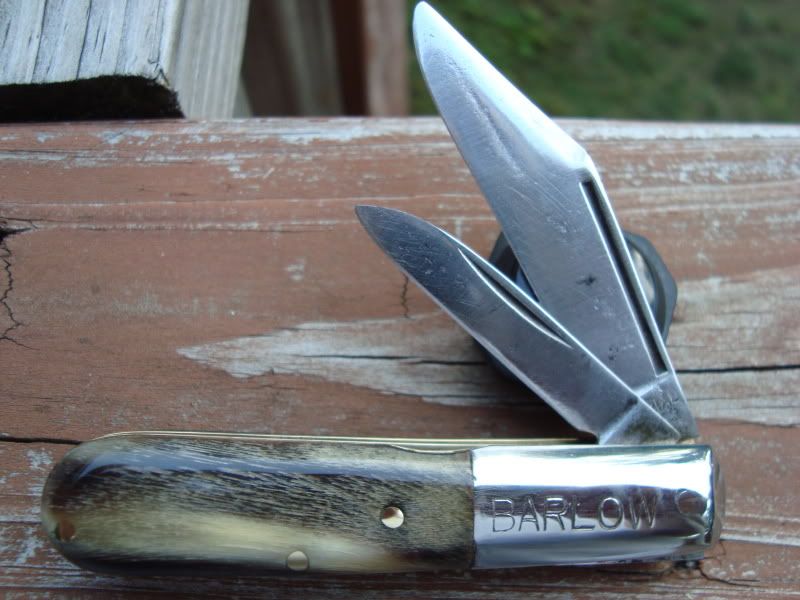

This other one I call the Frankenknife. It started out life as a cheap Pakistan barlow. My sister had actually picked this up for me in her travels. She doesn't really know about knives, but it was real nice of her to think of me. Anyway, I liked the horn handles.
I took the knife apart, cleaned everything up, and scrapped the crappy blades. I had some used Imperial blades that fit well, so I used them. The bolsters were hollow, so I filled them with solder to give some beef for pinning. The small blade sat a little low, so I cut a small notch for the nail nick. Didn't come out too bad, and should make a nice user.

Two very nicely executed "saves" Glenn. That barlow would definately make a great user now with those Imperial blades installed.
Good work. You improve with each effort. ::tu::

With Imperial blades it should cut up a storm!
