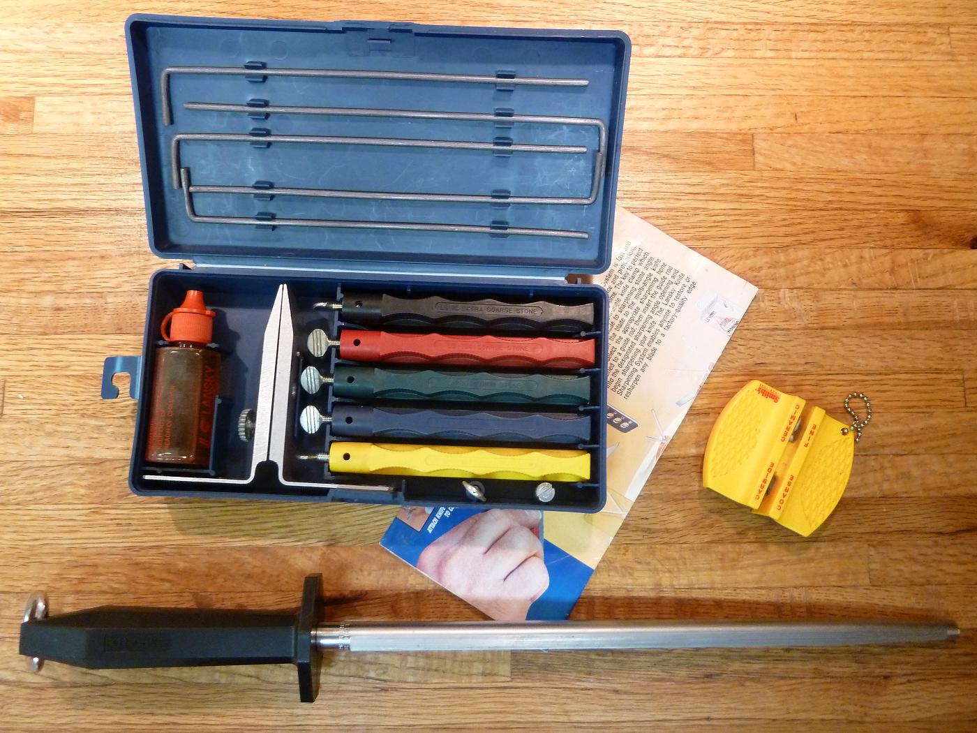

Sorry if this is in the wrong forum. Not really a repair or restoration question but I'm not sure which forum to use.
In any event.... I'm an idiot when it comes to sharpening. I enjoy a sharp knife but already have too many other things to work on and fix (work as a bike mechanic on the side) and I know for a fact that I don't have the time to practice to get enough to get shaving sharp results working on a stone freehand.
A buddy recently loaned me his Lansky set up and WOW!! For the first time I was able to get knives shaving sharp. It's an idiot proof enough approach that even I can get an OK result.
Another friend has suggested that the Gatco system is better. Better stones, better clamp, more angle choices.
Thought I'd ask here to get more opinions. Is there a strong preference between the 2 systems?
Any other idiot-proof alternatives I should look at?
Thanks a bunch!
Thanks a bunch!

Good question. Over the years, I've purchased a half-dozen "short cut sharpeners", all electrified and none have been totally satisfactory. The Work Sharp I bought earlier in the year is just fine for kitchen knives but it sucks for pocket knives. These days, I'm too lazy to go back to my original Bear stone that in my youth, worked just fine. I've had my eye on a Lansky for several months so I'll be watching the replies to your question with great interest.

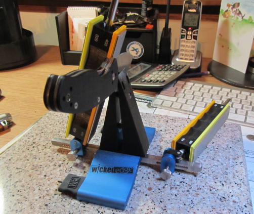

Never Argue With a idiot
PAUL
PAUL
- Gunstock Jack
- Posts: 1639
- Joined: Wed Feb 27, 2008 7:59 pm
- Location: The "other" Washington
Re: Gatco vs Lansky?
That's a nifty set-up, Paul. Thanks for showing it.

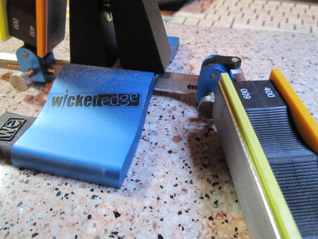

Holy sheep shanks!!!paulsvintage wrote:even i can sharpen a knife with this one
http://www.wickededgeusa.com/ZenCart/in ... jtq41j4413
- paulsvintage
- Posts: 2160
- Joined: Sat Aug 07, 2010 12:26 pm
- Location: Delray Beach
Jerry. there is a 3 month wait for them gave me a little time to save up for it. i tried most of them with not much luckjerryd6818 wrote:Holy sheep shanks!!!paulsvintage wrote:even i can sharpen a knife with this one
For $250, I would hope so.
