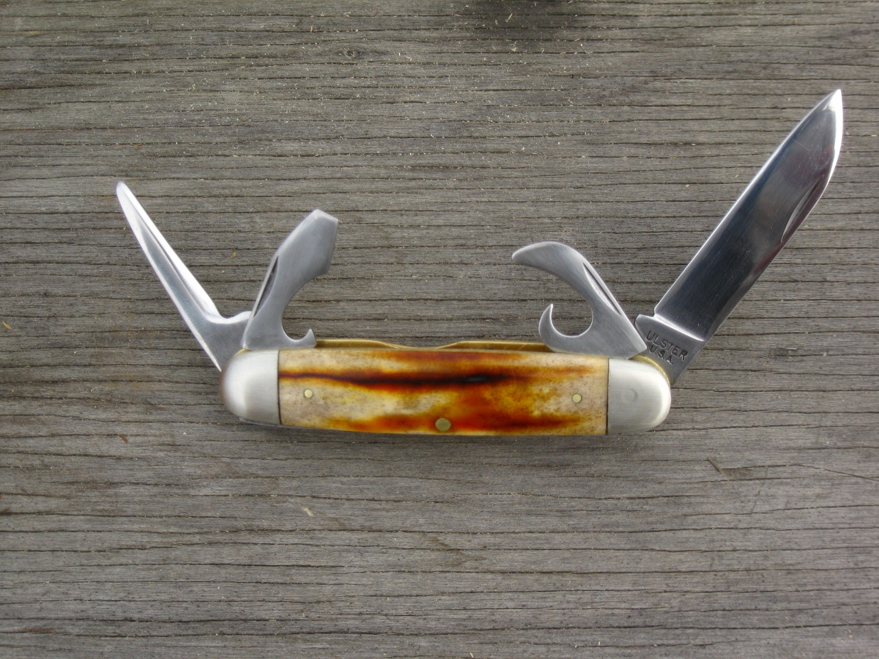

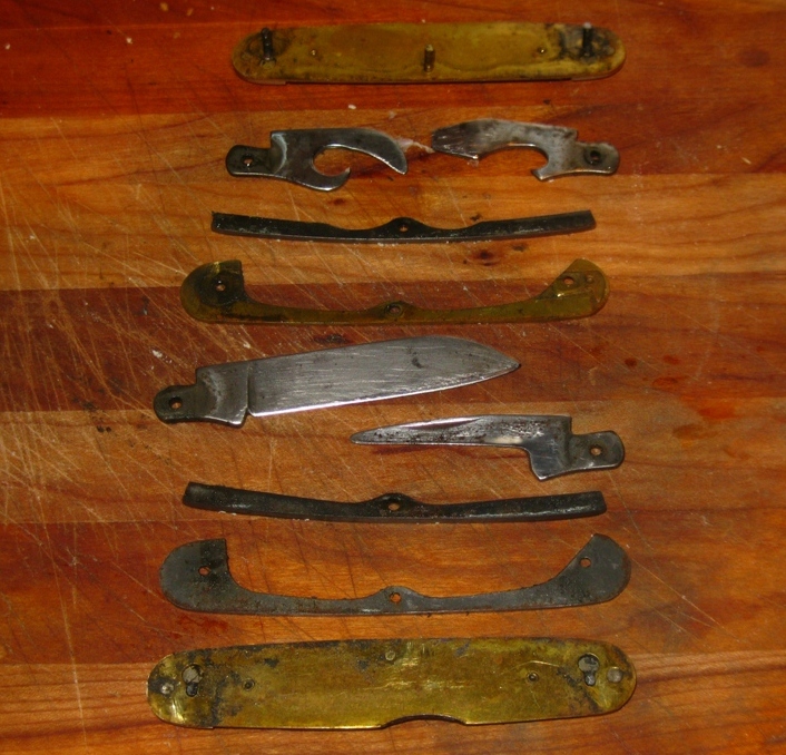

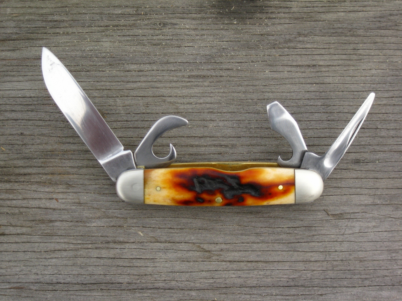

One of my first redos was this knife, a $ 1.00 investment form a garage sale. When I took it apart I laid the pieces in order on a board and photograph them. I should of taken more. These guys are right, lots of pictures sure help. Pics should enlarge.
Gary
Gary

Gotta' be worth more than a dollar now.gary wrote:One of my first redos was this knife, a $ 1.00 investment form a garage sale. When I took it apart I laid the pieces in order on a board and photograph them. I should of taken more. These guys are right, lots of pictures sure help. Pics should enlarge.
Gary
Boy that first one of yours turned out well.
nice scales.....
J W
