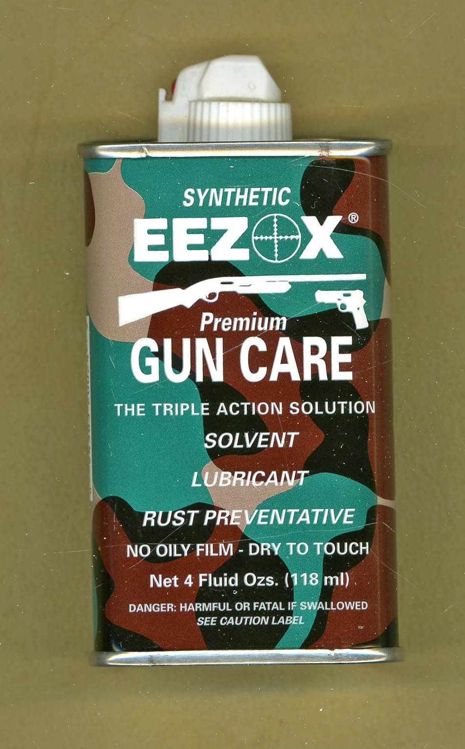

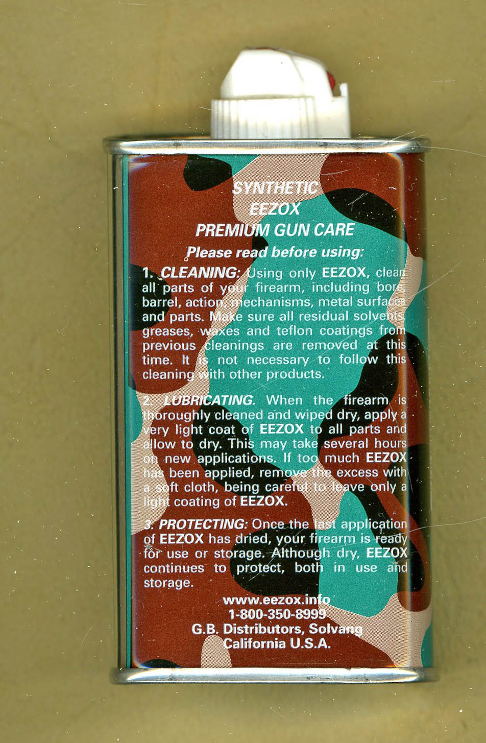

orvet
Posts: 19901
Re: Friedrich Olbertz Svane Kniv knife restoration
Post by orvet »
There is a good product for preventing rust that was developed for the gun industry.
It is called Eezox.
I ran in to some guys at the OKCA show this last weekend who use it on knives also.
I learned about it from a customer who is a gun collector.
I have used it with great results.
BTW, nice work and a nice save of an old knife!

Thanks for the info Orvet,
But I like doing things the old school way.
My Uncle was an extreme fisherman.
I remember when I was a Kid watching him soak his fishing knives in German potato salad.
Sounds a little weird I know but it actually works on High carbon steel blades.
It also gives the blade a dark gray black patina. Sort of an antiquing.
After soaking them he would wipe them down with light weight oil.
Plus when you make the salad you can eat some of it before you use it on your blades.
I inherited one of his steel fishing rods & reel and an old filet knife after he past on.
The knife & rod has been hanging on my wall for years and I occasionally use them and after use I just wipe them down with oil and the knife & rod show no sign of rust.
