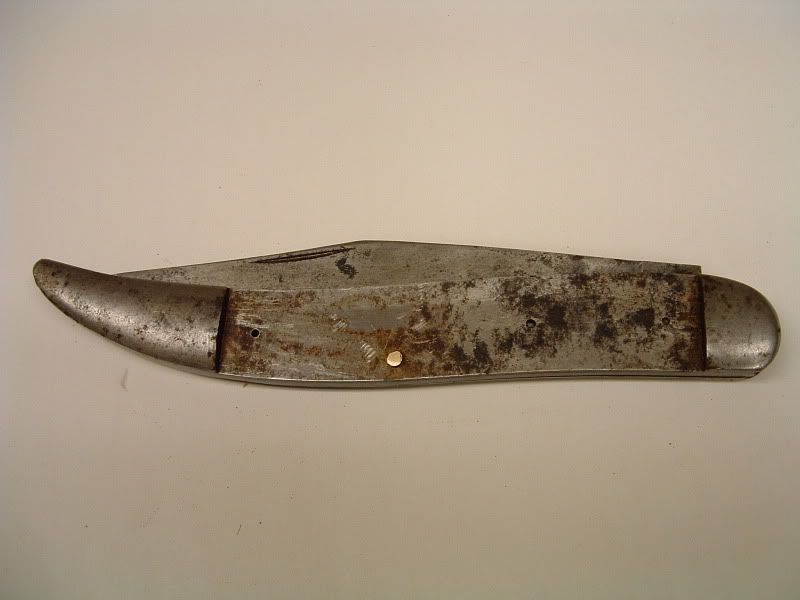

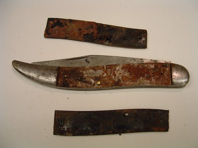

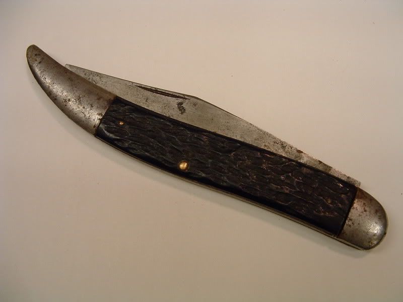

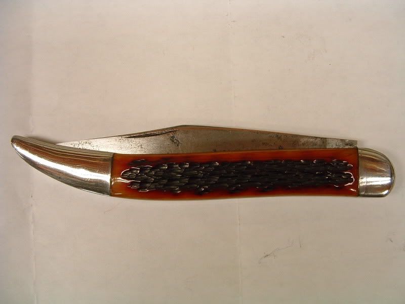

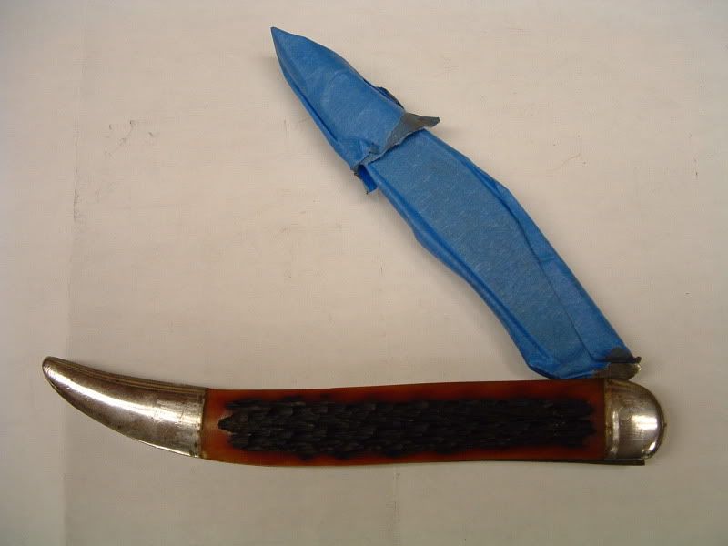

Here's another I just finished. This Remington toothpick was a nice old used knife, but the scales were really starting to shrink and rust underneath. I had to do something to save her...
Before demo:
Scales removed, yikes!

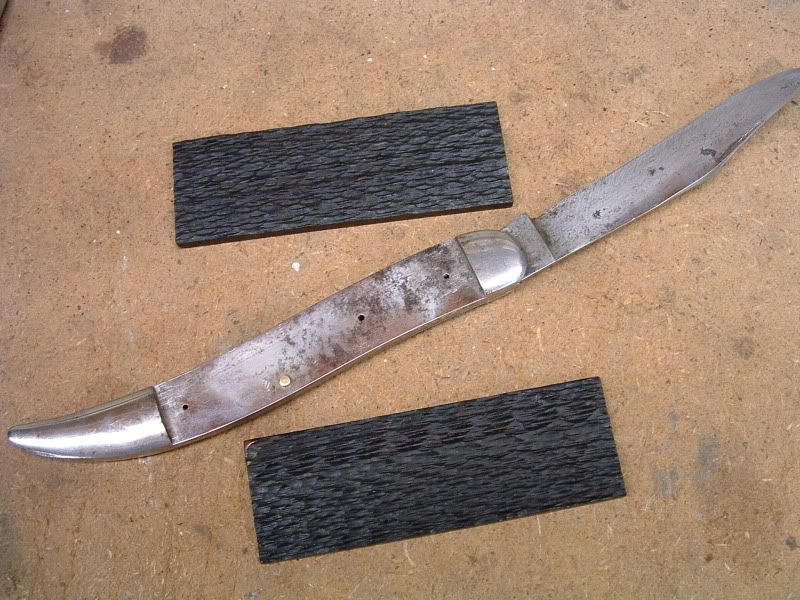

A little cleaning...
Picked out some nice Culpeper jigged bone scales:

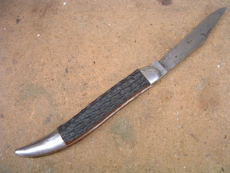

Scales are roughed and glued:
Finish work started:

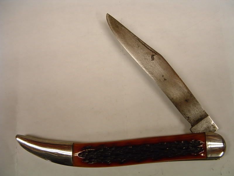

Final product:
The knife still has outstanding snap. Steel bolsters and liners, and took a wicked edge too. Oh yeah, that culpeper bone ain't too shabby either.

That looks awesome. What glue did you use?

trey wrote:That looks awesome. What glue did you use?
Trey
I used a standard 2-part epoxy (Which is at home, I don't remember whose), but like the rookie I am, I never sanded or cleaned the backs of the scales enough. After the dry-up, one of the scales came right off... :oops: I don't know what i was thinking.
Thanks for all the positive comments, this project was alot of fun. But I tell you, culpepper bone is not that cheap, so I was sweating a little when fitting it.
