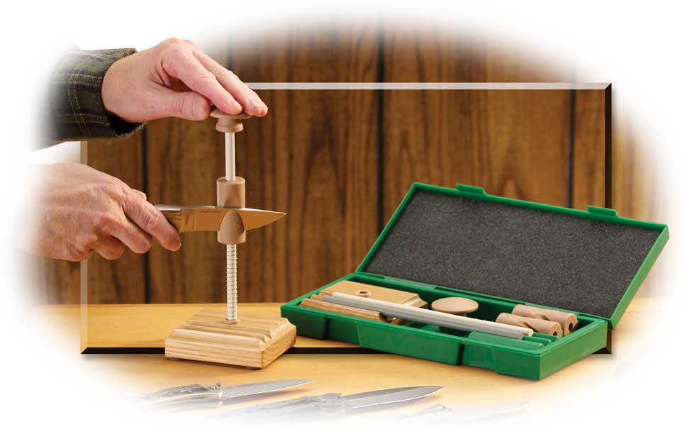

I just picked up a CRKT slide sharp for really cheap on ebay so I'll report on it after it arrives. I look forward to your replies.

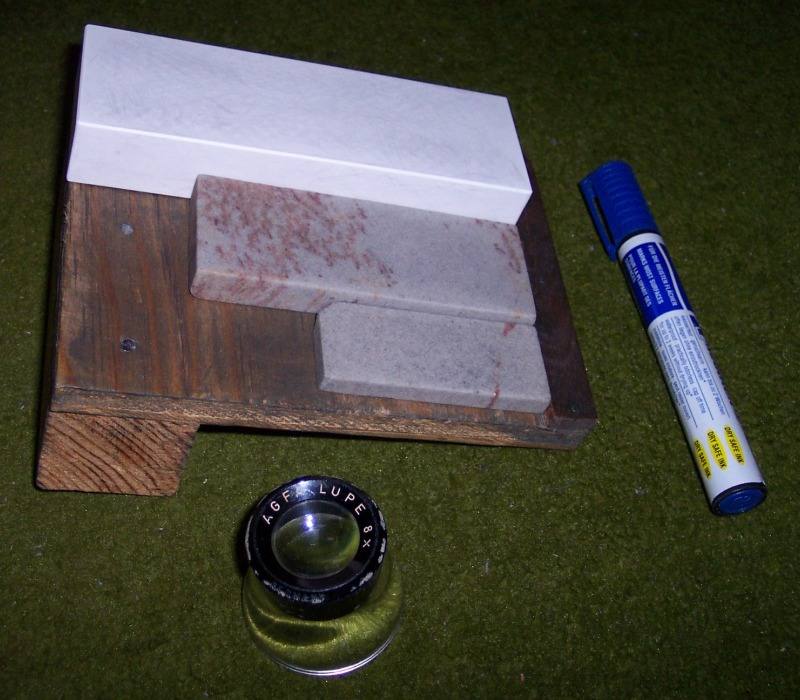

This homemade inclined plane holds a sharpening stone at 20 degrees, I can change the angle by putting a piece of wood under one of the ends. I find it intuitively easy to hold the blade of a knife horizontal as I draw it along the hone thus maintaining the angle. I like to make double bevel edges, such as 15/20 degrees or more acute.
The hones shown are: hard Arkansas, Washita and ceramic, I have others including diamond and some cheap coarse stones for reprofiling.
The marker is for painting the edge of the blade and see what is removed when passing along the hone (specially useful when reprofiling), the 8X magnifier also helps to see the edge condition and progress as it is sharpened.
For fast touch-ups I use an old set of ceramic Crock sticks. I also strop on leather or cardboard, for a fine polished edge I wrap a hone with paper, place it on the inclined plane and strop at the same angle as the edge.

Thanks for the replies. I'm still waiting on the slide sharp- should be here any time now & I'll report back.

Well after using the slide sharp over the last week I feel I can give it a review. I am not impressed. The rods do not fit firmly into the base so they sorta wobble a bit while you use it. The actual sharpening movement used is somewhat awkward, but is easier with a little practice. The coarse rod has a few imperfections in it, almost like tiny bumps here and there. I could put a better edge on a knife with a stone in less time.
I paid about $15 for it including shipping, so I'm not that upset about it, just not impressed. ::td::
