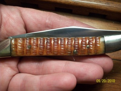

I just purchased this Case Tested Toothpick at a recent auction. The knife itself seems to be in almost mint condition but I have never seen handles with this variation of colors before. I looked in several of my reference books and came across a few tested knives with some reddish colors in the green bone knives but nothing close to this. Also the tang stamp is not exactly straight, the "TE" is out of line with the rest. Is this genuine or counterfeit? I am far from an expert and honestly have no idea. From my research it "appears" to be a tested frame and jigging but ?? [attachment=4]CASE TESTED TOOTHPICK 002.JPG[/attachment]Any and all opinions are always greatly appreciated. Thanks in advance![attachment=3]CASE TESTED TOOTHPICK 003.JPG[/attachment][attachment=2]CASE TESTED TOOTHPICK 004.JPG[/attachment][attachment=1]CASE TESTED TOOTHPICK 006.JPG[/attachment]

Counterfeit.
You don't need to look any farther than the jigging on the bone handles. See how the jigging lines up in straight rows across the knife? This jigging pattern is typical of counterfeit Case knives and absolutely diagnostic.
That stamp doesn't look good either.

Agreed. I've seen that jigging on tons of fakes and the "maker" (now deceased) used to live in this area. They aren't a bad knife for something to use as they are well made, but they never saw the inside of the Case Factory.

Great photos that when enlarged show the detail of a poorly done fake tang stamp and shield.
Sorry about your purchase, but congratulation on your photo skills.

You may want to consider carrying the knife. As I mentioned, they are pretty well made. That old guy should have worked at Case, but found it far more interesting to crank out the fakes. I don't think the maker himself made much money on them as I've seen them around the Eastern side of Cincinnati (where I live) pretty cheap (He is supposed to have lived in a small town 30 or 40 miles East of here). I've heard stories from guys that knew him and it's thought he had "ties" to folks at some flea markets and were they were moved that way. BTW, he used stainless for his blades and backsprings. Sorry I can't provide more detailed information for you. Just know that while it isn't a Case, around here it's a bit of local cutlery history and not a bad knife at all.

The shield is a little off center but has nice jigging!
