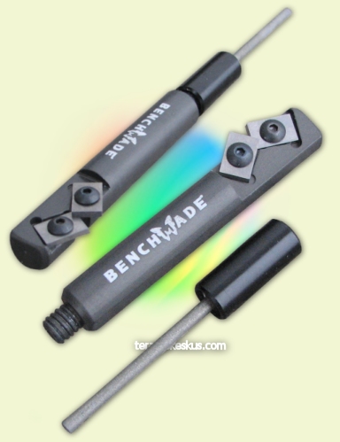

I wonder how these would do?.....anyone have any experience with these type sharpeners?
johnnierotten
So far,So good...So What!!
- jerryd6818
- Posts: 39458
Re: Best knife sharpening system?
Those "stock removal" units work just fine on the steak knives, just before company comes.
- Gunstock Jack
- Posts: 1639
- Joined: Wed Feb 27, 2008 7:59 pm
- Location: The "other" Washington
I've always been afraid they'd remove too much metal. They do work, though.
- johnnierotten
- Posts: 9303
- Location: Tucson AZ.
- orvet
- Posts: 19894
I have used the carbide "V" type sharpeners.
They are fine for garden tools but I will not use them on good knives.
I saw too many knives that people messed up with those.
Sometimes the knife blade will chatter with that type sharpener.
When that happens the edge looks like a do-it-yourself serrated knife, but very erratic and not at all uniform.
My nephew brought me some knives of his to sharpen and one of them was really messed up from that type sharpener.
I use one in the garden for my hoe & winged weeder (or a machete) but I won't use them on a good knife that I want to keep a nice straight edge on.
Jack is right, IMHO. Even when used properly they remove a lot of metal.

- johnnierotten
- Posts: 9303
I use a stone but just wanted to see what everyone thought about these type sharpeners....The first benchmade one looked pretty cool.
But after these bad reviews...NO THANKS!!
Thanks for the info guys...just another reason I love AAPK!!
