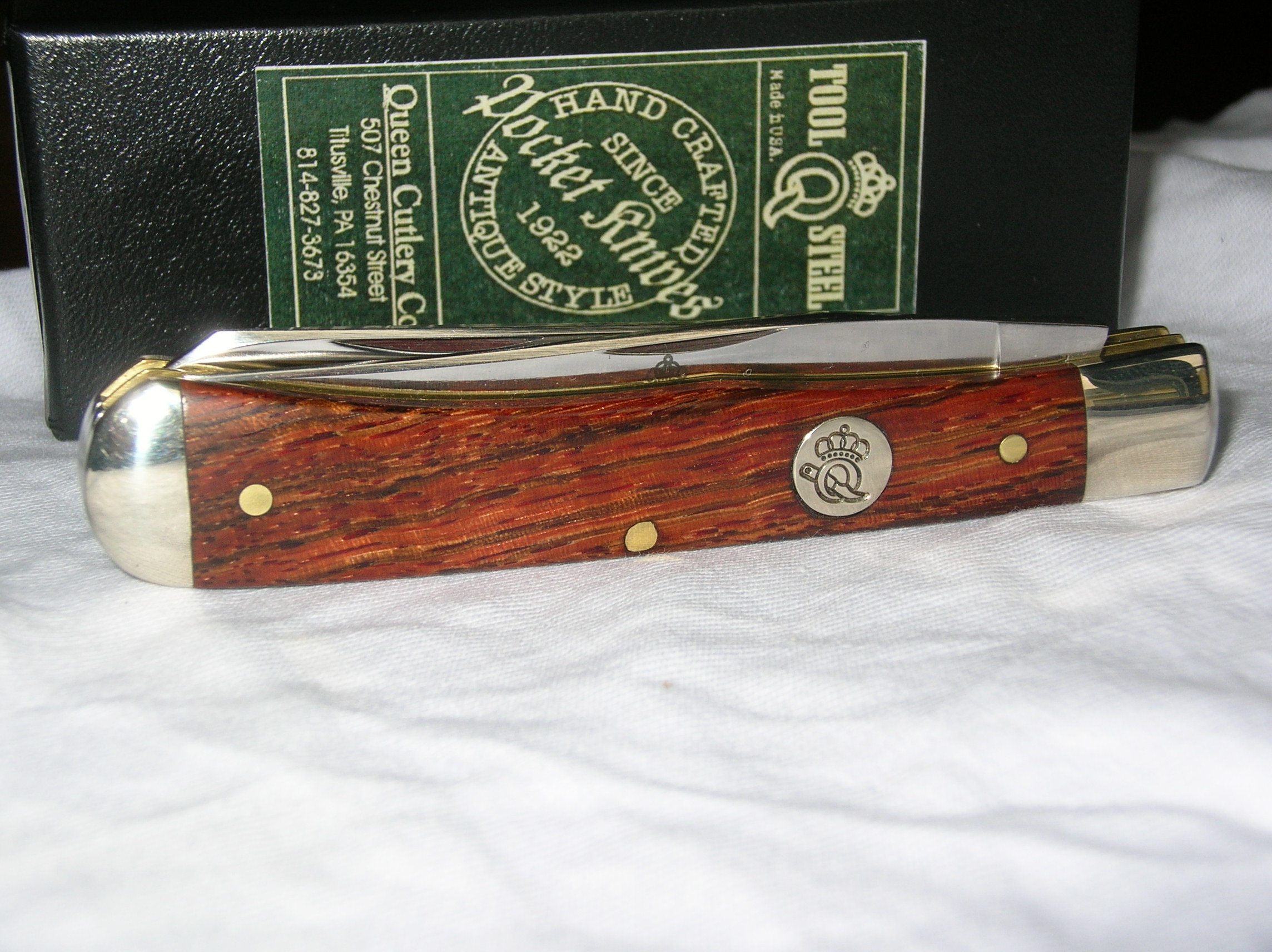

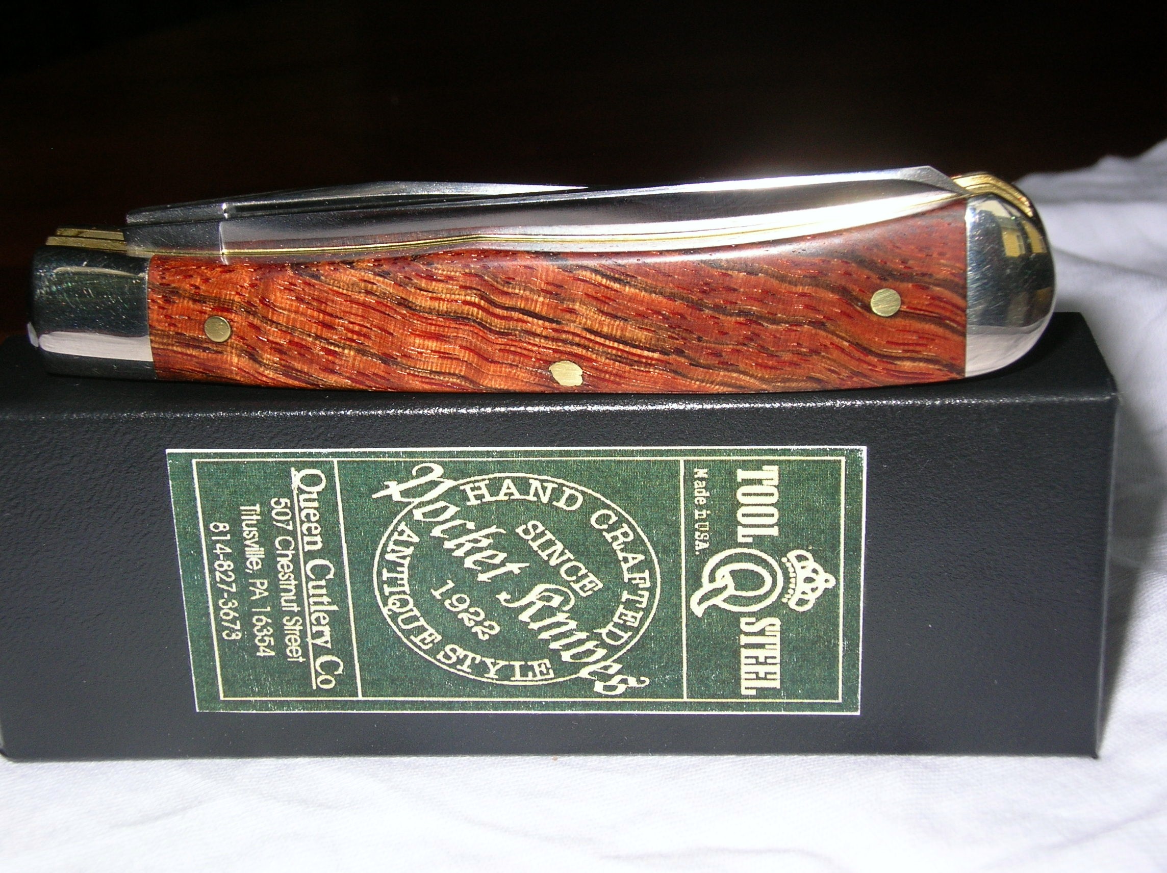

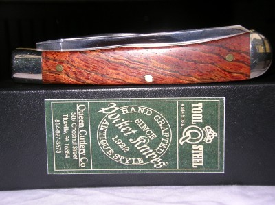

Okay, I have pictures of my refinished Queen Curley Zebra Trapper. I turned out GREAT!!!! It is done the way wood should look---oil finished. One problem---someone tell me how to attach pictures. I'll give it a shot here. I'll go out and come back in to see if they posted properly.

Re: New Queen CZ TRAPPER wood handle strip
WOW!! That does look nice. Congratulations on a job well done.
That looks GREAT Paul!
What kind of oil did you use on it?
Thanks for posting the pics.
It sure looks good.
It sure looks good.

The oil used was boiled linseed, three coats with 24 hrs between for drying. With all the different methods for applying oil finishes I decided to just keep it simple. But what an interesting project with lessons learned: 1, I wasn't sure how the oil would take to polished wood at the toon of 8000 grit, so I cut a couple of trial pieces from walnut and used the flats for different grits, 1500 and 8000. I also wanted to find out about any difference between "straight from the can" oil and an equal part dilusion with mineral spirits (sorry Kaleb, I had to deviate because of directions on the can and with so many brands and proprietary blends out there to choose from). I ended up choosing the equal part blend because it seemed to take to the wood a bit darker and I prefer that. I found a small jar with a lid and put in one tablespoon of mineral spirits with one tablespoon of oil, dipped a gloved finger wrapped in a rag and rubbed it into the wood for 5 minutes, wiped it off with a clean rag and flipped the knife over to do the other half. 2, in the end I was limited to use the 8000 grit polishing paper on account of the brass pins. It's pretty hard to isolate the pins from the wood to do two different grits, and therefore did not bother taping off the bolsters for final finishing. Thank you, Dale, for your coaching and thank you Kaleb for yours. It is as much a part of the results as the patience, sandpaper and oil that went into it, without which wouldn't have happened. Good memories in my pocket now.

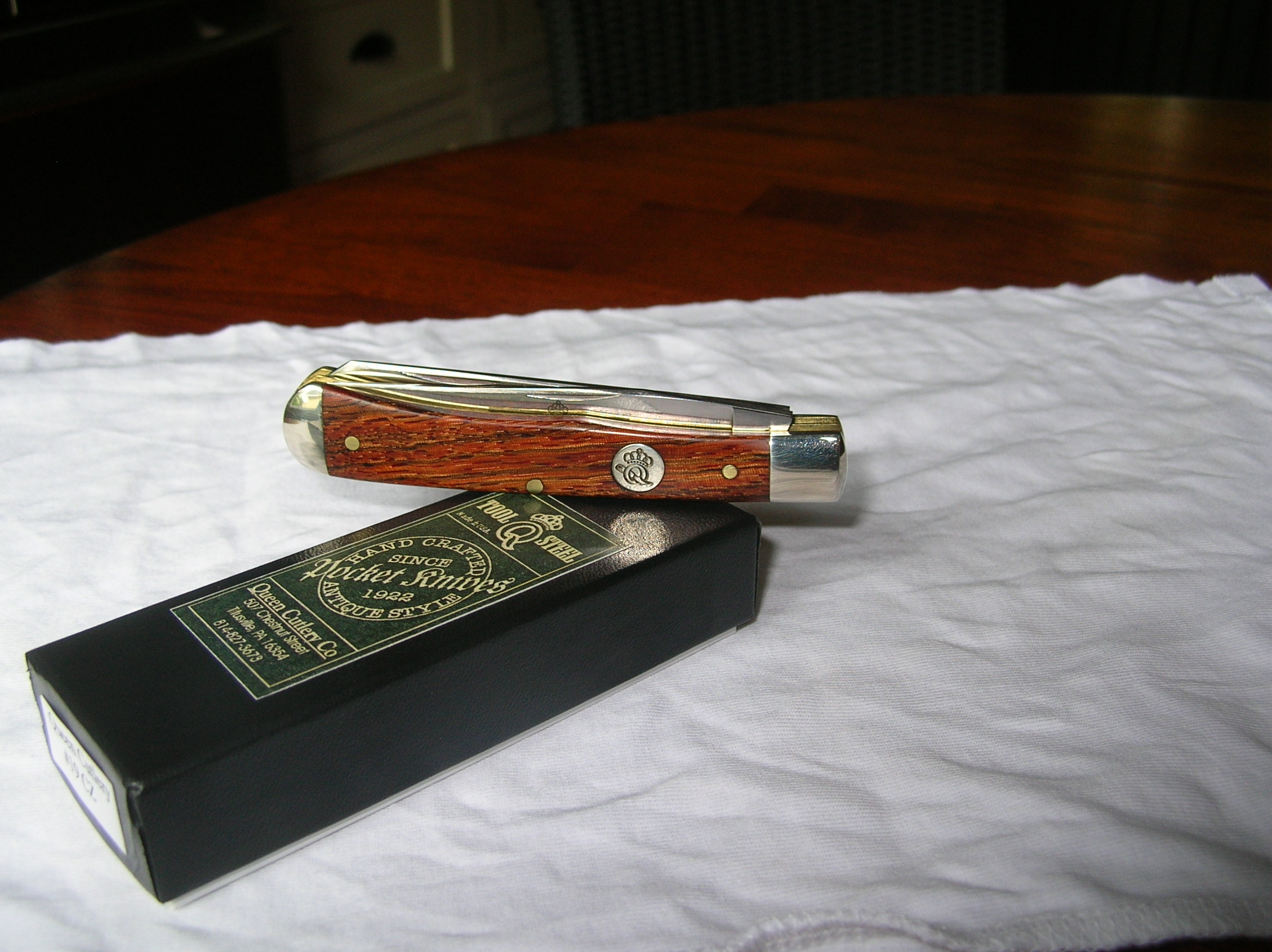

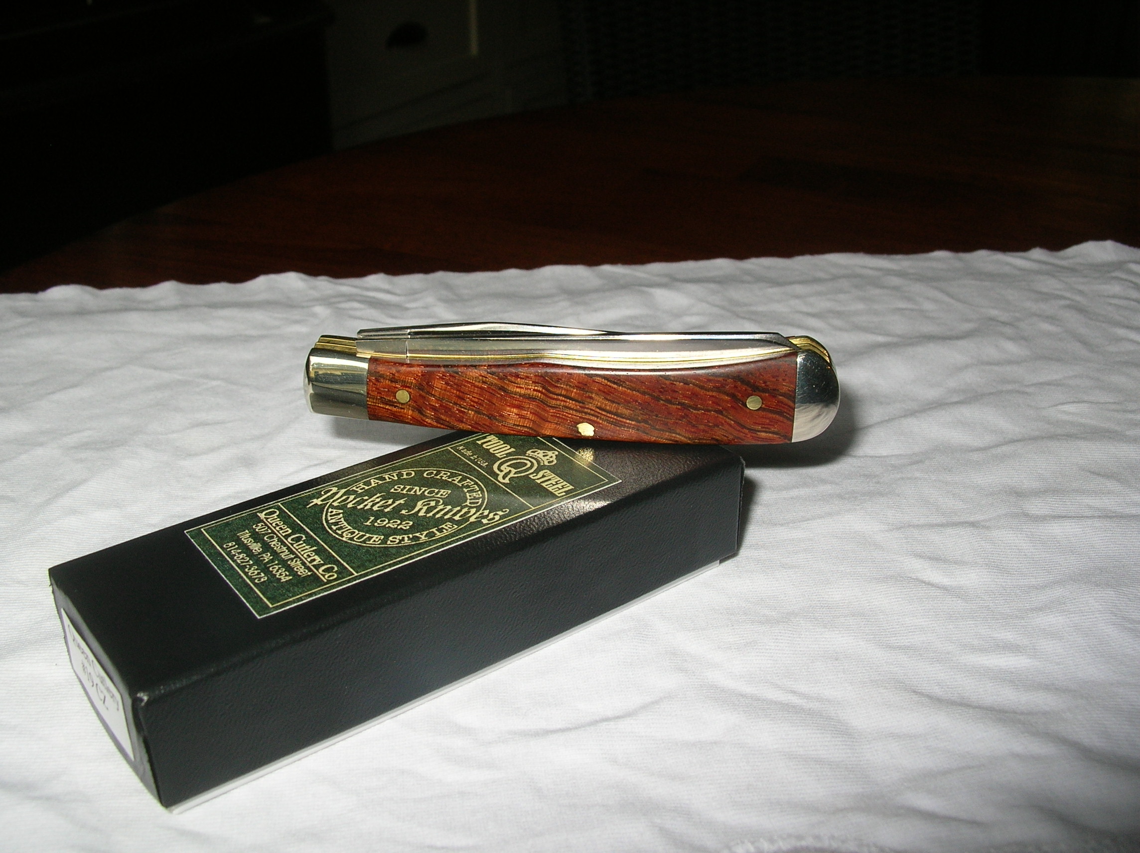

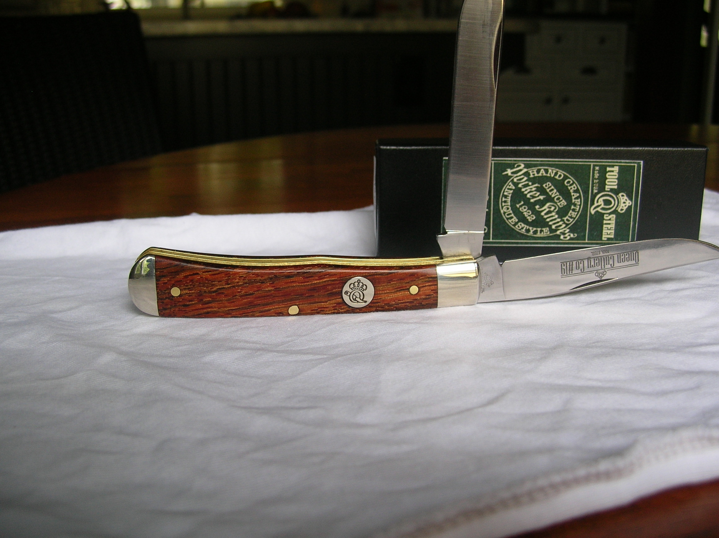

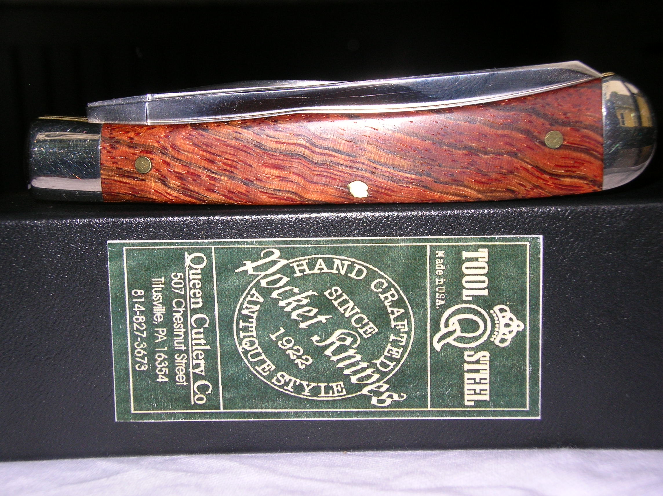

Why not. Here's more pics. You guys deserve it.
