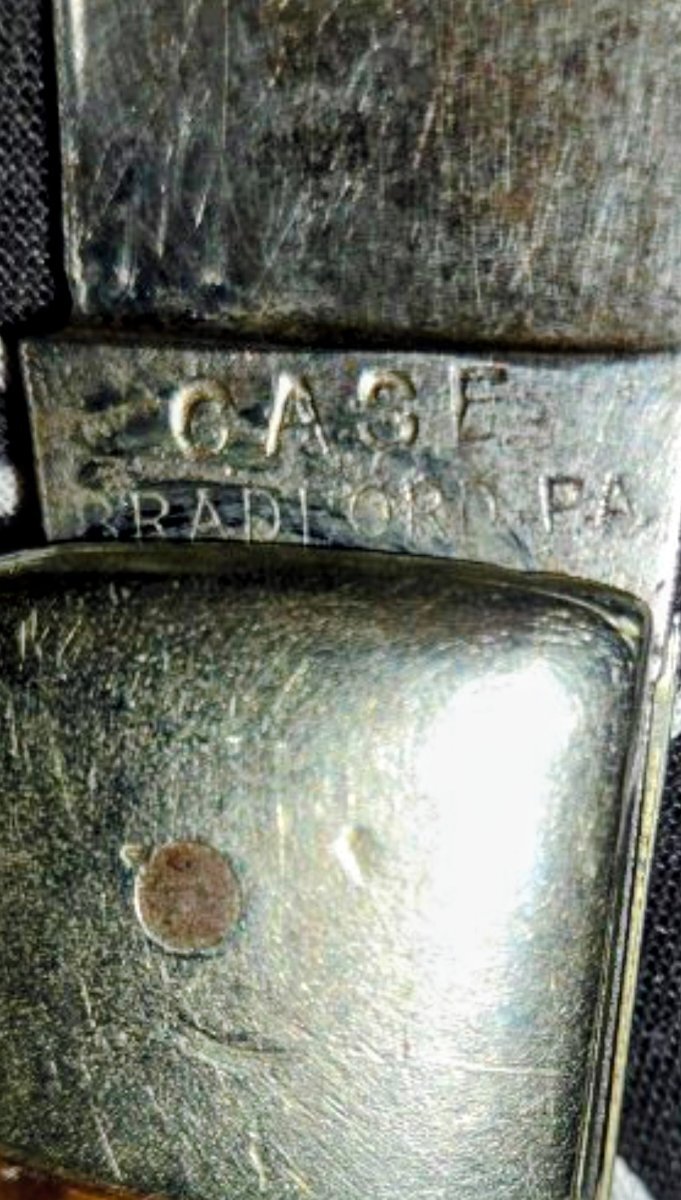

The blade was badly stamped with individual letters, apparently.

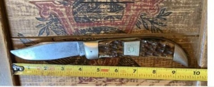

It's hard for me to tell if the stamp isn't uniform or if it is running uphill (so to speak)? Cold stamped or worn from opening/closing? Original pin?

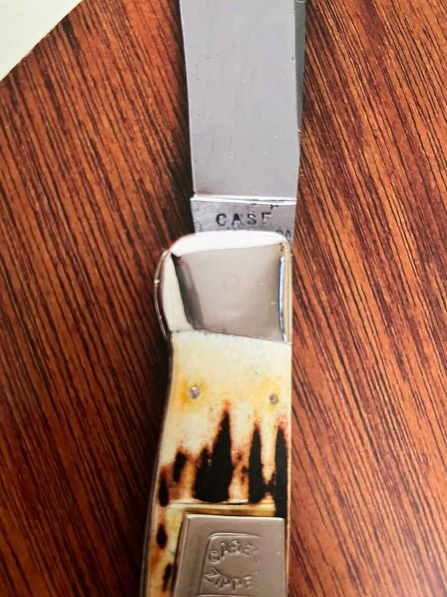

Is the pin suppose to be nickle silver, brass or steel? She didn't say whether she'd ever oiled it. I know I haven't. The locking mechanism works fine it seems, just the automatic action is too weak to shoot the blade out I believe. Looks pretty rusty inside from what I could see. Tell me what you want me to do and I'll do it. Type of oil? I always used old 3in1 on my carbon blades.
To me it looks like the letters are running uphill but I dunno.
Does anyone know how many of these knives are known to be in collections and documented? Im curious whether there are any examples with stamping done this way during manufacturing.

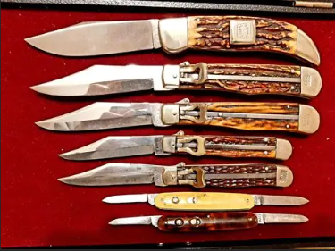

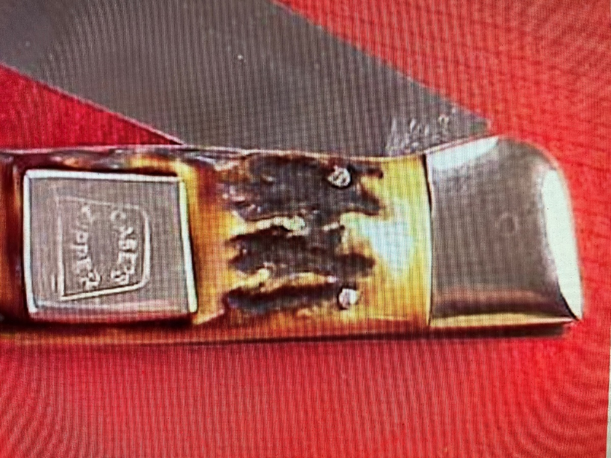

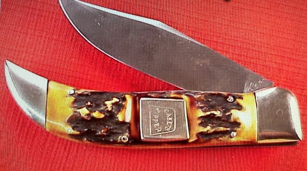

I see a few other Case 5172L's online.

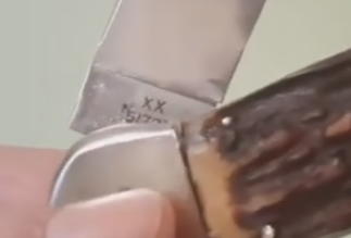

There's a youtube video of one, It's marked "XX" over "5172L" on the pile side of the tang (pics below). Video- https://www.youtube.com/watch?v=YXPnOdAhbs4
There's another on Worthpoint. The pictures don't show the tang stamps, but the description says "The model number is stamped on the backside of the tang "5172L". Link- https://www.worthpoint.com/worthopedia/ ... -415989622
The fact that the blade of the knife you posted has no nail nick leads me to believe that it was intended for a switchblade. Although many switchblades have nail nicks for different reasons, I'm specifically referring to the Case 5172's. All the manual Case 5172's and 6172's that I see have nail nicks, so that leads me to believe that the blade of your friends knife did not come from a manual 5172 or 6172.
I also noticed that the three other 5172L switchblades I've seen all have stag handles. Yours could just be an oddball with jigged-bone handles and no pile side tang stamp. Oddball, but still possibly authentic. Or, maybe Case made others just like. Either way, it's always possible your friend has an ultra-rare specimen.
As far as how many were made, I've read from different sources- less than a hundred, as many as fifty. But without official documentation or an official source from Case, how can one ever know for sure.

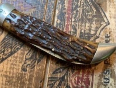

Here's the third one I've seen lately.

all very interesting. i really appreciate all of you spending some time to help us figure this out.
since the handle material was brought up i feel i should mention that my friend said one of the people she talked to about it before said that the most rare were those with green bone. i'm not sure who it was that told her that.
are there people that can "officially authenticate" these things? i'll do what i can with the suggestions you've offered. maybe a trip to antiques roadshow is in our future? i'm sure she'd get a kick out of that. lol
okay, i'll post an update after i hit it with a little oil and check the pin with a magnet. wish me luck!

So it seems the stamp is 100% correct?!? Just odd there isn’t a rear marking on the ricasso. Maybe a prototype?
The bolster shows no file marks or damage around the pivot pin on either side

Very interesting stuff...Exciting! Pin looks to be steel. Magnet was strong enough that its able to reach through the nicklesilver into the internals but the pin is noticeably stronger so it has to be steel. Oiled it up, cleaned the inside a little with paper towel. Pretty dirty but the rust doesnt look too terribly bad. The spring seems like its been over sprung, will only pop out about an inch. Very weak. Maybe from people trying to pull it open manually that didn't know its an automatic? That would explain the blade peek for sure.

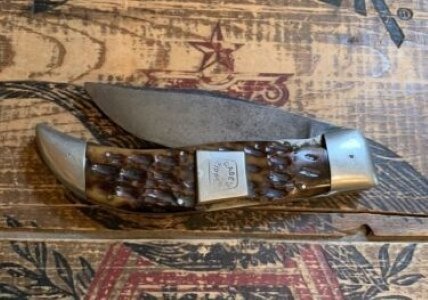

The one below appears to have jigged bone handles.
You can always contact Case and see what they say. I'd be surprised if they provided any information, but it's always possible. They have a phone number on their contact page- https://www.caseknives.com/pages/contact-us
