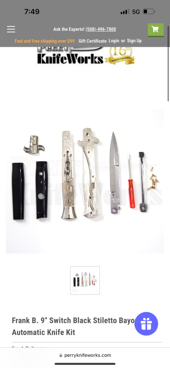

I’ve tried to look at quite a few different styles like the standard 9 inch swivel bolster knives and ones that use a picklock similar to a older flat guard frosolone style knives but I don’t own a pick guard style knife like that to take apart but I see that being easier to make then some other styles due to the solid bolsters and other parts of their construction the knives I do have to take apart and copy are a Frank b with swivel bolster and a edge co with swivel bolster and I’m looking at buying this 9 inch Frank b kit from Perry knife works but it’s built different then other knives I’ve see where the locking tab is in two pieces that I havnt seen on other knives if you think one of these would be a good starting point over the others let me know and if you have a style of knife you recommend I start with trying to make or researching I really love your leverlock knives and trust your judgment on this thank you bill

This is the kit I’m speaking about I haven’t seen the two piece locking bar I’m assuming it’s for easier machine production

i would not waste your time on that kit its parts are made mostly of zinc i think and not that great of quality , i would use a real Italian stiletto or practice on a china made stiletto .
