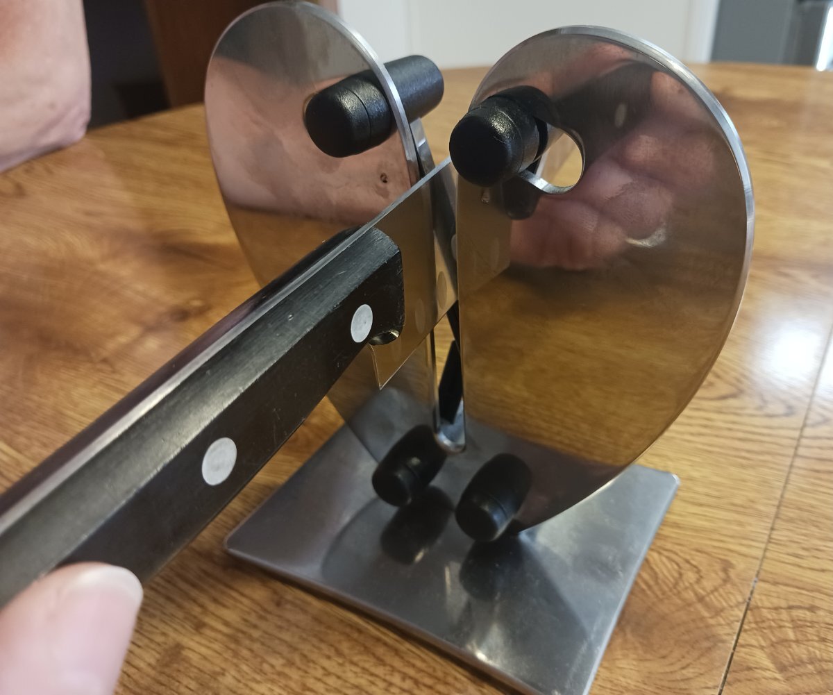

Post by OLDE CUTLER »
I got this one as a gift a couple years ago. It is from the Sharper Image catalog. Weird thing about it is the angle of the sharpening surfaces can change depending on how much down pressure is exerted. My wife uses it occasionally on large kitchen knives. I won't let any of my pocket knives even see it.
