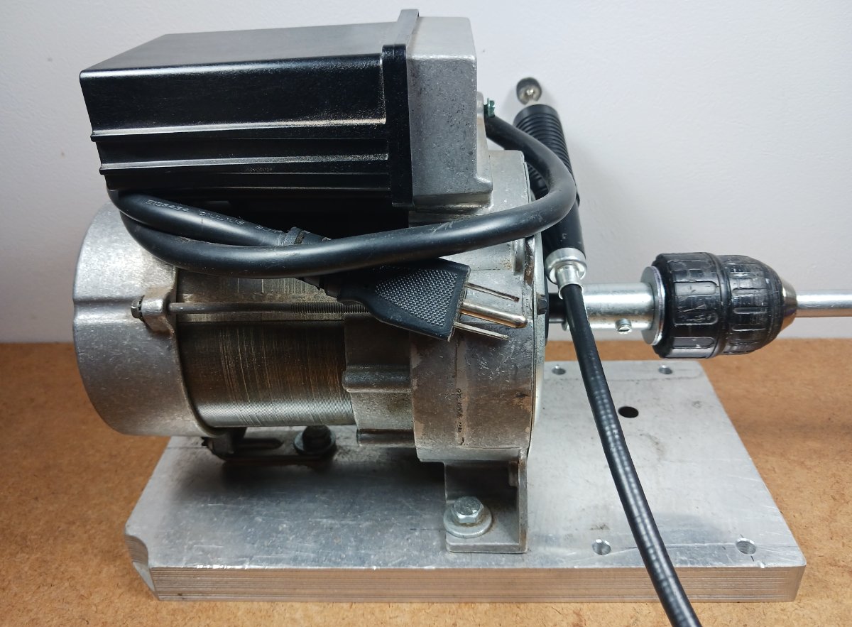

I have had this motor sitting around for a while and decided to put it to work. It is a 1/2 HP, 3450rpm with a 1/2 inch shaft from a Jacuzzi tub pump. A 1/2 inch mandrel with 1/2 X 20 threads was attached and a used keyless chuck from an old cordless drill was attached to that. Now I have the option of using a 1/4 inch mandrel with buffing wheels or a 3 foot flexible shaft that takes Dremel tool accessories (shown in pic).

Cool! I like making tools!OLDE CUTLER wrote: ↑Sun Dec 01, 2024 8:05 pm I have had this motor sitting around for a while and decided to put it to work. It is a 1/2 HP, 3450rpm with a 1/2 inch shaft from a Jacuzzi tub pump. A 1/2 inch mandrel with 1/2 X 20 threads was attached and a used keyless chuck from an old cordless drill was attached to that. Now I have the option of using a 1/4 inch mandrel with buffing wheels or a 3 foot flexible shaft that takes Dremel tool accessories (shown in pic).

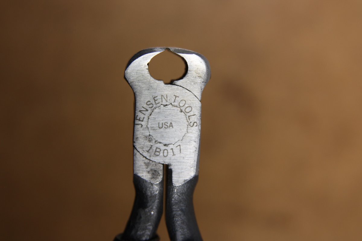

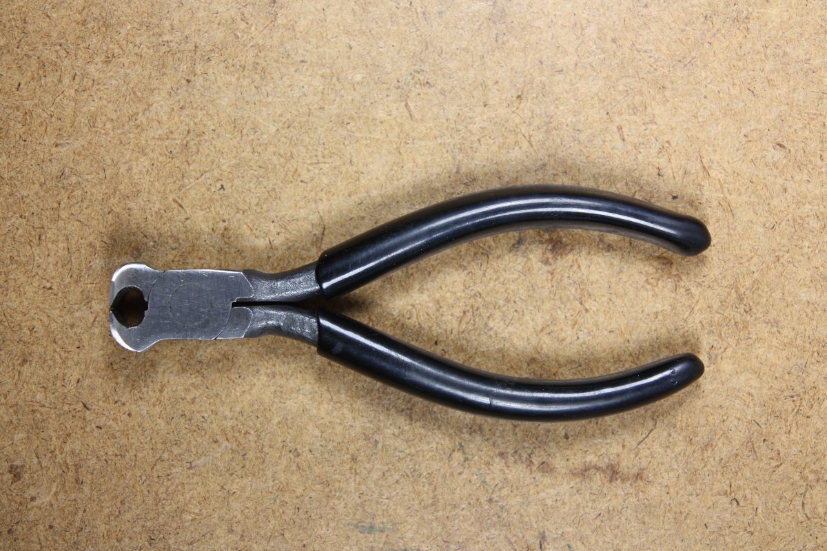

Wondering if anyone has any recommendations for a replacement of my old Jensen Tools 1B017 flush cutting nipper? This one belonged to my dad, so it is old indeed but has served well. Are there any American made pliers of this type still being made? It is 4 and 3/4 inches overall.

Re: Shops, tools, materials and tips
I did a search for them on eBay and it appears Channellock makes them.
Also check Xuron.com. They make all kinds of small hand tools. My ex-wife's uncle started that company years ago....made in Maine.

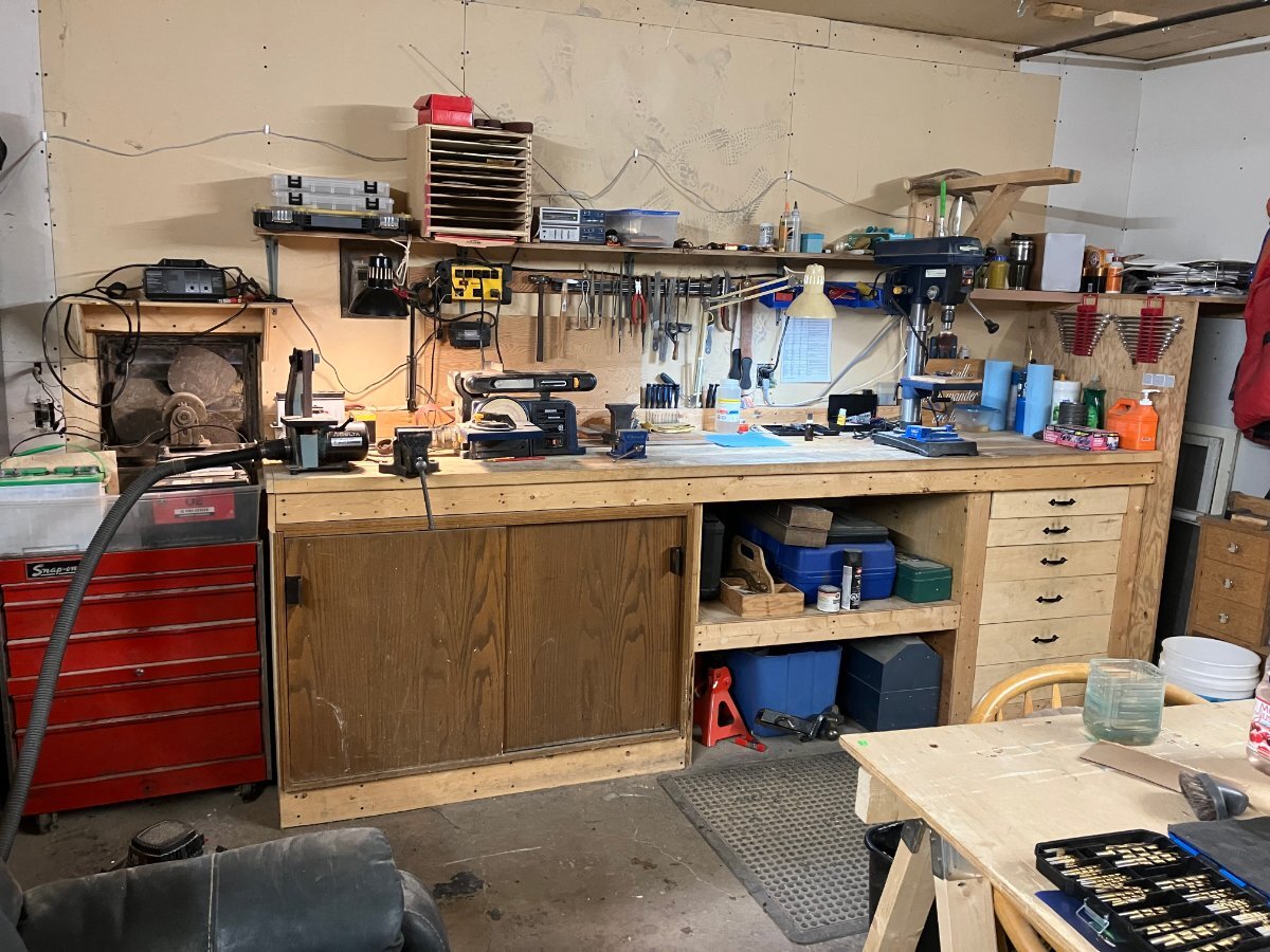

Thanks Wayne. It is a tad short on tools, compared to the rest of the posters on here, but, what I have work adequately.
Dan

That is a pretty nice setup! Not too large and area, yet well-stocked.

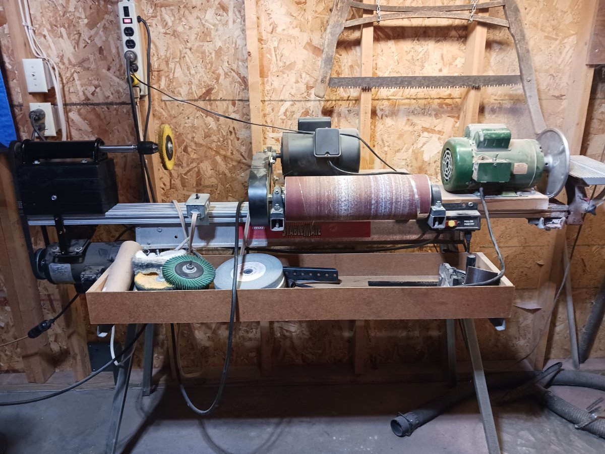

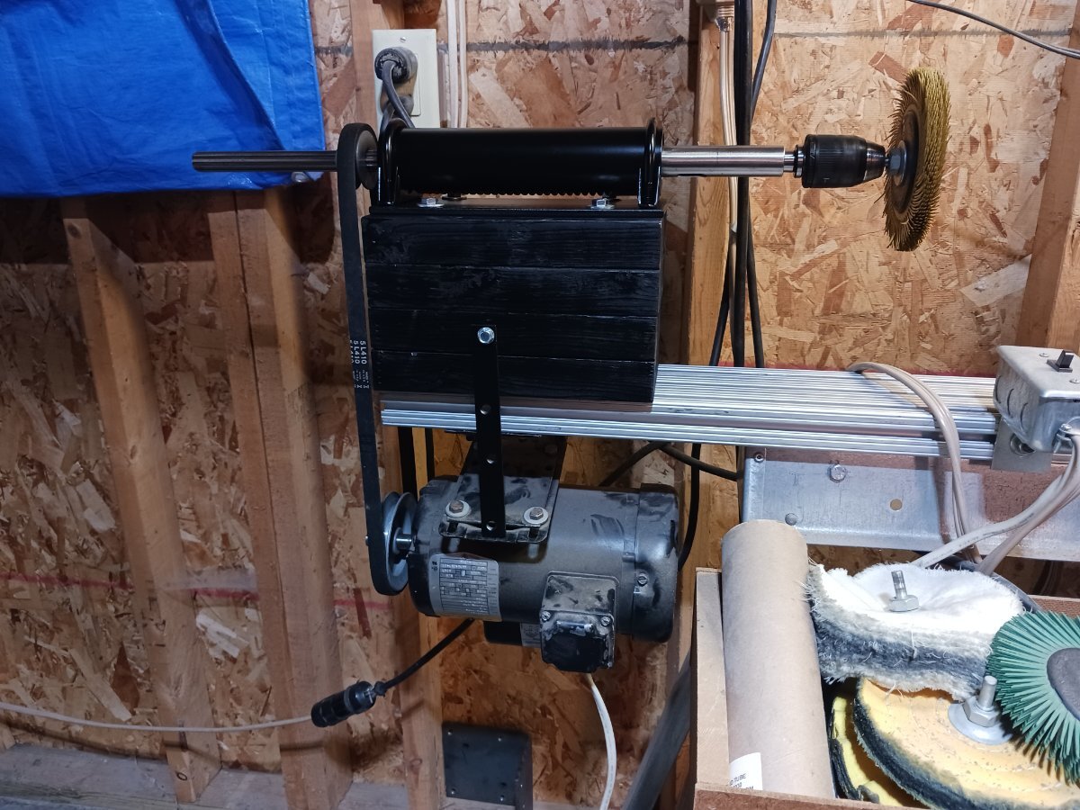

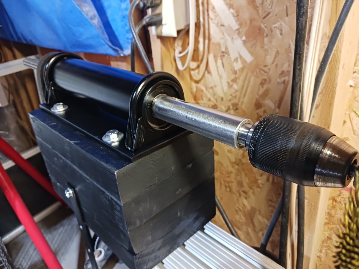

I had been using my Jet mini lathe as a power head with a drill chuck on a #2MT to turn various brushes, sanding drums, and buffing wheels. This is less than ideal as it puts wear and tear on a wood lathe that isn't needed. Then the other day I was looking thru my pile of salvaged parts from old power tools from my last job before I retired. I found this quill from a heavy duty drill press, with bearings, and a #2 MT. So I rigged up a mount for it with a piece of 4 x 1/4 inch steel and 2 muffler clamps. The riser underneath that is for now some 2X blocks to bring it up to a comfortable working height. Everything on my "work center" is salvaged from old power tool parts. 9 inch disc sander with 1 and 1/2 Hp motor, 4 x 16 drum sander with 1 and 1/2 Hp motor, and the power head has a 3/4 Hp motor. Now that the snow has melted here, I will check out our local steel scrap dealer for some steel tubing pieces to replace the 2X lumber spacers.

We use what we have, right? Nice setup, OC.
danno, I like your shop setup, but it looks too clean and organized!
