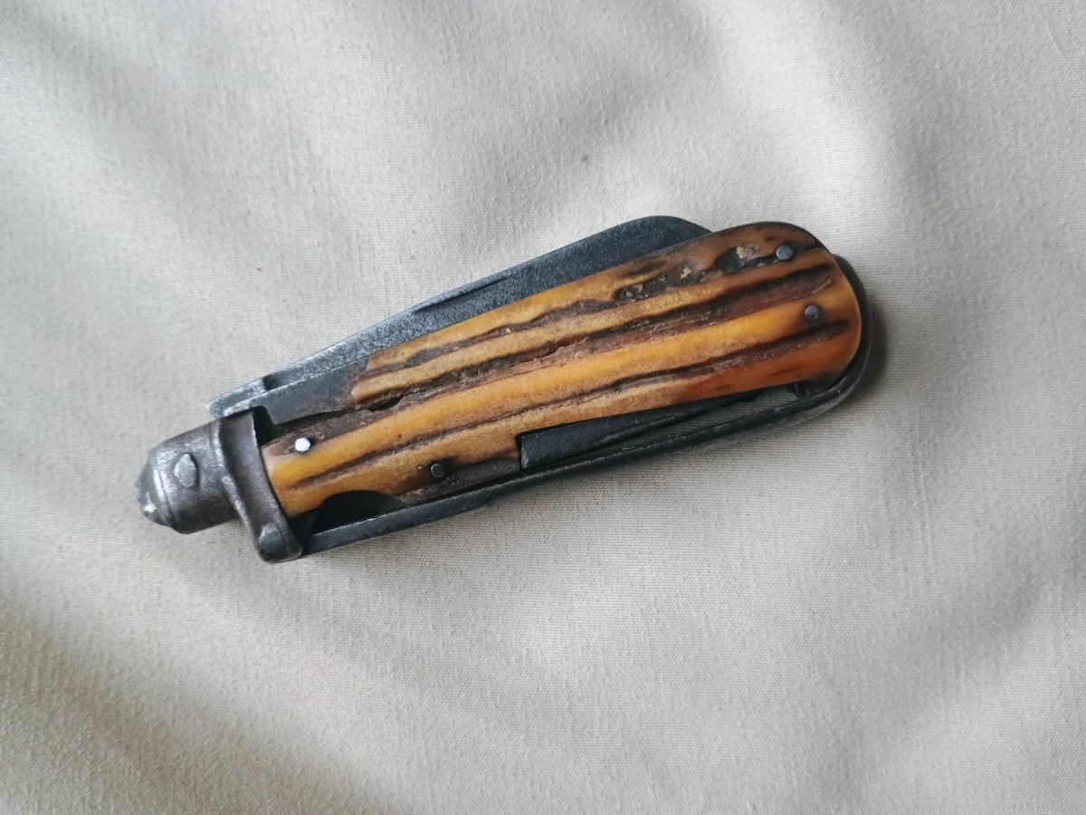

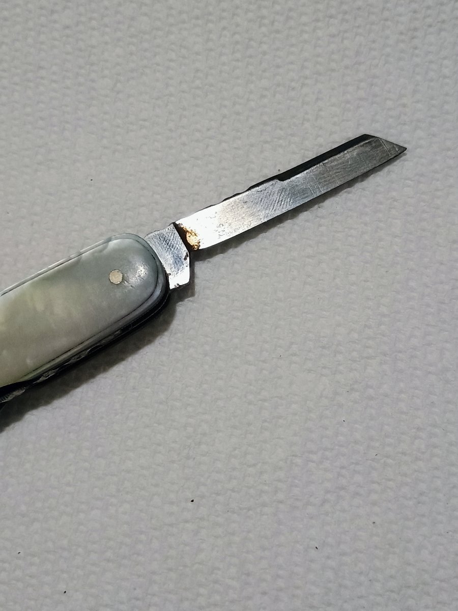

Post by new2knives1568 »
I have two knives that have some rust on them. I would love a gentle and not harmful way to remove the rust. For starters is my Brookes and Crookes file worked four blade. It is in alright condition but has some rust almost a scarlet red color by the tang of all the blades, some are worse than others of course. This knife I would especially like to be careful with when getting rid of rust. The other one is the Irving cutlery co 7 blade horseman knife I carry on a daily basis, about a year and a half ago I was recklessly cleaning horses water buckets and got some on it. It seems when it gets really hot and humid the stag that got wet some time ago gets discolored (but goes back to a beautiful hue when the weather is better) and a little rust shows up in the corner which I normally take care of. I would love some advice on rust treatment as both issues are slightly different but need to be addressed. I would also love comments on the knives in general, especially the Brookes and Crookes knife I don't know what to think about it as it's clearly not an exhibition knife but also a little nicer than a normal mop.
new2knives1568
Posts: 12
Joined: Tue Dec 31, 2024 7:35 pm
Re: Treating rust on old knives
I would also love to hear about how people take care of stag, specifically on an EDC knife.

Same advice you were given when you posted them a couple of weeks ago. Sharpened end of a lead pencil will remove rust without harming the metal. Some Tuf-Glide or RenWax, applied as directed on the product, will prevent rust reoccurring. RenWax will preserve and protect stag.

Thank you so much, I have used renwax on my knives now, tried the pencil thing on an old knife I didn't care about, I didn't see a lot of results just a mess of graphite. Is there a specific trick to the pencil lead thing?

Ideally use the pencil lead to clean off rust before applying anything like oils or RenWax. Rub the graphite (pencil lead) on the rusted area as if you’re scribbling on it. Wipe off the residue with a soft cloth. Examine the area and redo it if needed.
If that doesn’t remove the rust you have something more going on.You may need to clean the knife using lukewarm mild soapy water and/or a mild solvent (isopropyl alcohol or mineral spirits). Rinse and dry it thoroughly with compressed air and be sure all water is out of the joints and spaces between the liners and springs, etc. WD-40 is a good water displacer (that’s what “WD” stands for in the name). After everything is thoroughly dry, oil the joints, apply the protectant to blades and covers, and you should be good.
Recommend taking some time to read through the posts referenced here before you proceed further. As you will learn there are many methods depending upon the degree of cleaning your knife requires. Techniques and materials more aggressive than the aforementioned risk removal of metal and damage to the knife. Proceed with caution - metal removed cannot be put back.

The first time that I tried a pencil, I expected for it to leave the steel nice and shiny.
It does not. The pencil lead will scrub away the active rust, but the metal will still be stained from it. The pencil will not clean off the patina, which is an oxide layer that actually protects the steel (similar to gun bluing!). It will leave the metal looking brown or grey, but that is actually what you want in an old knife.
