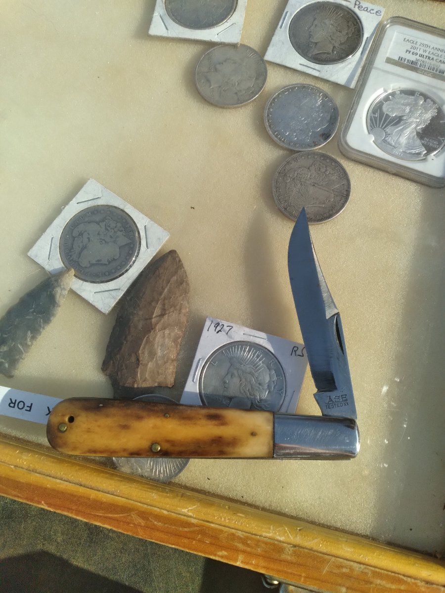

Added a pic. I stated earlier that it had "red bone" handles, which obviously they are not. Sorry. Looked at too many knives that day. But this shows the Case Tested tang stamp on Saber blade. The back of side tang of blade was blank.

The frame may be an authentic Case frame, but the blade is a replacement and is fake - not a Case blade.

That blade looks way too aggressive for "Case" or "old."
