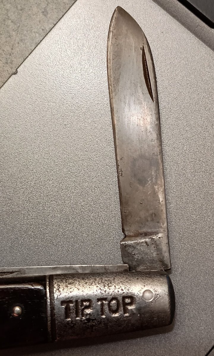

Any grinding, sanding, or polishing on a blade can deteriorate the value, as you are removing metal.
If you are okay with that, it can improve the looks.
I had this Camillus Tip Top in my pocket today. When I got these blades they had been cleaned with a Dremel sanding drum and they looked horrible! I was able to sand out the divots and scratches, gave the blades a good patina, and they look like they should: old blades with moderate wear. But you can also ruin blades the same way. I have caused grooves with the edge of a belt, and once the metal is removed you cannot put it back.
It is entirely up to you, and you can either improve them or make them worse.
If you choose to clean them up, I recommend using sand paper taped to some flat boards, and hand sanding them. It will take longer but you can expect better results.
