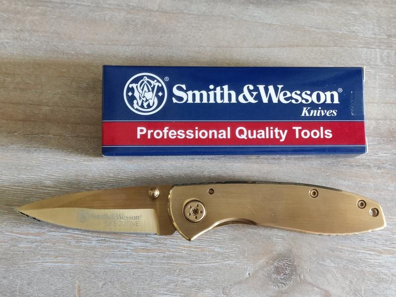

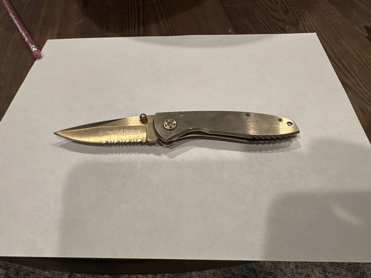

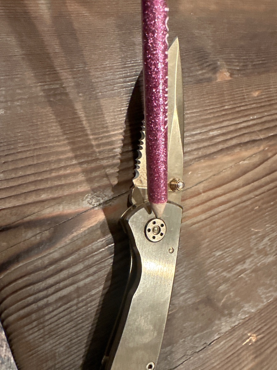

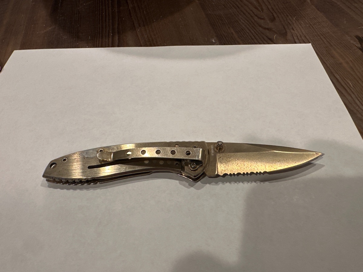

My son bought a SW Executive gold knife at a thrift store. It appears a bit dull, there is some rust but not too much, and we will need to tighten the bolt that holds the blade. I have two primary questions:
1. Where do I find the tool to tighten the bolt for the blade (see pic 1) 2. How do I polish and restore the gold finish on the handle and blade? I am worried that using typical materials like wet sandpaper, solvent, and metal polish may remove the gold finish all together? Below is a pic of the knife we have (pic 2 and 3)and a pic of the knife as it should look (pic 4).

I did notice that in the “How it should look” picture, the pivot has a Torx screw in the middle but yours doesn’t have one.
Is there a Torx screw on the other side under the pocket clip, by any chance?

I would polish it by hand using something like NeverDull, Flitz, or Mother's Mag polish.
As for the pivot screw, I have not seen one like that before.

I don’t have any gold knives so I’m no expert. But if the gold finish is an anodized coating, metal polish can take it off. I saw that happen to a Kershaw Sapphire a guy was cleaning at a knife show. So you may want to test a little spot before applying to the entire knife.

I beleive thats a gold tint Titanium coating, in case that helps.

Does the nut on the clip side look the same? If not, remove the clip and tighten from that side. Would the #2 pencil treatment remove rust but not the titanium coating?

I would agree that the gold is a titanium coating. Supposed to be a satin finish; not polished. You would need a special face pin spanner to tighten the pivot nut, but you coukd improvise one by taking a pair of right angle needle nose pliers and grinding the tips to fit the holes.
