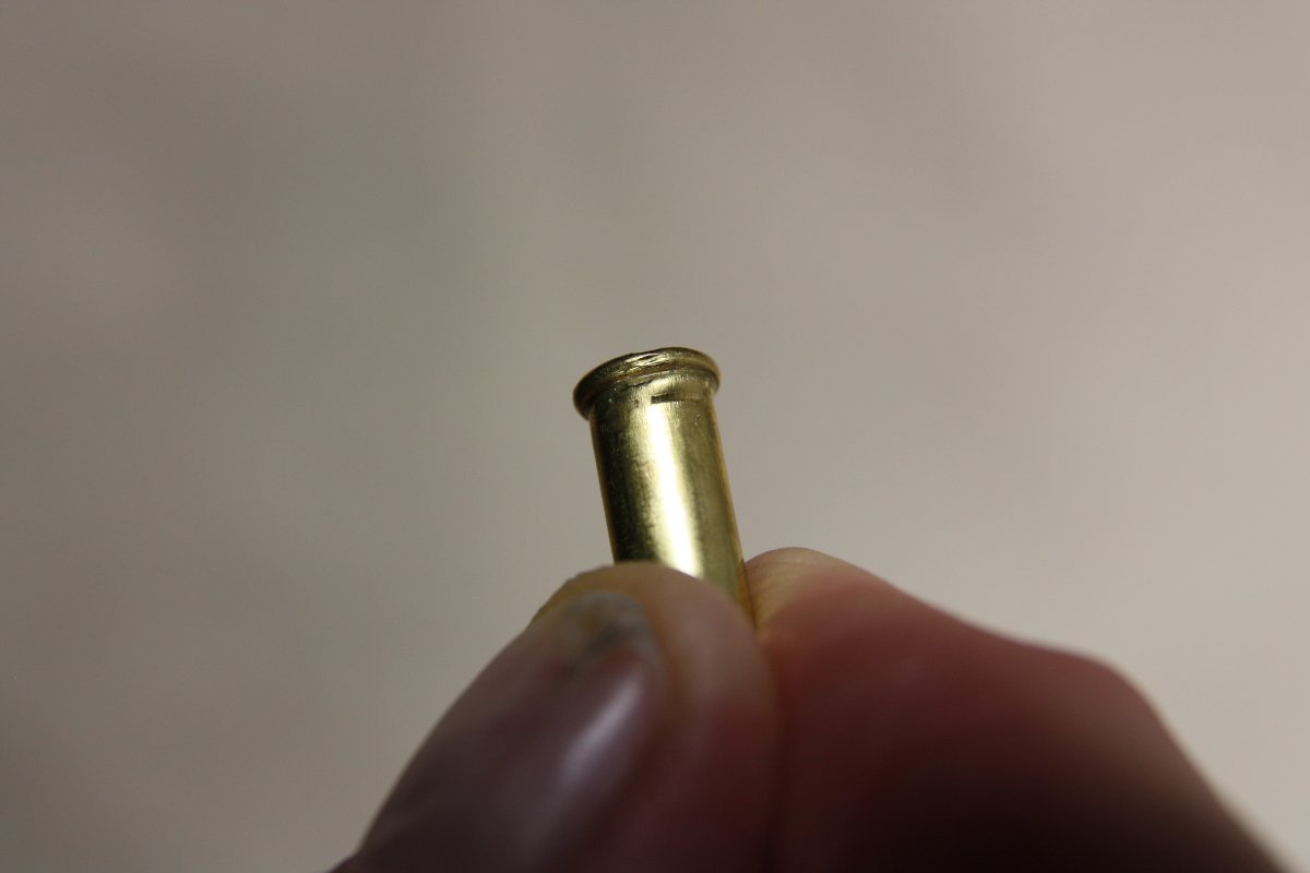

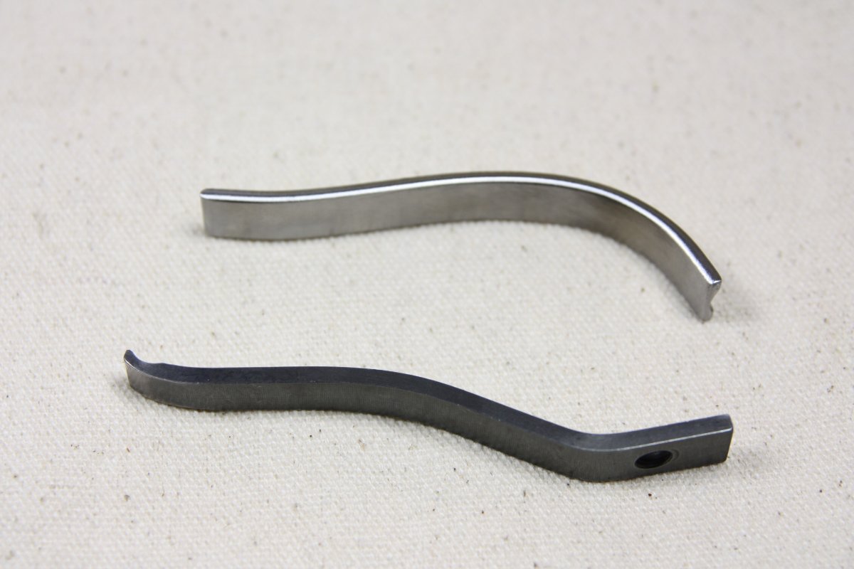

I was able to fix a couple of issues relating to misfires with the Stevens 44 I pictured above. As I mentioned, it was someone else's project gun before me, and I believe it was either a 25 or 32 rimfire that was being converted to 22 LR by relining the barrel. The firing pin has to have a little work on it to strike in the correct place when doing this conversion, and the previous owner did not have success. So I ended up making a new firing pin from 3/16" rod, and after studying the mainspring and how it worked I discovered that a new mainspring had been installed, but an incorrect one. This is an early model 44 and it had the later spring which has the wrong shape. So having some 1075 spring stock on hand that I use for knives, I also made a new spring. Now it shoots great. It does have some worn internal parts, so I will be shopping for those spares at the gun show here in 2 weeks.
New spring I made at top, incorrect spring it came with bottom. New main spring installed

OC, you are amazing. Great work. And great save.

OC, that is a fine old Stevens and an outstanding save for the old gun by converting it to 22lr.
