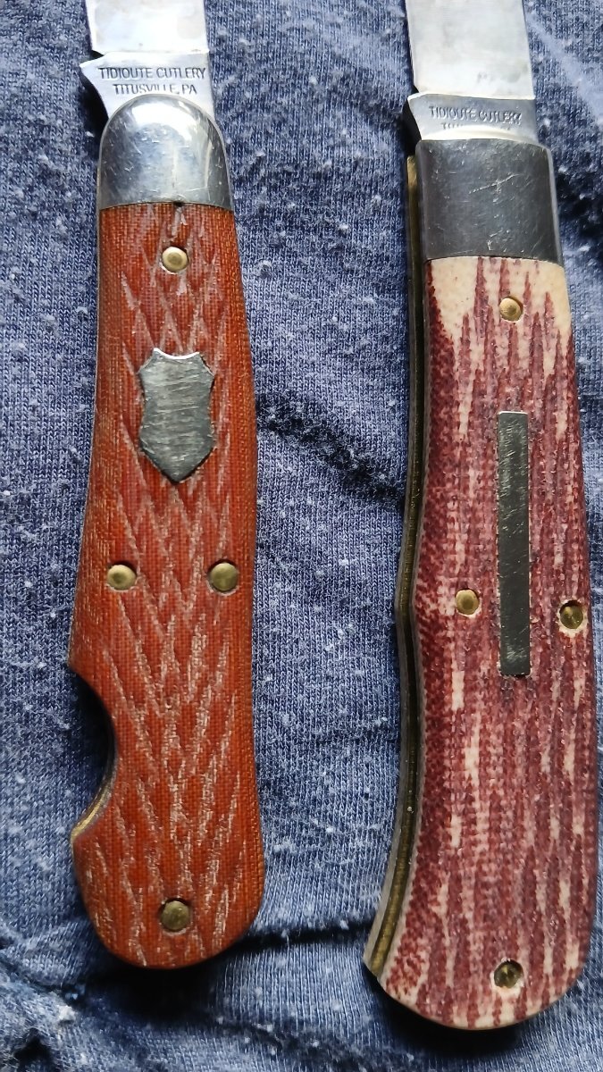

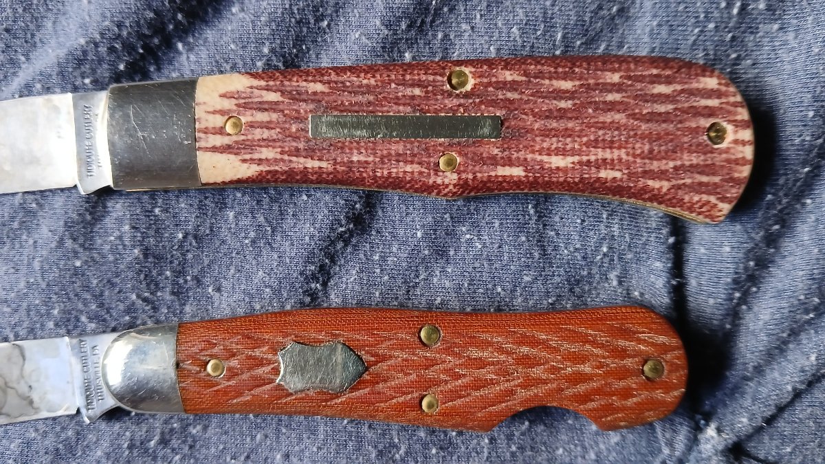

Here is jigged linen micarta, and jute micarta first. Then one in OD green no jigging. To me it is much less slick than G10, and has better grip texture. Also like the varied material it comes in like canvas, paper, burlap, denim etc. Much better feel in hand than any G10 I have or have seen. The jigging helps make a better surface for gripping.
