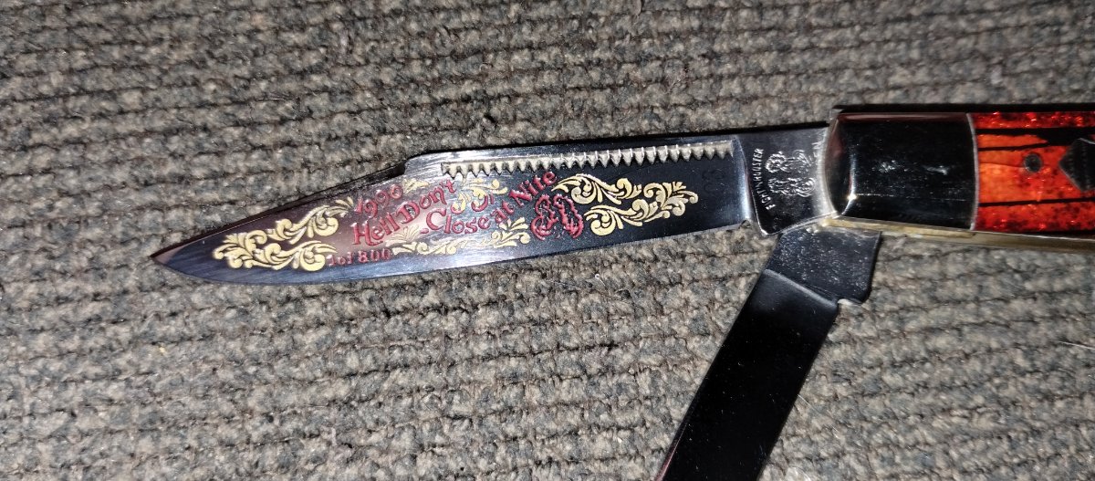

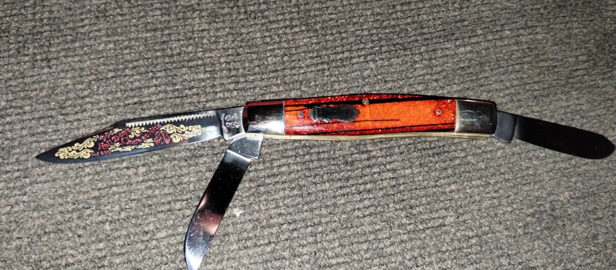

Hell Doesn't Close At Night 1990 1 of 800 on the main blade. It has several cracks in the scales. What causes those cracks besides dropping the knife or something like that. I've babied it for 20 years and it's gotten another crack or two since I have had it.
philco
Posts: 15543
Re: 1990 Fight N Rooster
Post by philco »
The handles on that knife are celluloid. Celluloid is notorious for breaking down chemically and giving off caustic fumes that can and will damage metal knife parts. One visual clue that "off gassing" or "gassing out" (terms used to describe this chemical breakdown) is that the handles begin to shrink. When they shrink, frequently cracks develop, particularly in the vicinity of the pins that attach the handle material to the knife frame.
There are numerous threads on AAPK where the breakdown of celluloid and it's damaging results are discussed. There's no known way to stop this chemical breakdown once it starts. About the only viable option is to remove the handles to protect the frame and blades. Lots of folks have dealt with this problem and have installed new, stable handles in order to salvage the knife.
I'd encourage you to promptly remove this knife from any other knives you may have it stored with. As with bad apples, one out gassing knife can (and will) spoil the whole bunch.

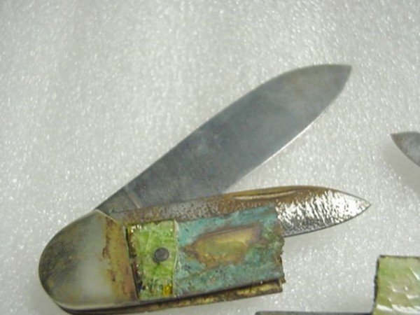

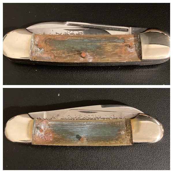

Isolating your 2 Roosters will save the rest of your collection but will not stop the damage that has already started. Below I'll share advice and pictures from my Fight'n Rooster outgassiing knife thread.
Mumbleypeg wrote: Thu May 16, 2024 6:45 pm Yes, that is an early sign of outgassing. Once it begins I know of no method to stop it, short of removing the offending covers. Fight’n Roosters and other German-made knives of the past 30-40 years are notorious for outgassing. Ken
this is a picture of my FR Waterfall cannitler after removing the scales and attempting to clean the corrosion
Reverand wrote: Fri May 17, 2024 3:09 am Now that the handled are gone, scrub the knife with baking soda and an old toothbrush.
orvet wrote: Sun May 19, 2024 3:19 am What Scott said is true, scrub it with baking soda and water and then dry it out well. I used compressed air to dry knives that I've cleaned.
Miller Bro's wrote: Sat May 18, 2024 9:14 pm Here's my knife, let yours go too long and it will look like this one ::disgust::
Hope this helps. I'm going to attempt to rehandle mine myself. If you don't feel comfortable trying to rehandle your knives, search AAPK for knife mechanics that can do the job for you. Three I found, but have not contacted, are Kaleb Reynolds(AKA "muskrat man"), Gary Claxon, and Bill Deshivs. You can find examples of their work by searching by member name.

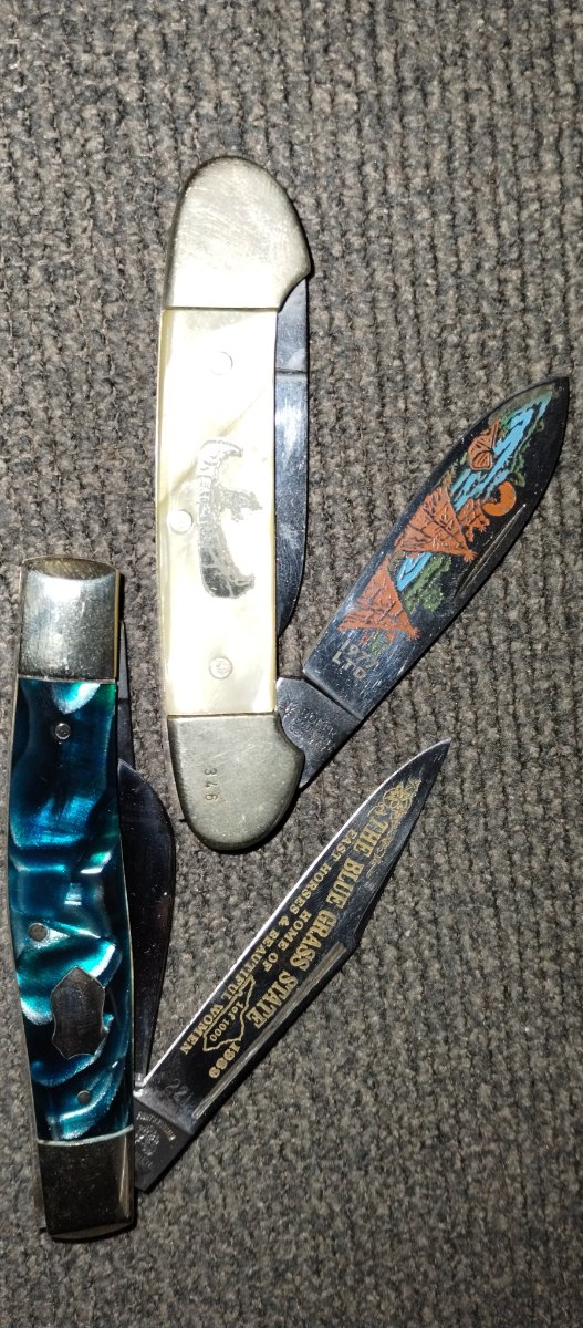

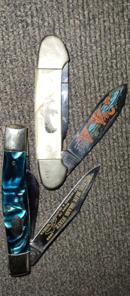

Are these 2 knives celluloid as well because of they are I will separate them from my other knives too.
Mumbleypeg
Posts: 15704
Location: Republic of Texas
Post by Mumbleypeg »
They look like celluloid to me. If in doubt, take them out. Why risk it?
Posts: 21499
methadoneman wrote: Sat May 25, 2024 5:20 pm Are these 2 knives celluloid as well because of they are I will separate them from my other knives too.
I think the Canoe is MOTS, Mother of Toilet Seat, and it should be fine. I have one just like it. ::tu:: Outgassing on Fight'N Roosters and Bulldogs, to name 2, can be bad. Both are from the Obertz Factory in Germany. Bluegrass Winchesters are bad too. 😉
