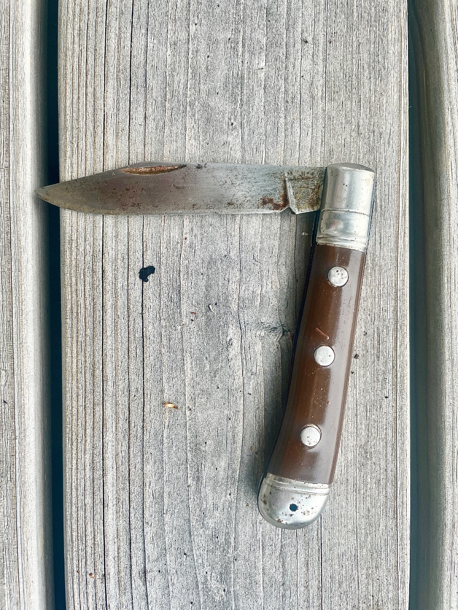

Hey, I just found this beauty and I’m Finn so Idon’t know anything about these knives. ::shrug:: After quick first glance I can tell it’s well machined together and nothing is loose, it’s just a bit rusty. I found it between some wooden planks at firewood storage at summer house built by my grandfather like in the 70’s. It was in spot that will stay dry throughout the year although I did sand off some rust from the blade before taking the picture.
Anyway… what year is my newest partner from, about? Is there something I should know about or take into consideration while I repair it?
::woot:: Just, tell me everything! Okay?

Welcome to AAPK. Your picture of close up on markings didn’t post. I can’t help with an estimate of age, but recommend you try to avoid cleaning it using harsh abrasives that remove metal. You may have to resort to that but first try less abrasive methods. Some good recommendations can be found here viewtopic.php?f=37&t=54157

Greetings friend.
You do indeed have a shell handled single blade jack knife made by Richard's of Sheffield England, formerly Richartz from Germany. They made a few similar models, as far as I can tell anecdotally. It's called a shell handle because the handle scales are hollow, stamped out of mild steel usually in one piece per side, and attached to the knife at the ends with small metal tabs. These are almost always covered with thin celluloid plastic film covers. This is most oftem seen in imitiation mother of pearl, but also brown as with yours, and also a black jigged plastic of some sort that's slightly thicker.
I'd peg their dates of production late 50's to late 60's.
Richard's moved to England just before WW2. After the war they caught alot of flak from other Sheffield cutlers who were renowned for world class cutlery; shell handled knives were considered low quality. Their shift to a more economically friendly knife was exactly what the average working man in a rebuilding war torn country needed though and Richard's flourished.

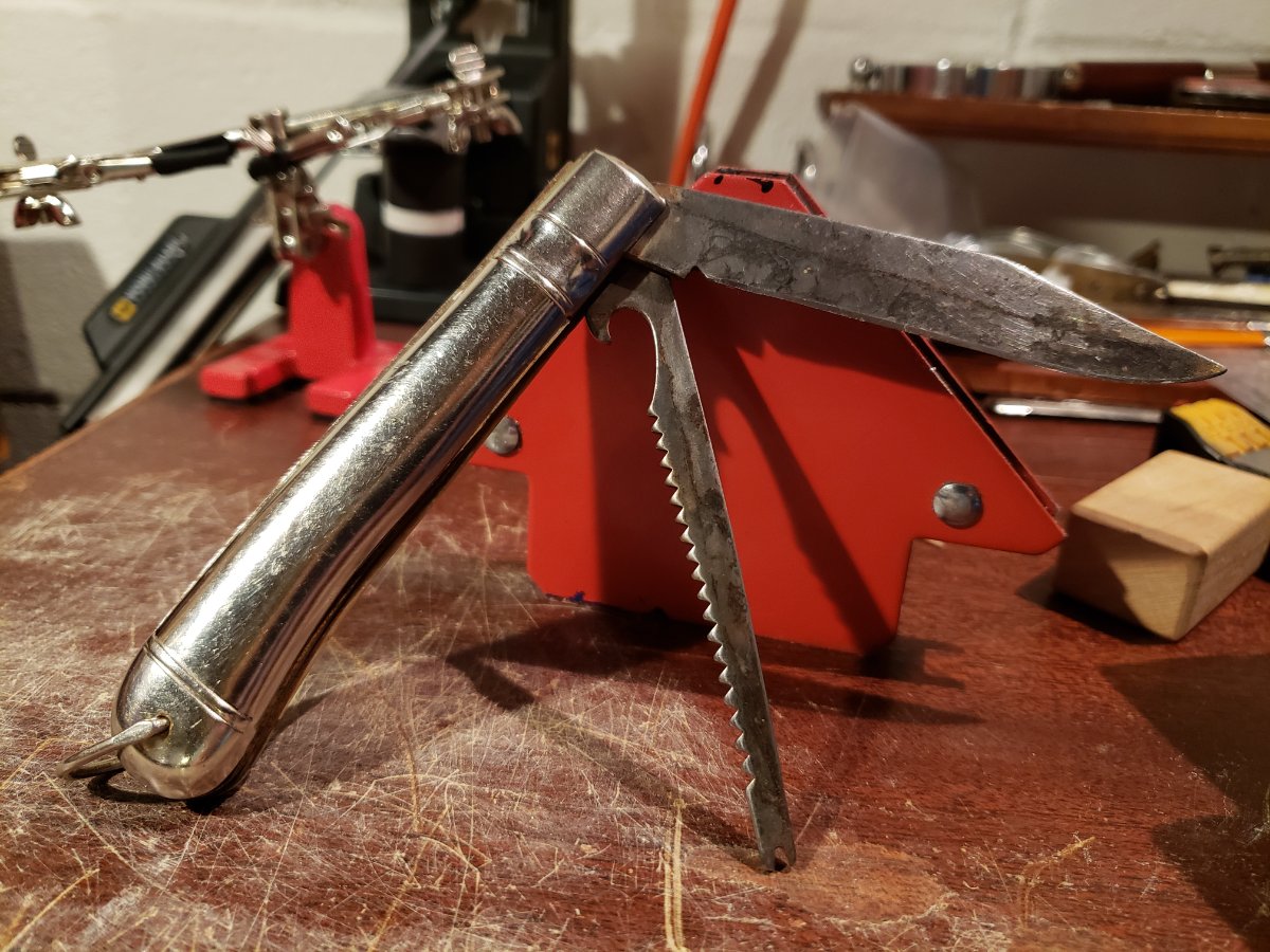

They pumped out tons of these knives, but many were used up and tossed, as was intended. Here's a few of mine for comparison.
1. Just like yours, but with the bail
2. Both sides of a similar style, with and without mop celluloid and with additional fish scaler tool
3. This one had mop celluloid but i took it off and replaced it with blue and clear vinyl, polished the bejeezus out if it, knocked the edge off, and gave to my 5 year old son.
4. Black variety

Thanks a lot everyone. The dark brown on handle is that bakelite stuff, first plastic like materials. I have been restoring the knife by chemically removing rust and gently sanded the blade with p240 paper.
That blade has low carbon but it’s so slim it can become sharp enough to cut paper with it’s own weight, so it will be practical knife in wilderness where I spend most of my time these days. Kind of… love it.

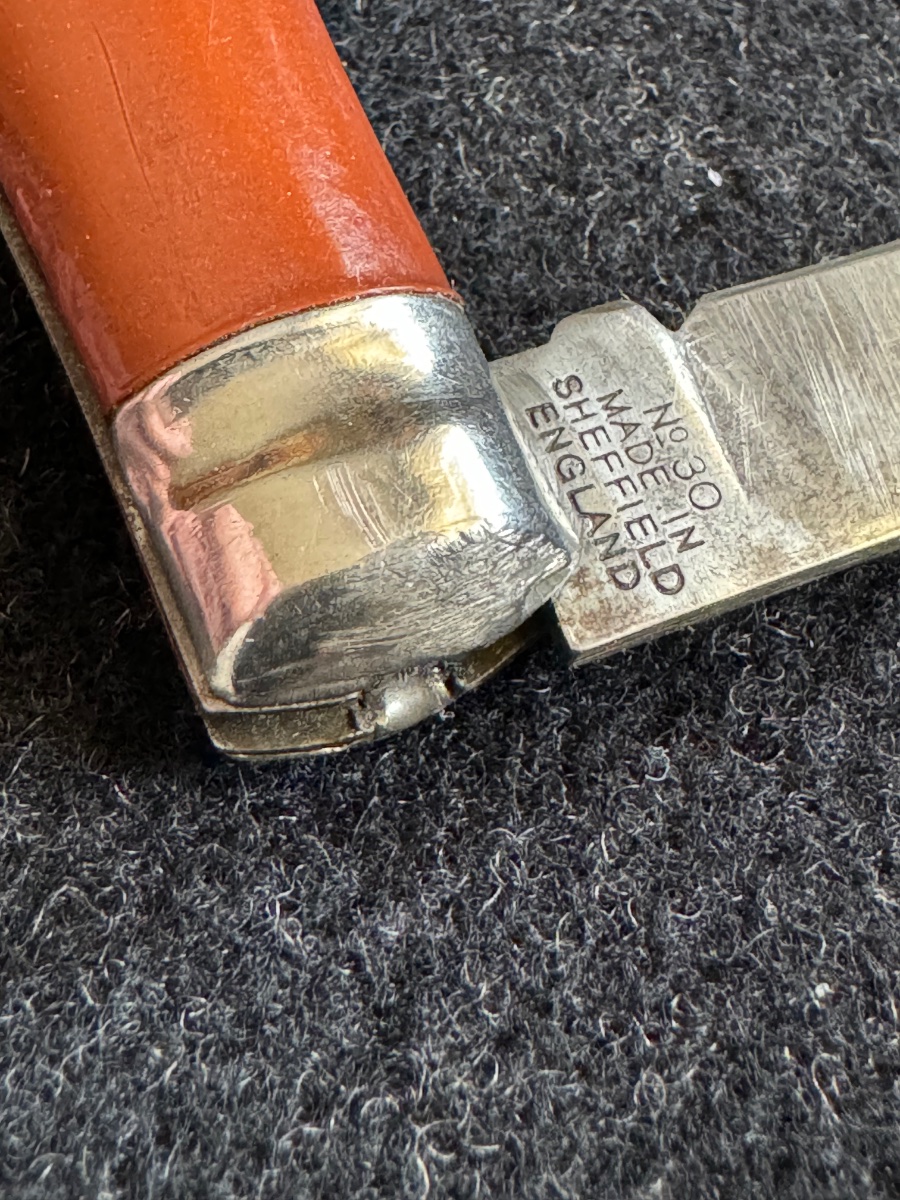

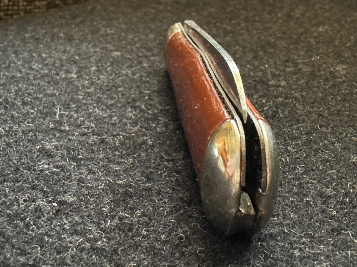

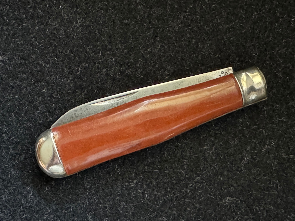

I have one kinda similarish from Sheffield.

Welcome to AAPK. Had to cringe when I read 240 sandpaper. If you're interested in learning, NEVER put 240 sandpaper to your blades. Ruins finish, patina, and removes way too much metal. Big no no. Try toothpaste on a plastic bristle brush, or rust erasers, or a pencil eraser, or naval jelly. Don't destroy the finish or the flats with deep destructive scraches. Stay away from steel wool, wire wheels, and steel wire brushes. There are whole threads here about how to restore, clean, de-rust your blade or knife without rough sand paper. It destroys far more than it cleans. Do the knife a favor and preserve the metal, don't sand it away. IMHO, YRMV.
