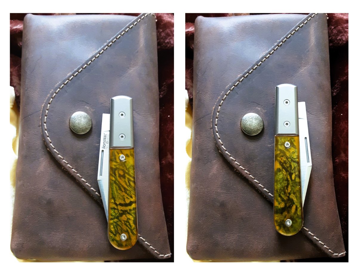

- drcvaught
- Posts: 17
- Joined: Wed Dec 16, 2020 7:15 pm
- Location: Pittsburgh
Re: LionSteel torx screws
My "proof of concept". These are fairly crude, being constructed of things I found lying around, but an interesting way to while away a rainy afternoon. And in Pittsburgh we have a lot of those.
