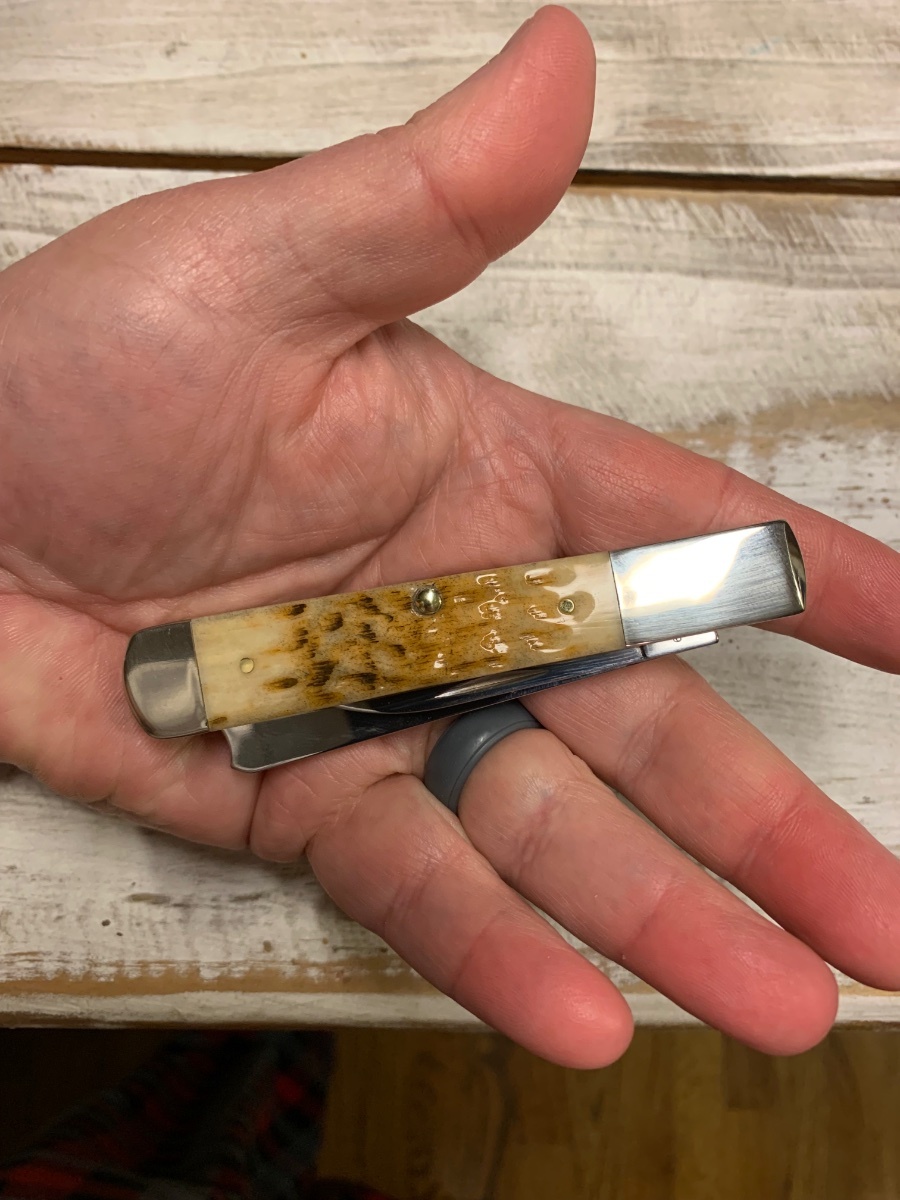

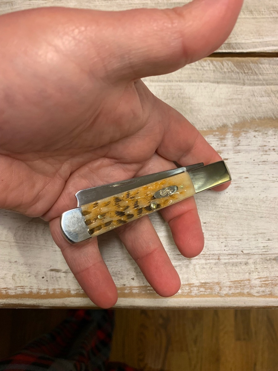

Received my 2024 Case Razor knife today. I ended up getting the peachseed amber bone model and very please with the looks of it.
Has anyone else bought one yet? I'm trying to decide if I should carry or just put up for collector value. What do you guys think is value really dropped once you carry?

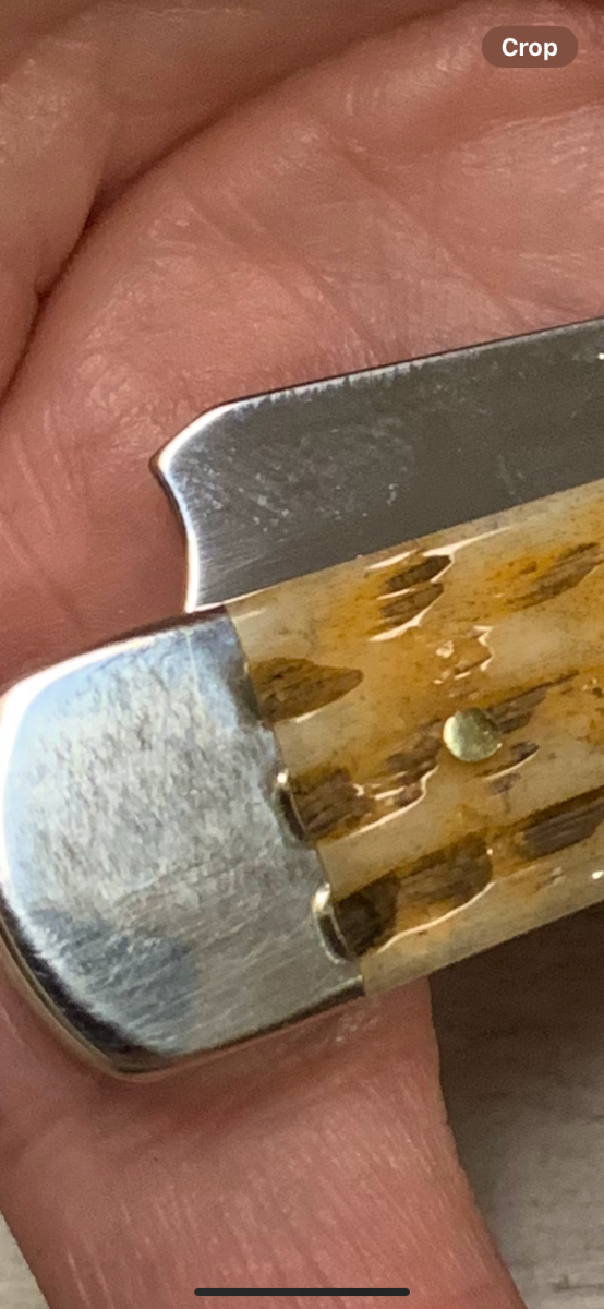

After looking at knife it seems the jigging goes to bolster and does not have the same look as all the amber bones I have seen in past
I asked Case about it as usually the jigging does not go to bolster..

Just added photos. Let me know what you think about the bone as this does not look like picture on website I ordered.Wudidiz wrote: ↑Tue Mar 26, 2024 10:20 amWhere's the photo?Meigscl wrote: ↑Mon Mar 25, 2024 10:28 pm Received my 2024 Case Razor knife today. I ended up getting the peachseed amber bone model and very please with the looks of it.

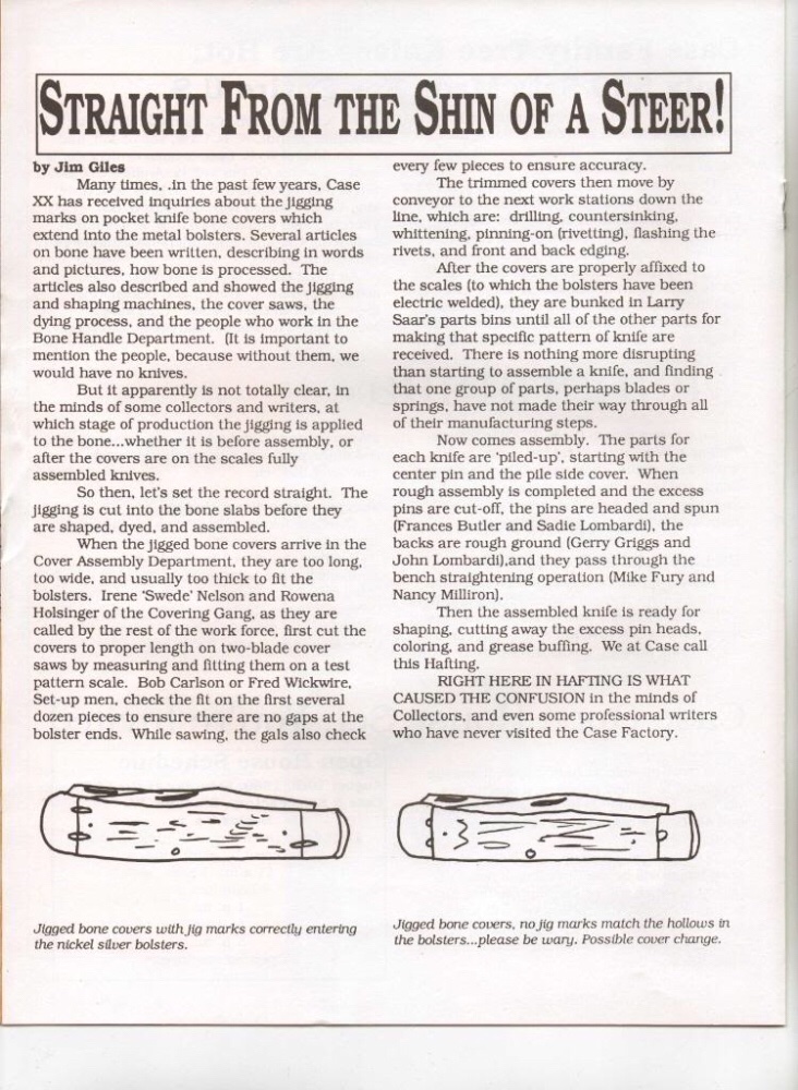

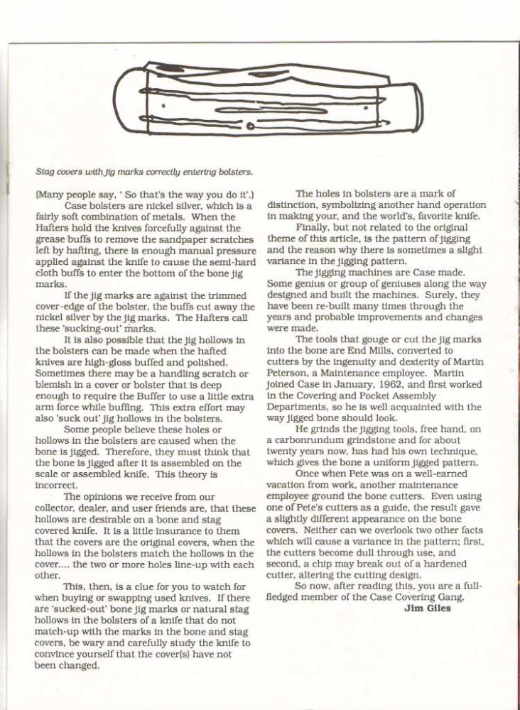

Nothing wrong with that at all. In fact that’s how many knives look, especially iconic older pocket knives.
Case matches the covers to the adjacent bolsters’ thickness. That usually requires the removal of some handle material through a process which cutlers call “hafting”. (Which is basically sanding.). How much material is removed to make the cover-to-bolster interface smooth is a function of the thickness of the handle cover slab. If it’s thicker, more hafting is required, which removes the outer layer of the cover.
Bolsters (in most cases) are made of nickel silver, which is softer than bone or stag. During hafting some of the bolster is typically removed along with the cover material - bone in this case. Which may leave some indentations in the bolster at places where there are corresponding indentations in the cover material. At Case the hafter operators call this “sucking out” of the bolsters by the hafting machine. Below is an article from the Case Collector’s Club newsletter which explains it better than I can. Click on it to enlarge for easier reading.
If you don’t like it you can send it to me. I think it’s great!

Great article, lots of good info there.

I like it. The jigged bolsters at least lets anyone know that the bolsters are original. Haha

Maybe so, in a way. But the bolsters are not jigged - that is the whole point of the article!
Another note - throughout the article the author repeatedly refers to “covers”.
“Covers” are the bone, MOP, stag, wood, etc that are often mistakenly referred to as “scales”.After the covers are properly affixed to the scales (to which the bolsters have been electric welded)
