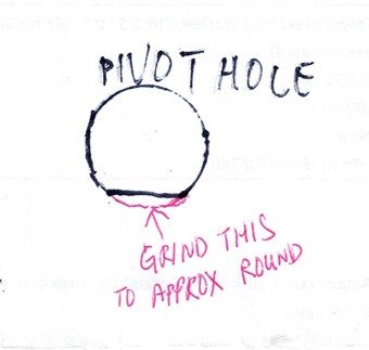

OK, I am CRAZY and have OCD. Please bare with me.
I have a few of the same knives that I really like and it's cheap like dirt($13 each). Everything about the knife is very robust EXCEPT it uses a pivot pin that is only 0.2" diameter. I want to change to 0.25" diameter pivot pin. I already ordered the 0.25" diameter pin that is a little longer. I can just grind to the right length for the thickness of the knife.
My question is about drilling the holes larger. The difficult part is on one of the liner, the hole is keyed, that is one side of the pin is slightly flatten that match the hole. This is to keep the pin from rotating during tightening. I have to drill that out.
I don't think it's good to just drill it as it might push the new hole a little away from the "keyed" side. My thinking is just use a diamond grinder bit on the Drammel and just grid the "key" to make the hole as round as possible as shown, then drill with the bigger bit. If anyone has better idea, I am all ears.
Thanks
Thanks

I would try to dremel it out as much as possible. Like you, I think the bit will walk on that flat.

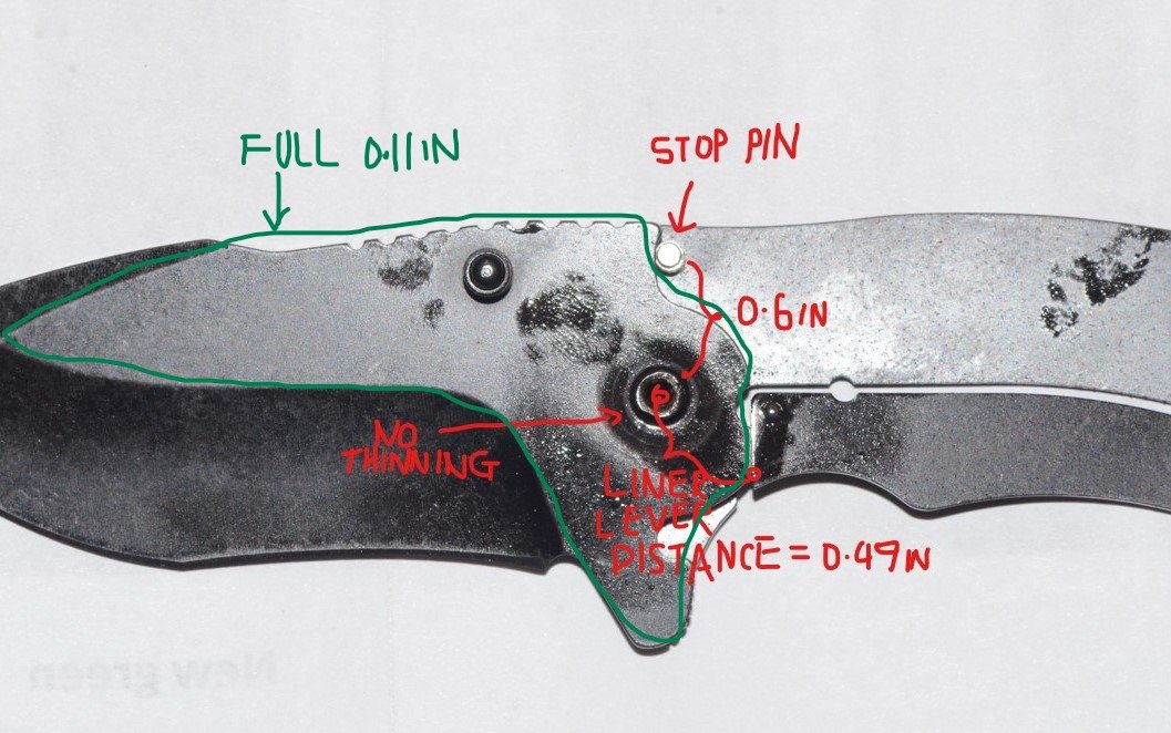

You'll weaken the liner.

I have another idea, I took a look, I can stack the two liners together, align the two by the stop pin(close to the pivot hole) with liner with flat key hole at the BOTTOM. Then use screws to fix them onto a piece of wood. With the stop pin, it should be easy to align the rest of the holes of the two liners and fix it good onto the piece of wood. Of cause I will try to use the drammel to grind out the flat key to as round as possible as described before. Then just drill down after stacking and fixed on the piece of wood, the round hole of the top liner will serve as guide as I drill down to the bottom liner when reaching the flat key at the bottom. Even if it walk ever so slightly, both holes should be well aligned when drilling like this. I literally using one liner to serve as a guide to drill out the flat key.

Attached is the picture of the internal of this cheap knife. It is designed very robust. Even though 0.2" pivot is plenty, but with this design, it's still can be a weak point.

A weak point for what? Batoning a steel pole? Before you go through all that trouble why don't you try to see if you can make the pin fail in one of those knives? I'd think some other part of the knife would fail before the pin which would negate making the pin more robust. Of course if you just want to do it to see if it can be done then by all means give it a whack, should work as long as your holes are lined up. For drill size see how much room they left in the holes for the existing pin and try to mimic that clearance with your drill size. The blade and liners might have different size holes.
