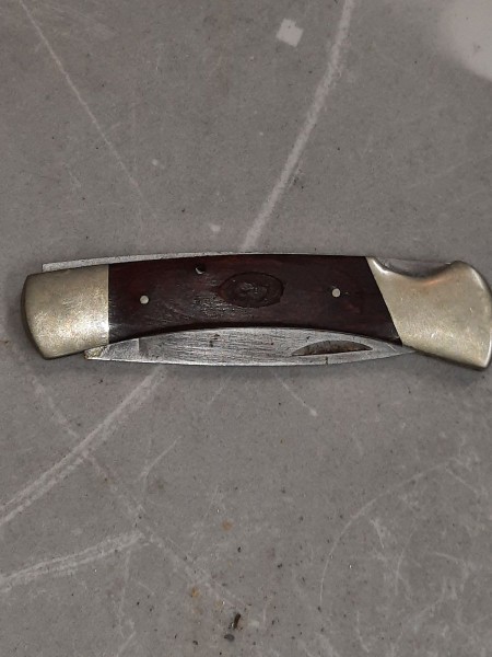

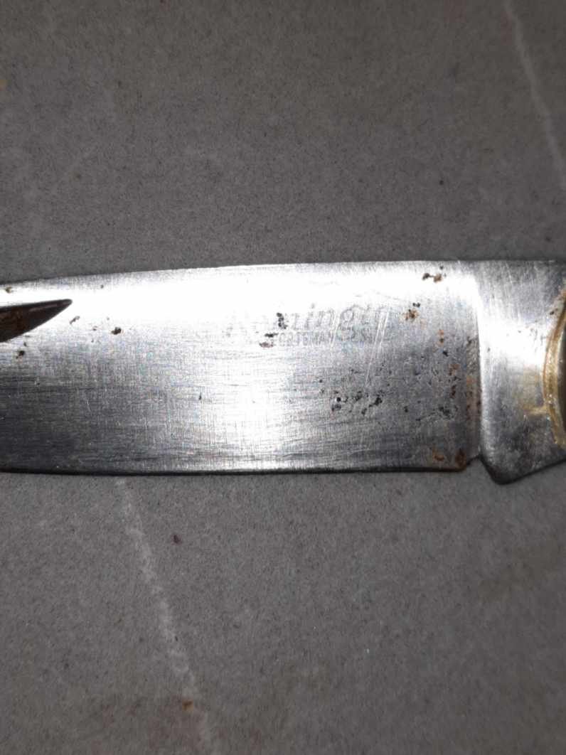

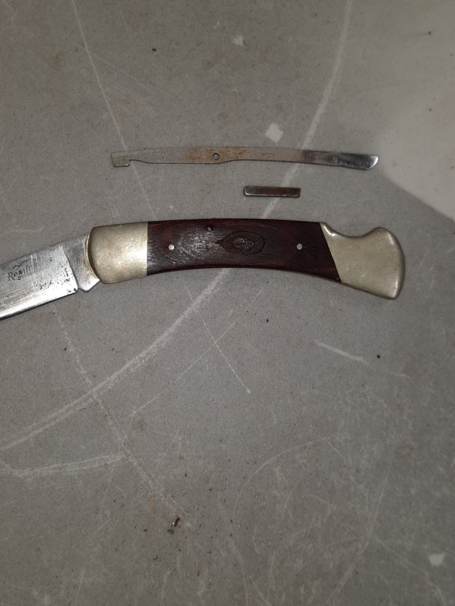

Hello,
I have a large chinese-made Remington 700 series lockback (looks like a Buck 110) that I inherited from my cousin when he passed. The spring on the knife is broken so the knife will not lock open or stay closed. I was able to remove the pin that the lock bar pivots on and shake out the broken piece of spring metal, however, I can't seem to locate the pin(s) that hold the two slabs together so I can remove the rest of the lock spring. Can anyone out there help with how I would locate the pins so I can completely disassemble the knife. I would also appreciate any advice on how to make and fit a new spring. Any help will be appreciated. I have attached some pictures so you can see my dilemma.

Can you get a clear closeup picture looking down at the knife from the top, with the blade open? Also one of each end? Want to see the liners.
