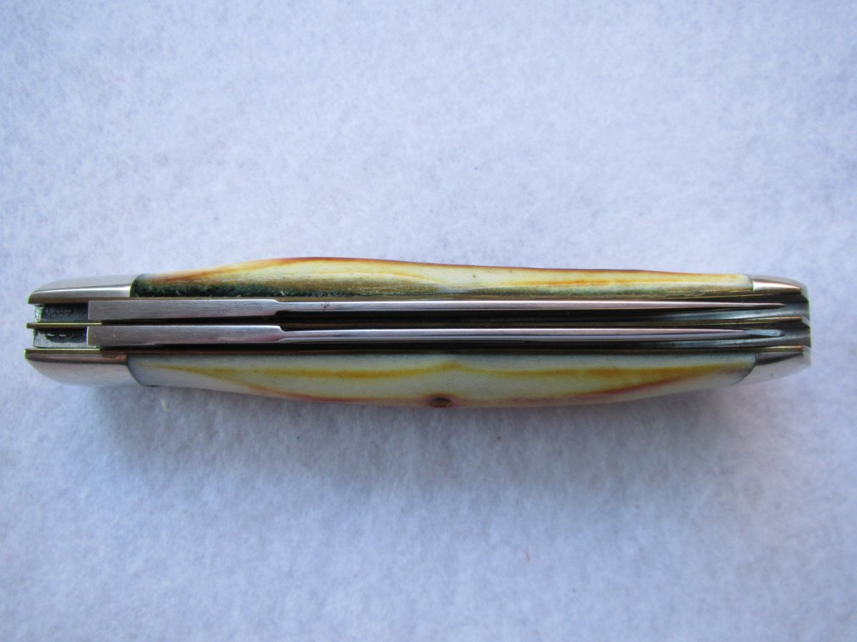

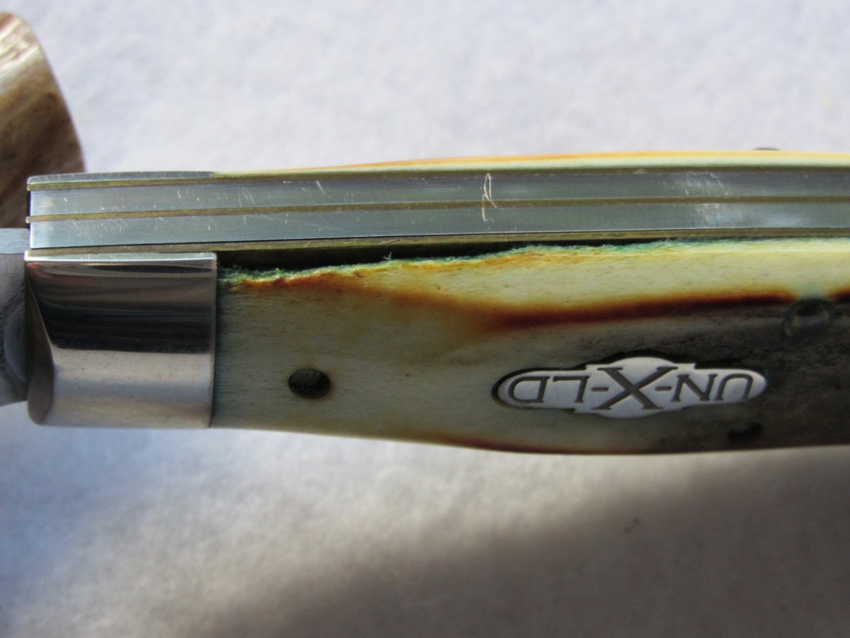

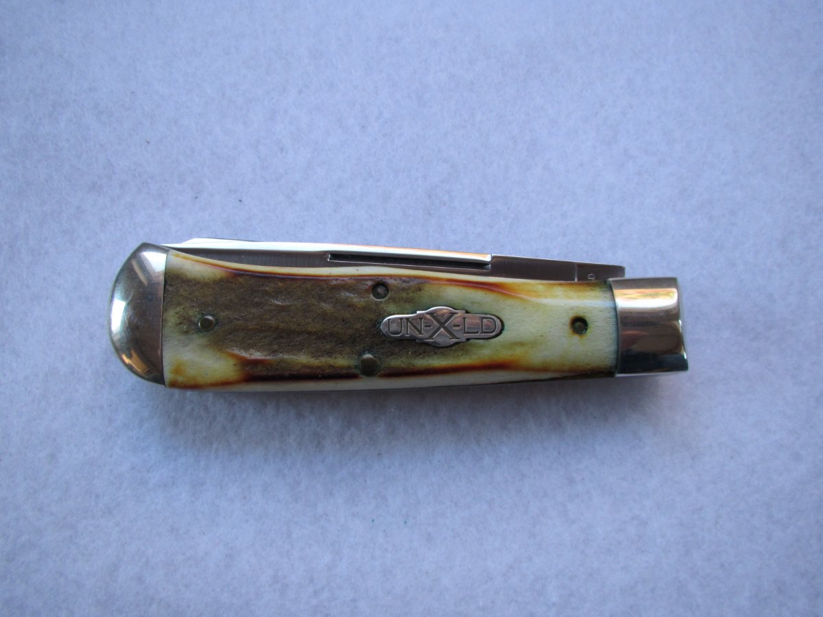

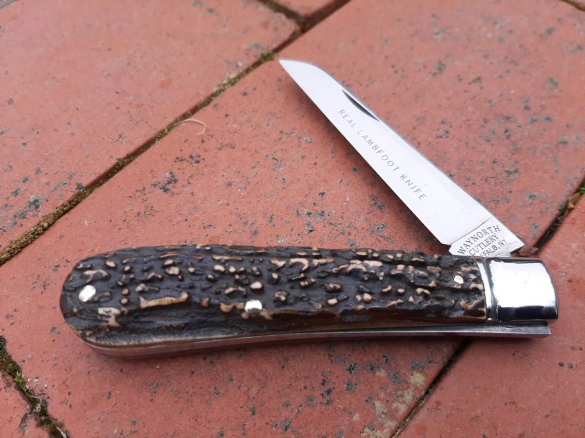

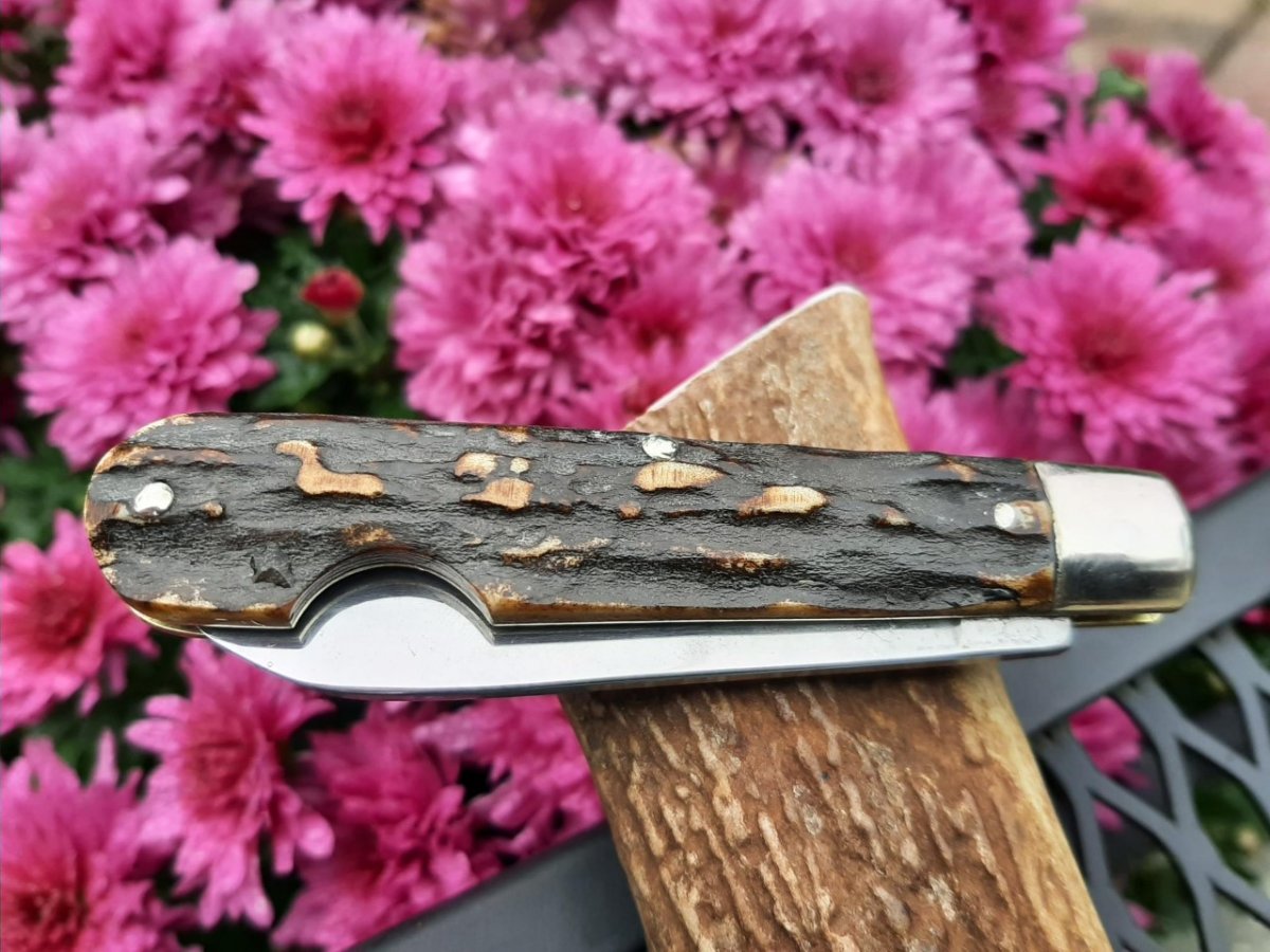

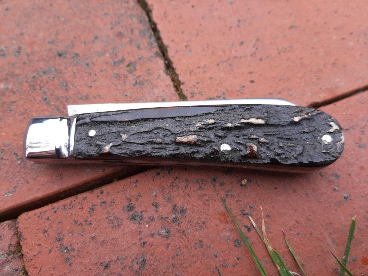

While helping a friend sort through knives we came across this GEC. I've never seen anything like this, knife has been in tube and stored in a constant temperature. What was left of the stag in that area was crumbly and dry. Could there have been a reaction between stag and brass or was the stag not dried out.
Would like to hear opinions on this one, got me stumped.
Edit: Knife was made in 2009

That is a mystery Bob. I have seen knives with stag that was just a little too short for the liners on the sides peeking out uncovered, or one with a natural indentation that exposed liner but never seen any with dried and crumbling stag. It looks like a lot of verdigris in that area. Oh how I wish the knife world would stop using brass anything on knives. Brass takes a toll. I’ve seen a lot of Queen gunstock jacks from the 80’s and 70’s with green all around the pins and liners leaching into the stag. Wouldn’t surprise me if this is related to the brass liners some how.

Just from the pics it appears that maybe that dark area got worked too close to the "spongy" layer of the stag and the last part of the hard outer layer just let go. I see hunting knives where the spongy layer is stabilized with maybe an epoxy-like compound to keep that from happening. Like to see a pic of the entire scales on both sides. Also hope you post what the outcome is. Good luck. J.O'.

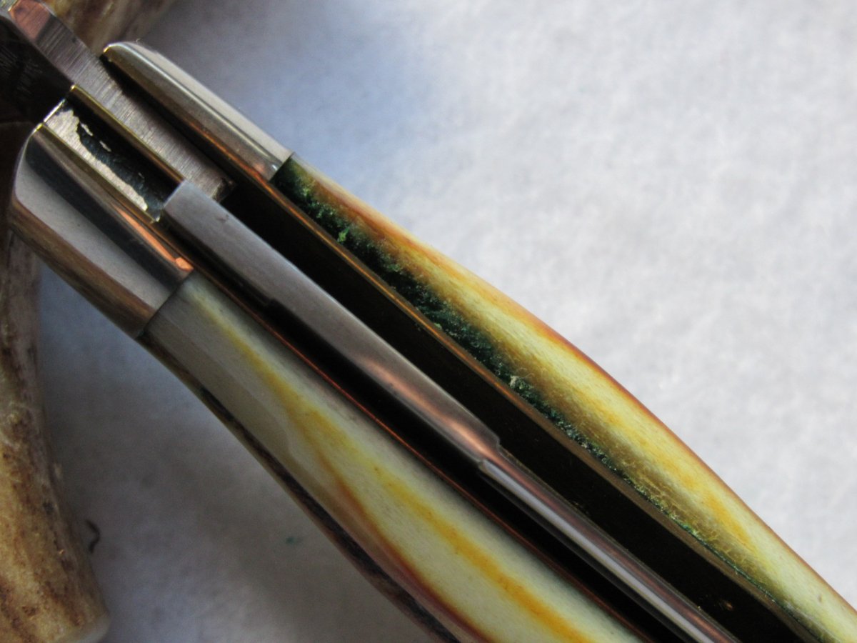

I have plenty of stag handled knives that are 90-100+ years old with brass or nickel silver (white brass) liners with no problems from the brass or stag. I have seen that knives that get oiled too often or much are subject to the green around pins and liners.Sharpnshinyknives wrote: ↑Mon Oct 30, 2023 7:00 pm That is a mystery Bob. I have seen knives with stag that was just a little too short for the liners on the sides peeking out uncovered, or one with a natural indentation that exposed liner but never seen any with dried and crumbling stag. It looks like a lot of verdigris in that area. Oh how I wish the knife world would stop using brass anything on knives. Brass takes a toll. I’ve seen a lot of Queen gunstock jacks from the 80’s and 70’s with green all around the pins and liners leaching into the stag. Wouldn’t surprise me if this is related to the brass liners some how.

Looks like some of the pyth was exposed and crumbled apart. Don't usually see it dissolve like that. Maybe oil? I never put oil on stag, worst thing for it. It soaks right in and softens it up, then stays there. Even worse if there are detergents or other foreign matter in the oil.

Thank's for the replys, its just in one area but may be spreading along the handle on one side. May have been some pith left on that one. Ren wax is the only thing I'll use, no mineral oil. Will talk to GEC and see if they can fix it.

Thanks Bob. I wanted to see those pics to see how far down they worked the stag. It's my opinion if they use material from further out in the rack the pith, (spongy layer) may be to close, especially if the antler was quarter slabbed already. I'm getting ready to re-handle some pieces in stag and I want to avoid wasting material. I'm a rank rookie.

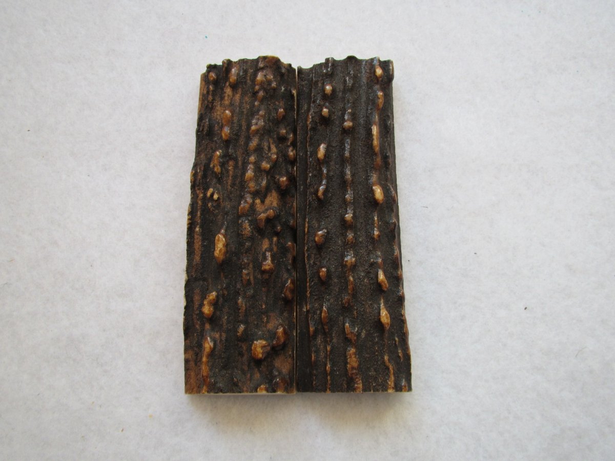

Herb I like your idea, thats something I could handle, I do have a nice pair of stag scales that would look super on this knife.
I lack the skills to do it but there are some craftsman that can, so we will see. I'll post pics when fixed.

Big bummer. I have sent a couple knives back to GEC and they fixed them for free. Didn't have this kind of stag problem, but I would think they would offer to rehandle it for you at least. I'm surprised at that but the bigger they get, the harder it will be to take care of everything on every knife I guess. Sorry to hear about that. And although I don't know what your take on keeping "original stag" is or isn't, not my business, just a thought here, but what came to mind immediately given the problem with this stag and the comment from Glennbad is that I would say try to get him or one of the other fine knife mechanics on here to throw you some new stag covers on that baby and then you'll have the best of both worlds. He did these for me and it's better work and better antlers than any factory stuff I see from any maker. The top pic and the one below are of a knife GEC made for Waynorth Cutlery. Came with Ebony wood covers and while they were fine, they were not super fine like these antlers that Glen put on them are IMHO. I highly recommend. 2 cents, YRMV.
- WelderBob
- Posts: 1110
- Joined: Sat Aug 25, 2007 12:49 am
- Location: missouri ozarks
Re: Stag Problem
Ivoryman those are some pretty handles, very nice work. I've kept this pair for years looking for a home...believe I found one !
