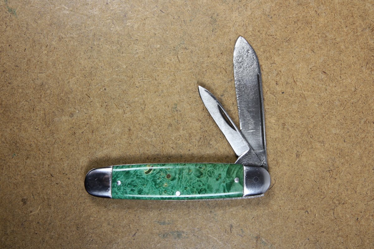

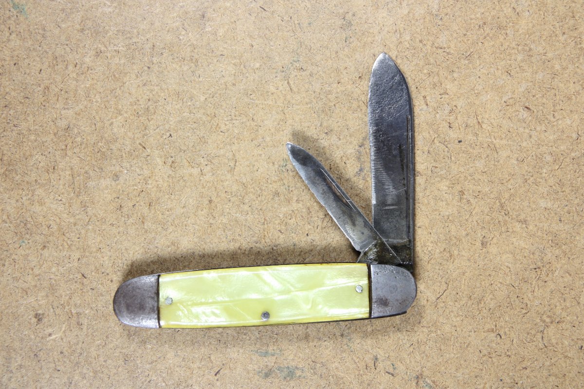

How do you folks sand the blades profiles without obliterating the grind lines ?
