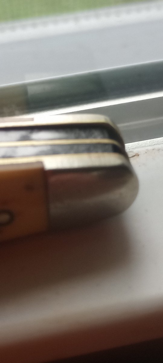

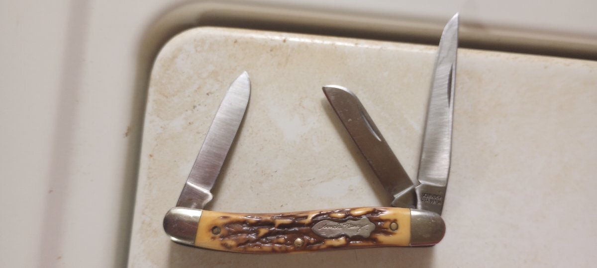

A life long friend of mine recently passed away from cancer , i knew he had a Uncle Henry stockman , his wife let me have it , blades are still in good shape , but has seen some neglect over the years , i brought the snap back with some good oiling , the problems are the back spring for the clip blade is sunk in some , and i guess thats causeing the blade to close so deep i cant get my thumb nail on the nail nick , but i have been able to open it , who would be good at this ? I guess they have the Swinden key thing i have read about , but seen a video where someone drilled them out and pinned like other knifes if need be , i am, guessing it would need a new spring , so anyway , just looking for some good suggestions on some one here that would do it , Thanks
( ill try to post some pics )

That’s usually caused by a badly worn blade tang along with some wear on the back spring contact area.

Yeah i was afraid it could be the tang was wore , i think it was never oiled . Years ago i had a guy weld up the tang some on a old XX case .

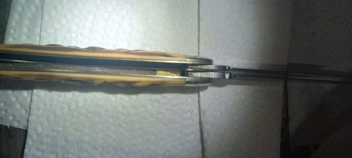

You can try the old trick of putting a piece of leather shoelace down in the well and see if that raises it enough

Try cutting a piece of card stock and place it in the blade well under the 'kick' of the blade.
It may raise the blade up enough to access the nail nick. It may also raise the blade tip above the liner causing 'peek'
so be careful . . . and keep it well lubricated to prevent more damage to the spring and tang.

Kind of an unusual problem. Normally if a blade tang or back spring is worn the blade will not sit low like this but rather will sit high and there will be no blade snap. I've teen this problem of sitting low fixed by putting a piece of wooden matchstick in the well. The wood can be placed between liners tight enough so that it will stay put. It might take some trial and error to get it right but the wood can always be pried out with a nail or similar object if your attempts don't work at first.

A friend at work put in a piece of brass shim stock , sitting a hair high but it doesn't poke my finger , I might go in with a small file and rub the brass a little and take it down , thanks for this suggestion , I appreciate it
