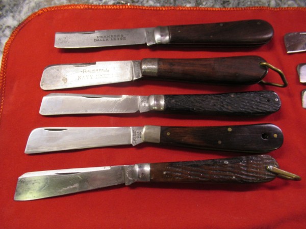

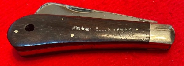

The hawkbill frame/sheep foot combo was popular among a number of the older cutleries. Many of those knives were also called rope knives or navy knives and many were contracted to both the navy and the coast guard. I've no doubt that Steve is correct in his post. Here are a few other examples from different companies:

A few Rope Knives That I think all Companies made
