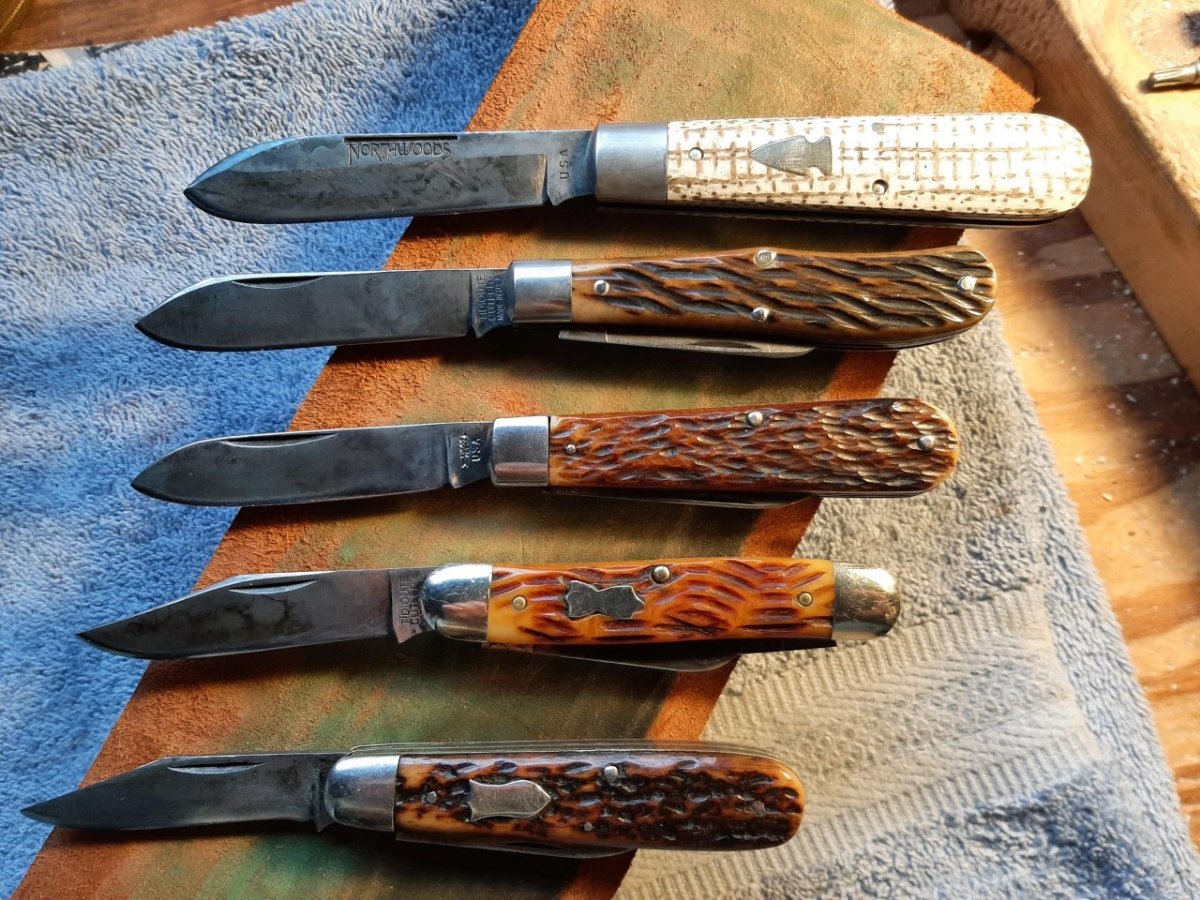

Sharpen less, strop more. With a strop I have brought back edges that I never thought would get back into shape again without a stone and lots of work. I was wrong to hit the stone before the strop most of the time. I strop all my knives a few times maybe once a week or whenever they come up in the rotation. Maybe once or twice a year they get a few swipes on the diamond block. Or if I need a completely new edge, or an edge when there is none. Then it's regular stropping for the most part, for months at a time. If you get the right edge on a knife, you can strop regularly and each time it comes back to where it shaves hair. Your results may vary. Here's a home made strop with some green compound that I use daily or weekly. I don't hit the stones for months at a time or more.

I am with you IM, stropping is about all I do to my knives unless I get one that has no edge, for a poorly sharpened edge. With my EDCs I just use a leather strap about 24 in long that I glued to a board about an inch wide and 3 in deep.
I have a piece of leather glued to each side and one side I use a course rouge called black magic, available from Jantz Supply. On the other side I use Flexcut Gold rouge. Mostly I use the Flexcut side as it's about all that is needed to bring an edge back to shaving sharp.
Flexcut Gold is the rouge sold by Flexcut for sharpening their wood carving tools. I have experimented with a lot of different sharpening compounds and I like Flexcut Gold the best.
