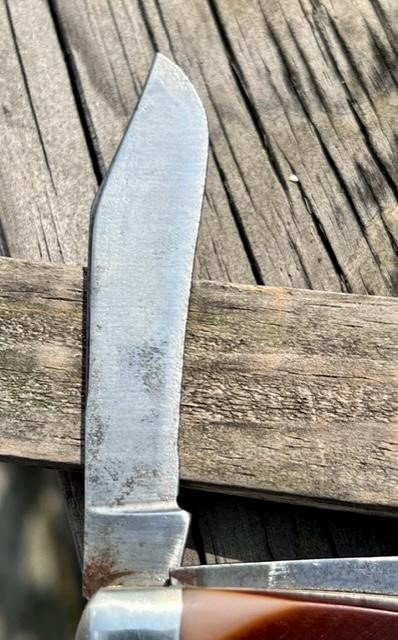

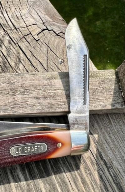

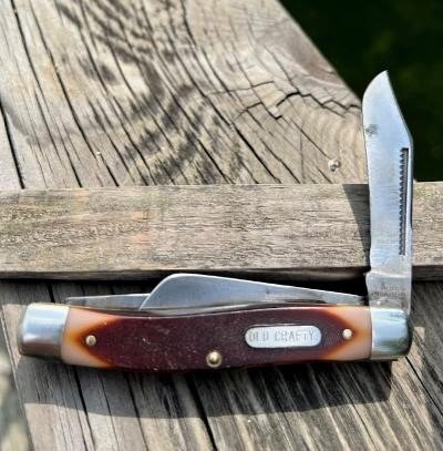

I bought this Old Crafty Stockman with a clip blade that looks like
someone took a bench grinder stone to in the middle of the blade.
I was thinking of fixing the blade up before I sharpen it.
Any suggestions on how to do this?

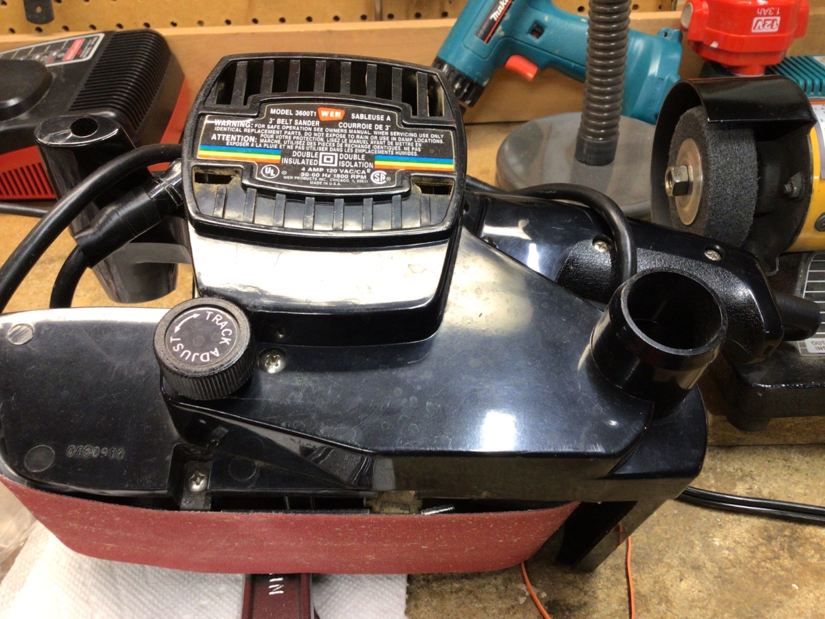

Would something like this work?[rugmar wrote: ↑Sun May 14, 2023 6:31 pm I’ll throw my 2 cent in the ring and say that I think it looks cool just like it is. If it was mine I’d sharpen it and use it as it is.
Now, none of that matters, cause it’s yours. So, have you considered a belt sander with a fine grit belt. I do all of my re-profile work on one and it works fantastic. Use a very light touch and be mindful which direction you touch the blade to the belt. You don’t want it digging in and closing up on any fingers! Ouch! Also, you can use a pencil and draw on the blade to get an idea how it will look and where to remove material to achieve. Easy to erase and draw a rev2 or rev3.
Rugmar
Rug
3 in belt sander
attachment=0]image.jpg[/attachment]
Bob
rugmar
- Posts: 281
- Joined: Sun Feb 03, 2019 9:45 pm
- Location: Central NC
Re: How re-profile blade tip
https://www.harborfreight.com/media/cat ... 7181_I.jpg
The one I use is more like this. The one you pictured could be made to work if you get creative and find a way to invert it and hold it steady.
- btrwtr
- Posts: 5484
Looks to me like the master blade tip has already been broken off, re-profiled and is now short. I'd sharpen it up and keep it as is.
Wayne
Wayne

Wayne and Jerry you have good eyes. I took measurements from a new knife from the web
and did a comparison to my real knife measurements. It indeed is shorter and had been re-profiled.
Bob

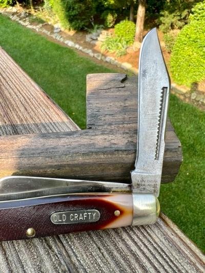

I spent about 2 hours on that one blade shaping and sharpening. After reading the comments I figured sincerugmar wrote: ↑Sun May 14, 2023 6:31 pm I’ll throw my 2 cent in the ring and say that I think it looks cool just like it is. If it was mine I’d sharpen it and use it as it is.
Good luck with it and be sure to show us your results. Be careful.
Rugmar
Rug
it had been broken off, I will just make it a little better, I used a file and some old stones to make it
better. The blade was extremely dull and hard to open. Here is what it looks like now.
I really enjoyed the 2 hours!
Bob
Good job. I think you made the right call in not going over board to try to “restore” it. Many times if you go to chasing pits or grinder marks, they just got worse or your blade gets too thin.
Hit the worst with some sandpaper or files, sharpen, and let the patina hide the rest.
Time well spent! It looks great now.
